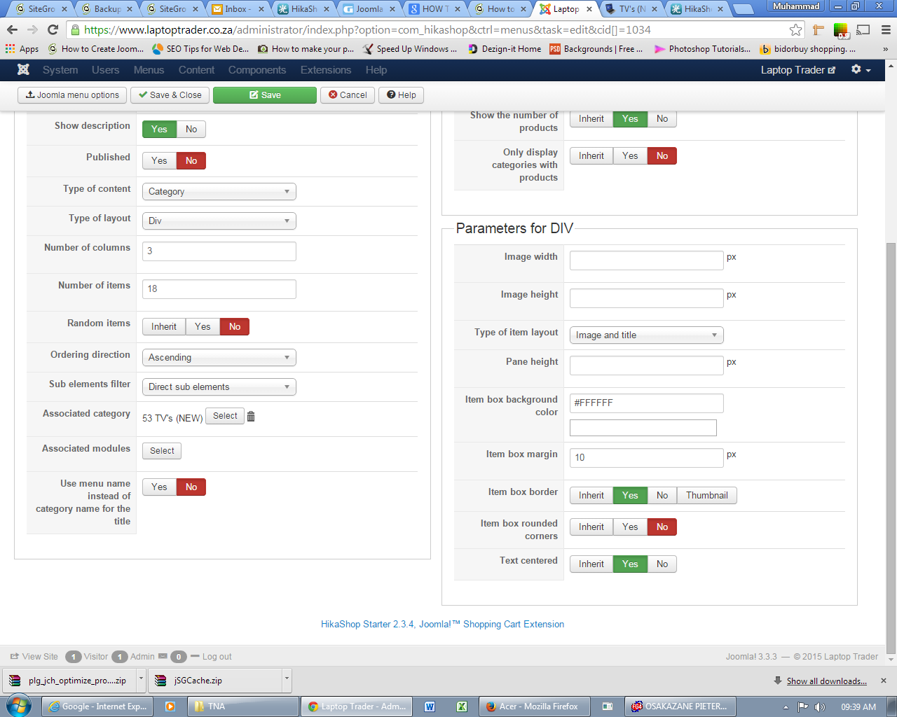

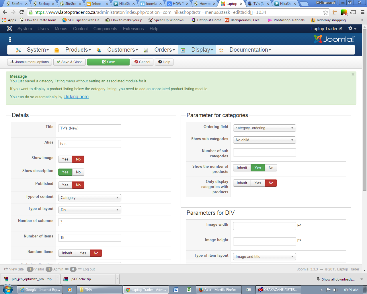

I don't know. It could be any setting in the menu.
Please provide a link to the page and a screenshot of all the options of the menu and then we should be able to tell you what's wrong.

  • Posts: 19
11 years 6 months ago #193790
  • Posts: 86112
  • Thank you received: 14210
11 years 6 months ago #193796
Don't you see the message at the top which says that you need to click on the link in order to get a product listing associated with your menu ?
Click on the link there and it should then work.
