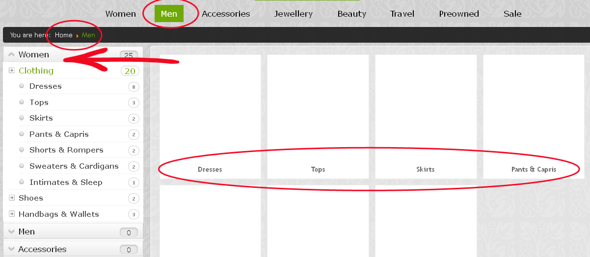

I am having problems with the menu.
1) If I choose "Type of Content = Product" all of the menus are showing the same products.
For example, the first page on the menu is "Womens", then I have "Men", "Accessories", "Jewellery", etc...
When I click on "Womens" it shows the correct content but when I click on any of the other categories they are all showing the "Womens" product, they are not showing the products in their categories.
2) Also, when I click on "MEN", then on "Clothing" it takes me to the Women's clothing category. Please see the attached.

1) As I indicated above if I choose "Type of Content = Product" all of the menus at the top (horizontal menu), are showing the same products.
2) And the menu on the left when I click on "MEN", then on "Clothing" it takes me to the Women's clothing category.
I sent you the link privately.

This one I see no change - it is still defaulting to the women's category as indicated above. It seems to only do this whenever the sub-categories have the same name. It does this to the "Clothing" and "Shoes" sub-categories when you click on them in the MEN's menu they default to the WOMEN's menu.
This is also odd because it worked fine on the old site so not sure what the issue could be. I spent approx a week trying to figure this out with the owner of the module as I thought it would the module that was causing the issue and have no luck so far :( .

2. Turn off the "remove categories and products ids from URLs" option of the HikaShop configuration, or enter different alias for the different categories and you won't have the problem.
