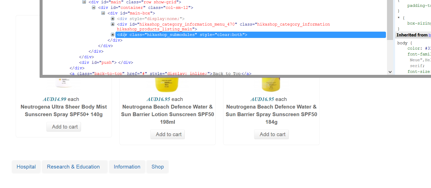

-- url of the page with the problem -- : www.scfa.edu.au/j3/about
-- Joomla version -- : 3.4
I have just succesfully imported Joomla 2.5 into a new Joomla 3.4 via php MyAdmin.
However at the foot of all the Hikashop pages appear buttons that relate to pages on the old site and I can not see how to control the buttons to remove them and thay are not on the the old site www.scfa.edu.au/shop
Any ideas where I might find the controler for this module?

I'm sorry but I don't understand of what you are talking about exactly.
But I see that you have a product listing module (with id 146) which is display in the "footer" part of your template.

That is exactly the problem. There is no module 146. It appears to be carried over from when I copied the original hike shop tables from the old website.
Any suggestions how I could defeat this please.

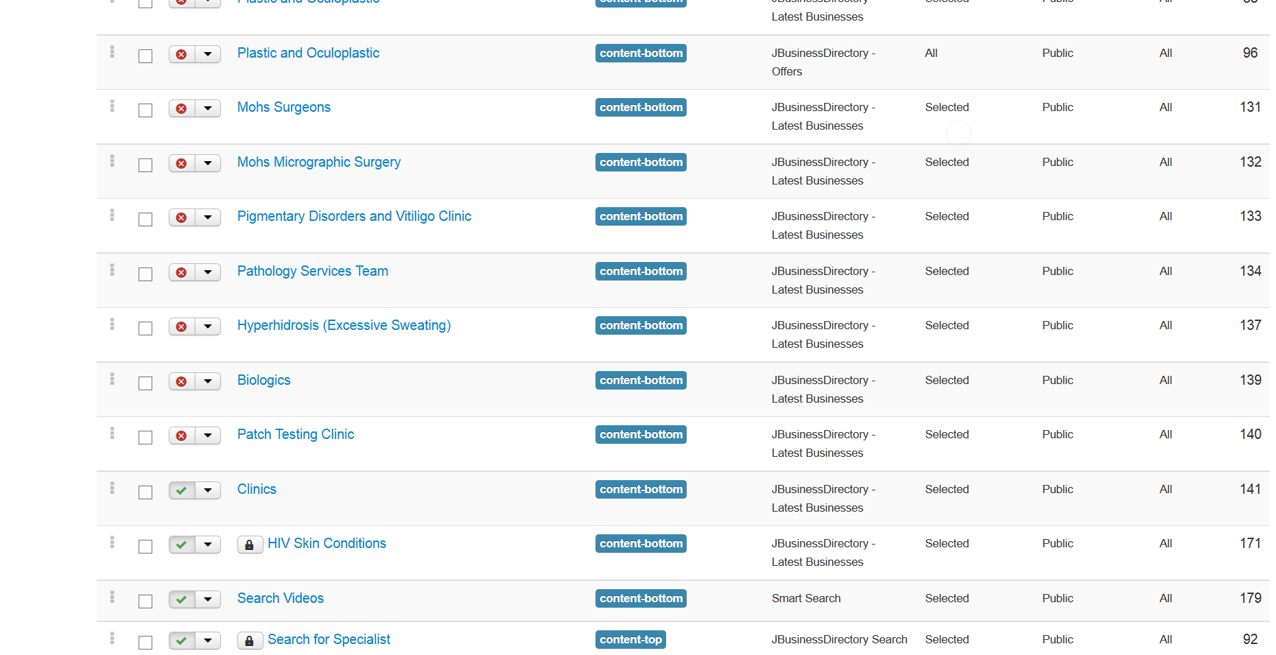

Even in Joomla module settings you don't see any entry with the id 146 ?
Please check that, and disable unwanted modules in the footer position.

11 years 5 months ago #195246
No where is there a footer or a module 147.there is a content bottom and I have disabled them all and still it appears.

11 years 5 months ago #195291
I don't really see how that's possible. The module should be found in the Joomla modules manager. Maybe the module was trashed. Did you look at the trashed modules of the Joomla modules manager ? Maybe it's there.
Also, you can look in the menu Display>Content modules of HikaShop. Maybe you'll find it there.

11 years 5 months ago #195458
Thanks for your patience. YES..... but it had a position of top with some test. CSS while I was making the template.
I can sleep again .... Thanks :)
