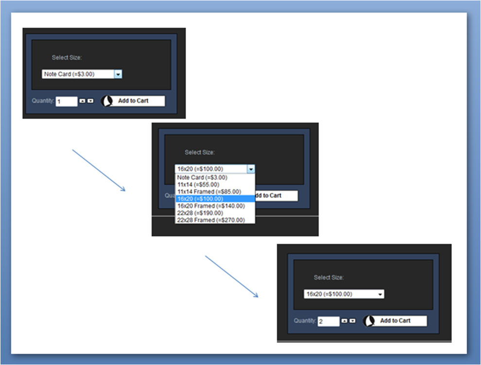

Thank you for your reply. There is some useful information in the "Display by Color" tutorial, but not really enough to help me get going in the right direction. To be more specific I want something similar in function to what my current website has.
Here is an example page from my current website:
image-circle.com/gal/wide?page=shop.prod...id=198&category_id=1
There is a dropdown menu with sizes and prices. You select the size and quantity then click the "Add to Cart" button.
