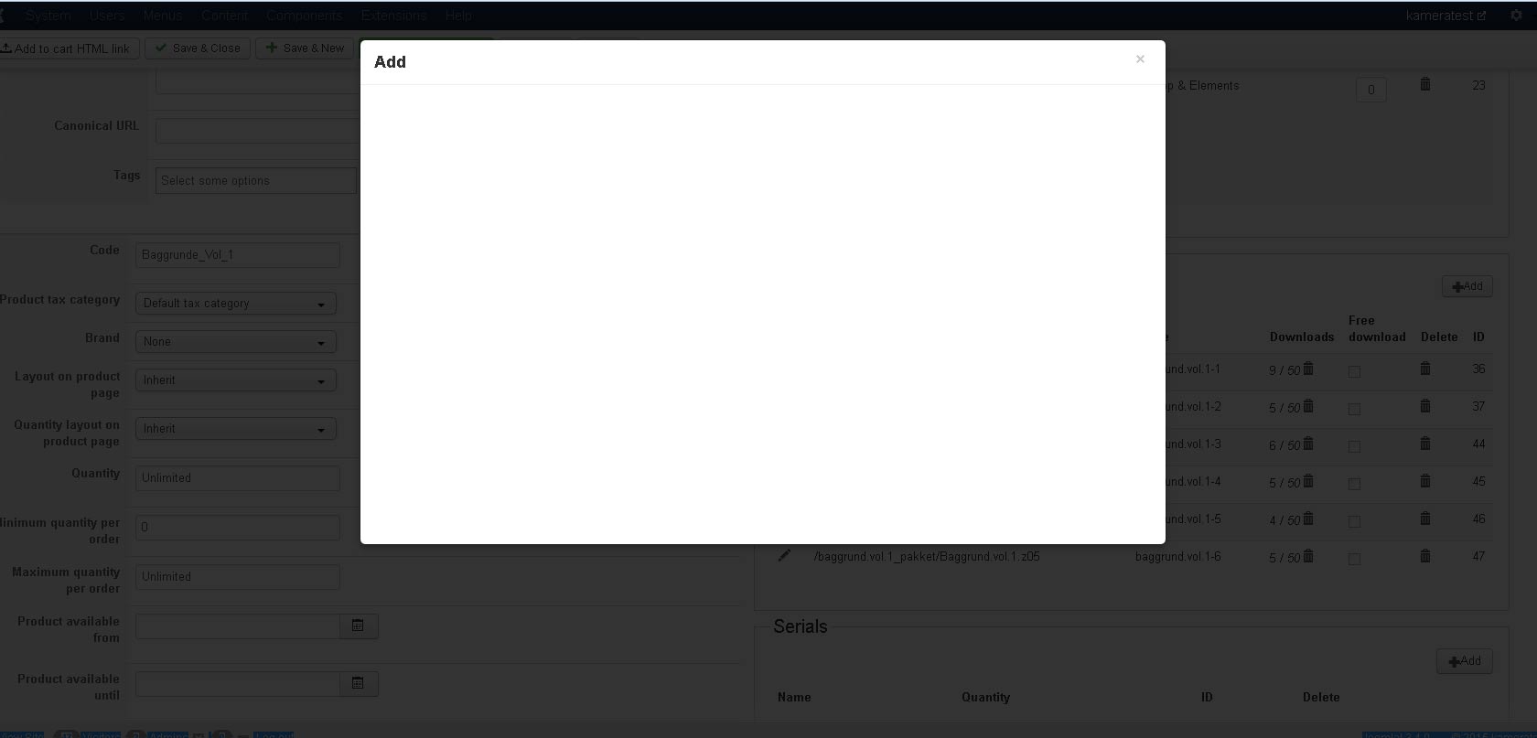

-- Joomla version -- : 3.4.0
trying to attach files for download. Clicking ok just gives a white window box, and nothing happens..
Please advise and help
regards
Bison

  • Posts: 78
11 years 5 months ago #195865
Hi Jerome
I click on "Add" to select a file for download
I select the file and press "OK"
When doing so the the popup just turns white and nothing happens.
Just as the picture above.

  • Posts: 78
11 years 5 months ago #196071
Hi Jerome
Details:
trying to attach a file, allready uploaded to directory
Clicking "add"
popup opens
Set file mode to "Specify file location"
setting file path
clicking ok
popup box turns white and nothing happens
Configuration:
Allowed files zip,doc,docx,pdf,xls,txt,gz,gzip,rar,jpg,gif,tar.gz,xlsx,pps,csv,bmp,epg,ico,odg,odp,ods,odt,png,ppt,swf,xcf,wmv,avi,mkv,mp3,ogg,flac,wma,fla,flv,mp4,wav,aac,mov,epub,gsd
Upload secure folder
media/com_hikashop/upload/safe/
have tried both with ZIP files and RAR files
Bison
