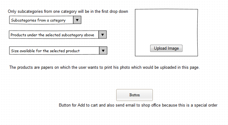

I need to have a page with the following format:
I need to have a dropdown in which all subacategories in one category are displayed.
I need to have another dropdown in which all products from the subcategories selected in first drop down will be visible.
And also I need a drop down in which different sizes for the selected product will be displayed.
What I also need is an image upload module which will be submited next to all data above to shop cart.
My client needs to have an online print module in the application.
Can you help me please ?

11 years 5 months ago #195953
I am sorry but I don't understand what your are trying to achieve.
Can you please use an image in order to illustrate your request ?
  • Posts: 20
11 years 5 months ago #196000
Hi and thnaks for your promptitude,
The image in the attachment describes more accurate what I'm trying to obtain.
--Flaviu

  • Posts: 86112
  • Thank you received: 14209
11 years 5 months ago #196055
As the screenshot you gave is quite particular, I guess that the best would start with your own page where you would display these elements (dropdowns, image, button) and when you submit the data, it would add the corresponding products and custom field data to the cart and redirect to the checkout.
For the dropdowns, you would run some MySQL queries on the hikashop_product, hikashop_category and hikashop_product_category tables in order to be able to select what you want in them.
And for the add to cart, here is a link with some code explaining how to do in your own code:
www.hikashop.com/forum/2-general-talk-ab...ct-fields.html#19870
The code would be on your own page on your website. It could be done with a blank component/module, or a form extension allowing custom PHP code in the form. So HikaShop updates won't affect it.
