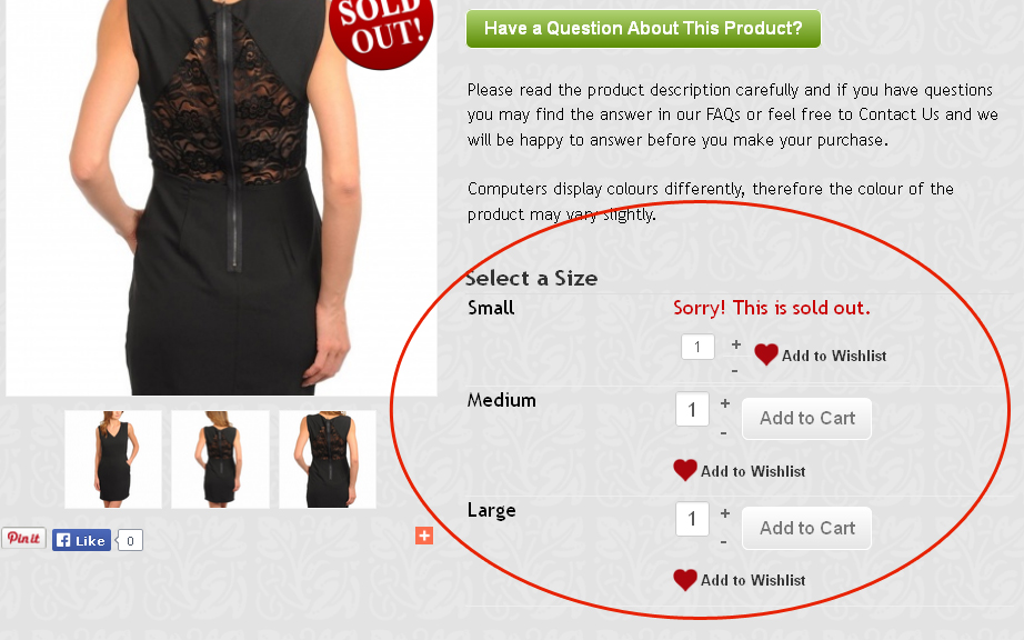

When an item is sold a message is displayed when the user clicks on the button to select a size. The issue is, when you first go to the item, if the first size listed, which is usually "small" is sold out, it makes it appear that that product is sold out. Please see pic #1.
To get around this I have to add another radio button with the quantity "1" and hide that button so that the message does not show when the user first get to that page.
I am thinking that there must be an easier way to do this or I'm hoping that you can help me find an easier way to do this so that I do not have to add that extra radio button to all the products just to get this to work properly.

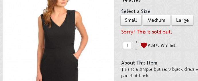

I would like that message to show ONLY when the user clicks on the button. Or better yet make the button disabled or have a "sold out" image overlay the button, as per pic #2, or do you have any suggestions?
Please see attached pics.

The solution you had used previously is still possible.
Alternatively, you can change the way the characteristics selection display in order to not have the issue.
If you select the choice "list" for the "characteristics display method" option of the HikaShop configuration, it will actually display a table of all the in stock variants and that way you don't have that problem anymore.

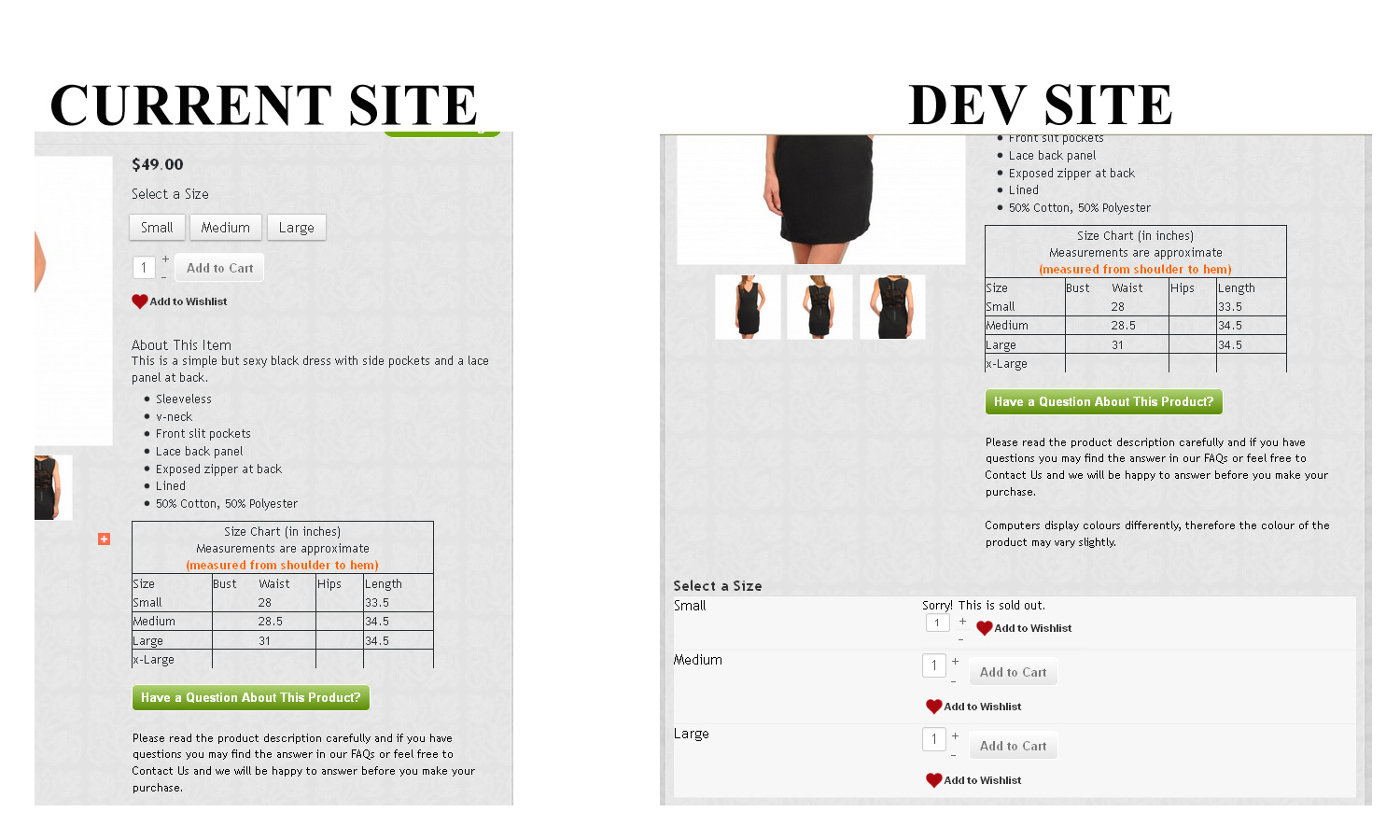

The variants are at the bottom of the product, how can I get it to go below the price, the way I have it now on the live site.
Please see attached pics. Thanks

You can remove the code:
if($this->params->get('characteristic_display') == 'list') {
	$this->setLayout('show_block_characteristic');
	echo $this->loadTemplate();
from the "show" file and move it to the "show_default" file of the view "product" before the code:
if($this->params->get('characteristic_display') != 'list') {
		<br />
	<?php
You also need to remove the line:
<form action="<?php echo hikashop_completeLink('product&task=updatecart'); ?>" method="post" name="hikashop_product_form" enctype="multipart/form-data">
and the line:
</form>
from the "show" view file.
