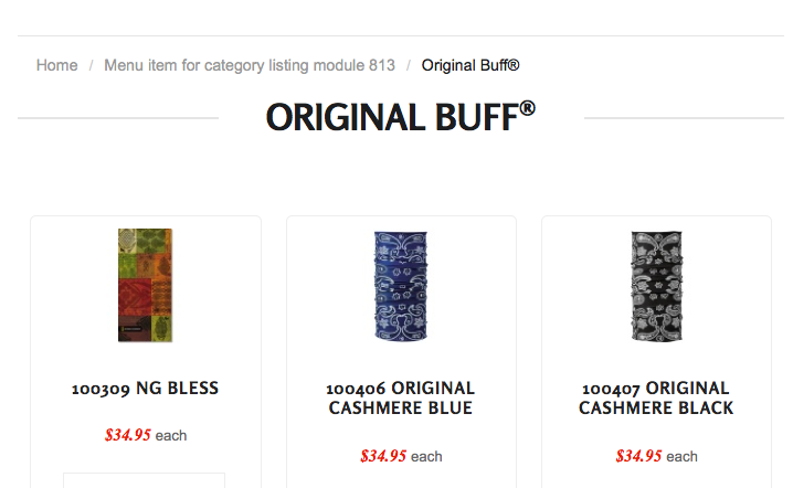

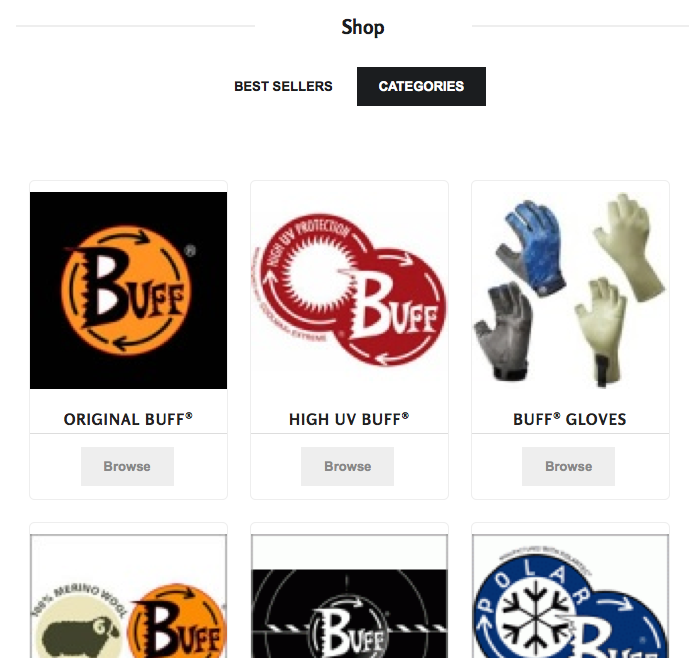

I am just setting up some modules and I have troubles getting it right. I assume that it is my understanding of the detailed settings for modules.
Here is my test server
cqh73.joomexp.com/gavick/
If you scroll down to the homepage you will see tabs with one saying Categories. This is a Hikashop module displaying categories. If I click on for example "Original Buff" I get screenshot 2. Instead of going to Home / Shop / Original Buff® (the menu I set up for every category) I get
Home / Menu item for category listing module 813 / Original Buff®
It's the same if you click on "Best Sellers". The product URL is different than if you go through the menu.
What do I have to do to get every category module to lead to one category Url and one product URL so that I don't have duplicate URL's for the same content?

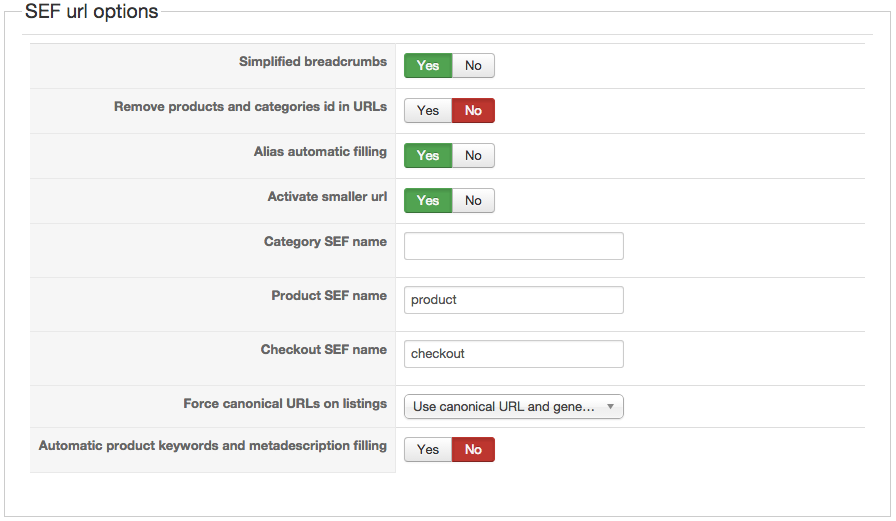

I have activated the option "Use canonical URL and generate if missing" but it doesn't do any filling. This creates 2 questions.
1. What do I have to do to get Hikashop to fill in the URL?
2. What does the structure of the URL in the canonical field look like? Is it the full url or just the relative part?
Edward

1. it seems to work now but I don't know why.
I have noticed that sometimes there is a lag between changing settings and seeing the changes. I browse the test server with Fireforx and have all cache disabled and force to check for a newer version of the page every time. Is there a recommended waiting time to see changes happen or any trigger I should be aware off?
2. The resulting URL is weird
/gavick/index.php/hikashop-menu-for-module-813/category/28-original-buff.html
I went through the main menu so I clicked on "Shop" which has ...module-880 associated and not ...module-813. 813 is a published module for the homepage categories display. I did not touch that at all so no URL was created that looked like the canonical URL. Do I have to worry?
Edward
11 years 4 months ago #201271
by nicolas
Replied by nicolas on topic Not understanding modules and URL's
HI,
1. When you edit a module via the menu Display>Content modules, you can select the target menu item of the links in the "menu" setting.
If you don't have the same menu item selected, you'll get a different menu item alias in the URLs.
2. Also, a simple solution is to use the "Force canonical URL on listings" option of the HikaShop configuration to auto fill the canonical URLs of the products so that the same link would be used on all the listings, regardless of the "menu" setting.
3. The automatic filling will be done only when the system needs to generate the URL on the frontend. So as long as you don't display the products listing on the frontend, you won't see the canonical URL filled in the product.
4. It's the relative path of the URL which is put in the canonical URL field, but it can also accept the full path.
5. There is no cache in HikaShop. So changes should be automatic. The only reason it wouldn't would be some other cache somewhere.
6. hikashop-menu-for-module-813 is the alias of your menu item. You can change it when you edit your menu item via the joomla menu manager.
"category" is the "category sef name" that you configured in the HikaShop configuration. So you can change it if you want.
28 is the id of the product, that you can remove if you turn on the "remove category and product ids from URLs".
original-buff is the alias of the product so you can change it in the product if you want.
/index.php and .html are added by joomla.
