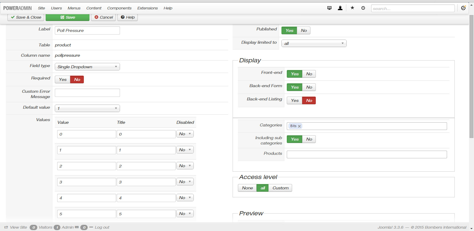

11 years 3 months ago #201748
Could you do a screenshot of the settings page of one of the custom fields on use so that we can see how you have it configured at the moment ?

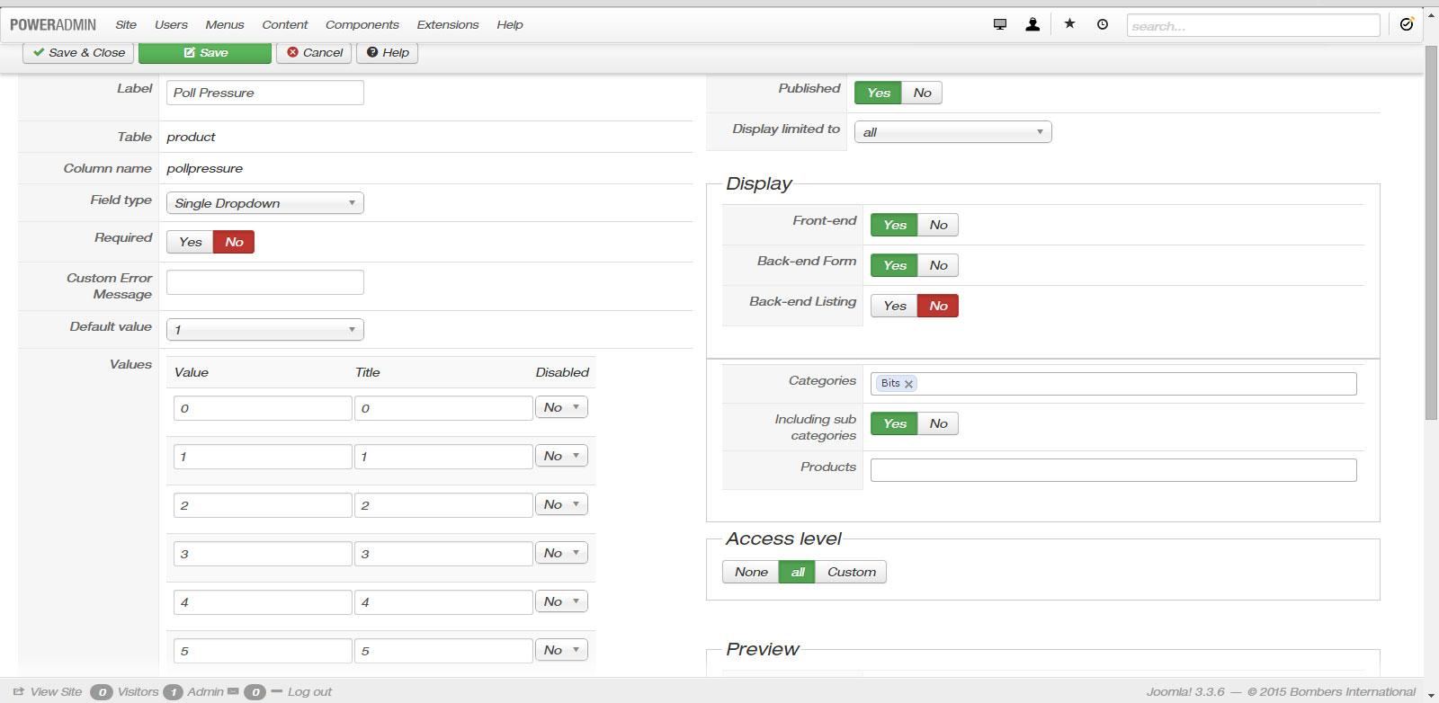

  • Posts: 26
11 years 3 months ago #201751
Hi Nicolas
Please find attached the screengrab.
  • Posts: 86094
  • Thank you received: 14197
11 years 3 months ago #201752
So in the "Title" column of your values, instead of 0, 1, 2, etc enter translation keys like that:
POLLPRESSURE_0
POLLPRESSURE_1
POLLPRESSURE_2
...etc...
Then, edit your language file via the Languages tab of the HikaShop configuration and enter such translation override:
POLLPRESSURE_0="<img src='http://mywebsite.com/myimage0.jpg'/>"
POLLPRESSURE_1="<img src='http://mywebsite.com/myimage1.jpg'/>"
POLLPRESSURE_2="<img src='http://mywebsite.com/myimage2.jpg'/>"
...etc...
Then, you'll see on your frontend that the numbers will be replaced by the images.

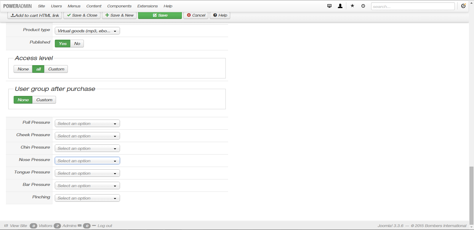

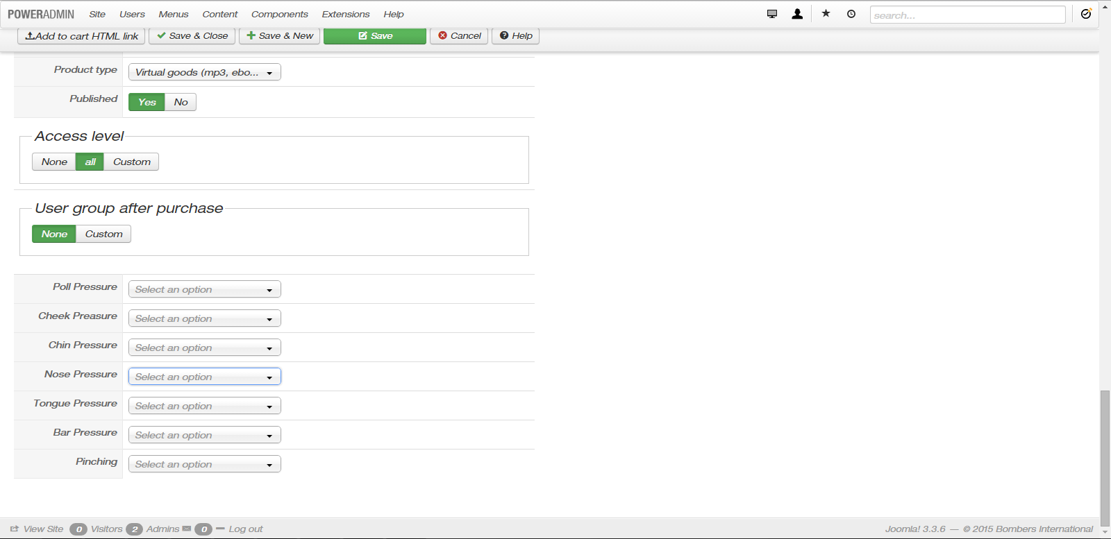

  • Posts: 26
11 years 3 months ago #203134
Hi Nicolas
There seems to be an issue with the fix you suggested. When i am in the back end editing a product i cannot configure the drop downs so it displays the correct image. The dropdowns are grey-ed out, please see image attached.
Many Thanks
11 years 3 months ago #203142
Please edit the file "administrator/components/com_hikashop/classes/field.php" and replace the functions "trans()" by:
	function trans($name) {
		//We use JText if there is only uppercase or underscore char
		$val = preg_replace('#[^a-z0-9]#i','_',strtoupper($name));
		//We use JText on backend only if there is no html tags in the translation
		if($app->isAdmin() && strcmp(JText::_($val), strip_tags(JText::_($val))) !== 0)
			$trans = $val;
		else
			$trans = JText::_($val);
		if($val == $trans)
			$trans = $name;
		return $trans;
  • Posts: 26
11 years 3 months ago #203187
Thanks Xavier your fix works.

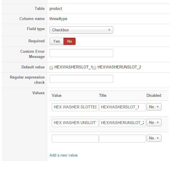

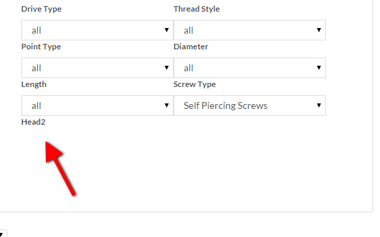

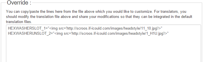

  • Posts: 22

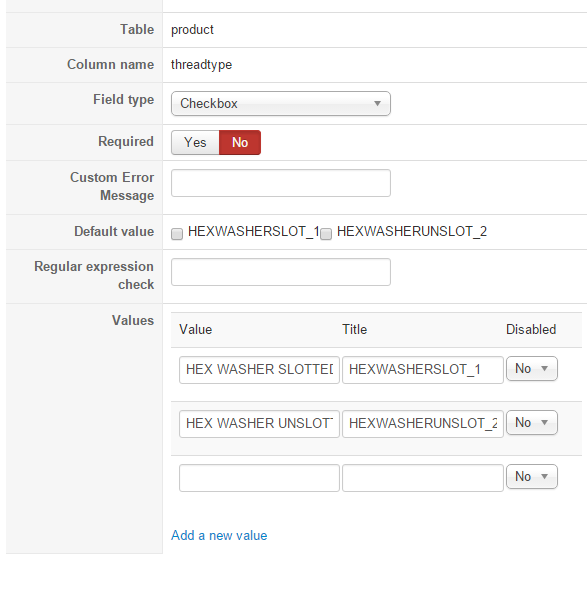

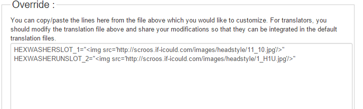

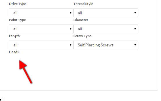

11 years 3 weeks ago #211336
I tired this method you describe -- hoping that the images would show up in a filter for the custom field. But no joy -- get no images in the filter. Is there something I'm missing? the value keynames in the title. See attached.. and then I edited language file. But get nothing in the filter.

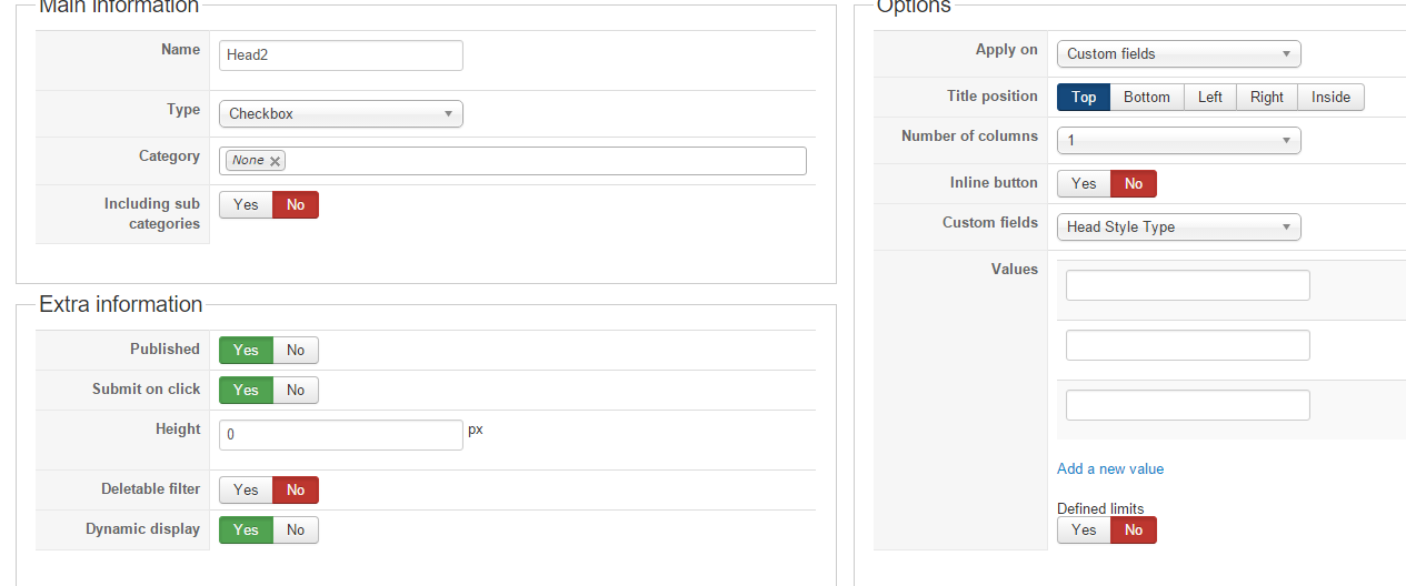

  • Posts: 86094
11 years 3 weeks ago #211339
Can you provide a screenshot of the settings of your filter and a link to that page with the filters so that we can reproduce the issue ?

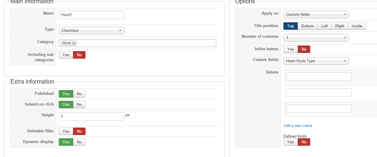

11 years 3 weeks ago #211410
Here is the site -- it's the dev site.. the last filter
scroos.if-icould.com/index.php/buy-screw...ilter_ScrewType_2=24
  • Posts: 86094
11 years 3 weeks ago #211429
The issue seems to come from the settings of the custom field, not the translation of the values.
Could you provide a screenshot of all the settings of your custom field ?
