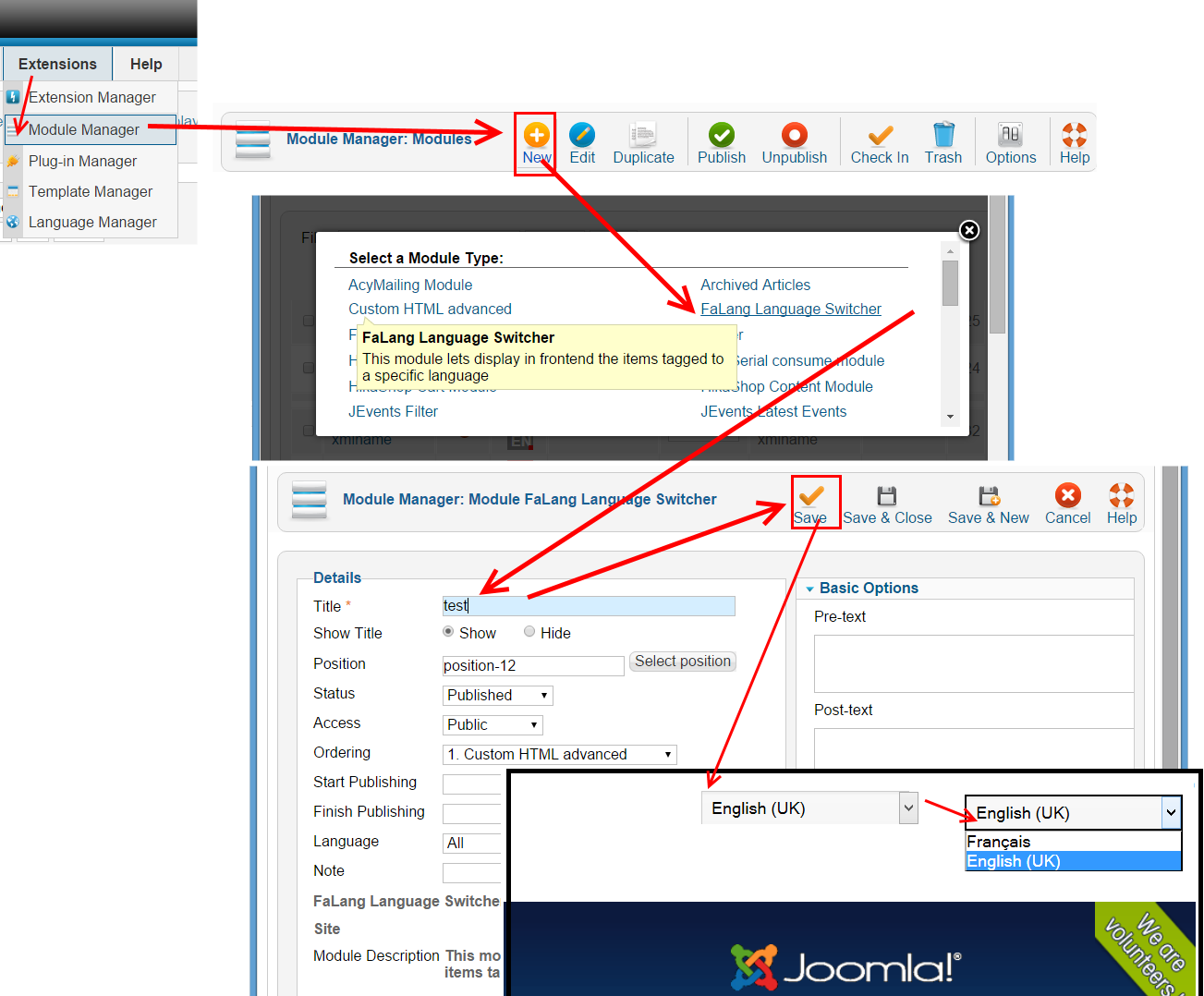

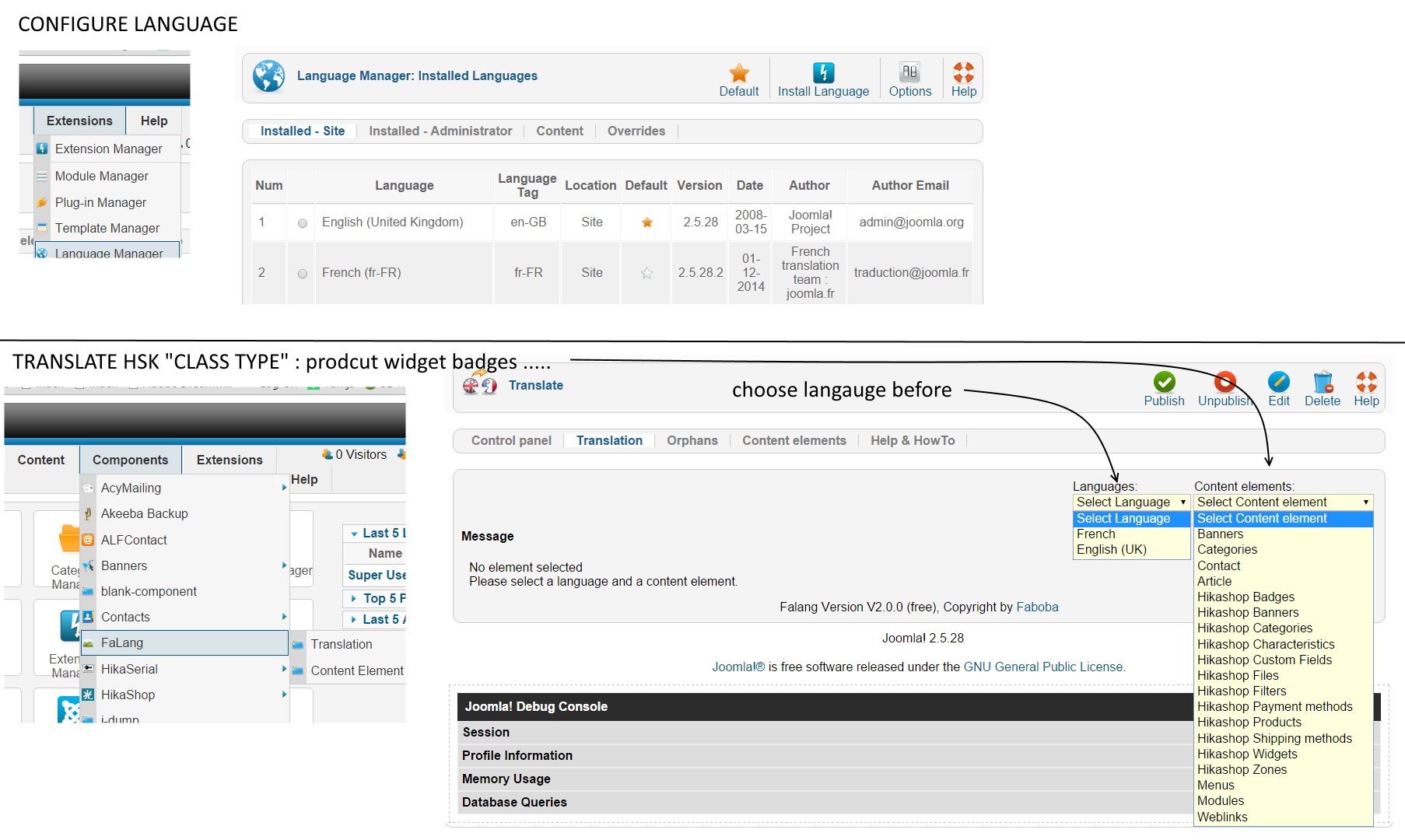

hi
you need to use ( install) a joomla extension that support language to be able to edit HKS product for each language . Here example whe nuse falang. The translation can be achieve using falang extension
Attachment not found
place a falang module to be able totest select language item in frontEnd
