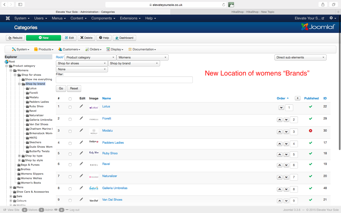

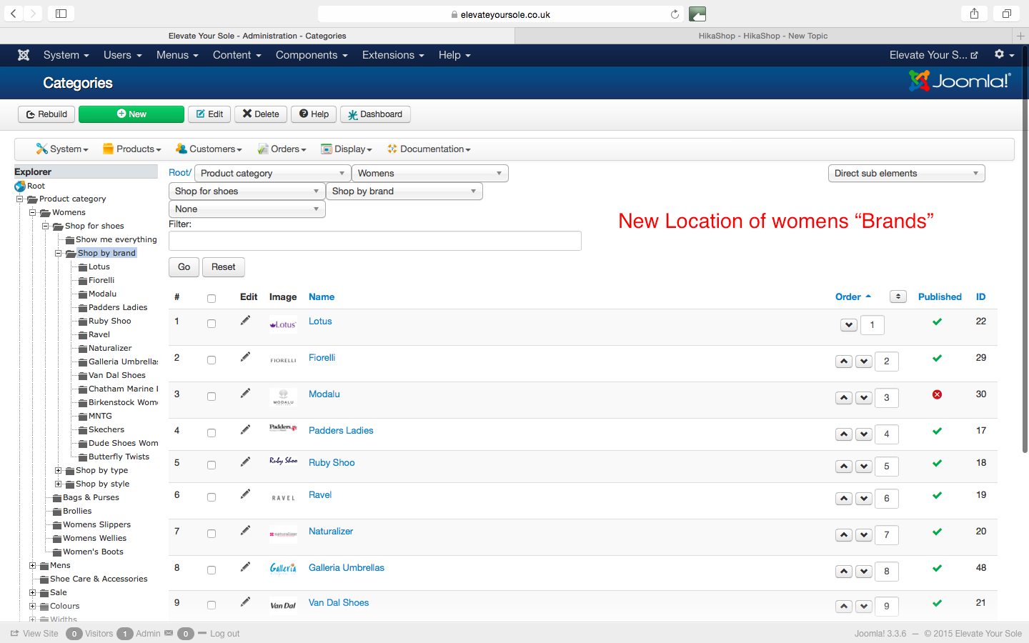

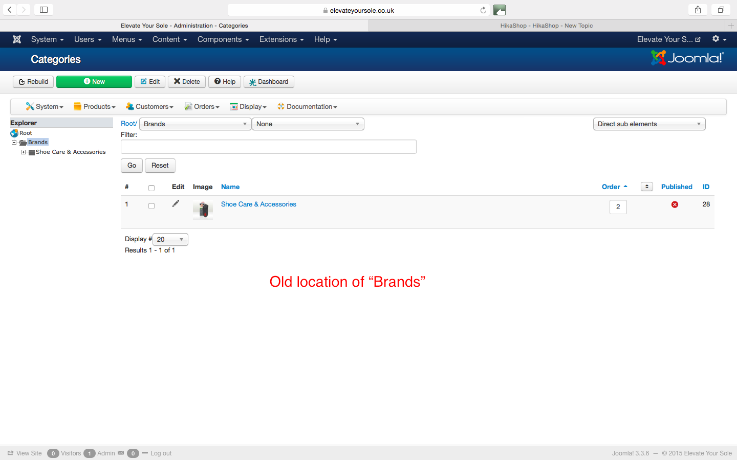

I've been updating the menus of my website recently and decided to bring my brands under a new sub category.

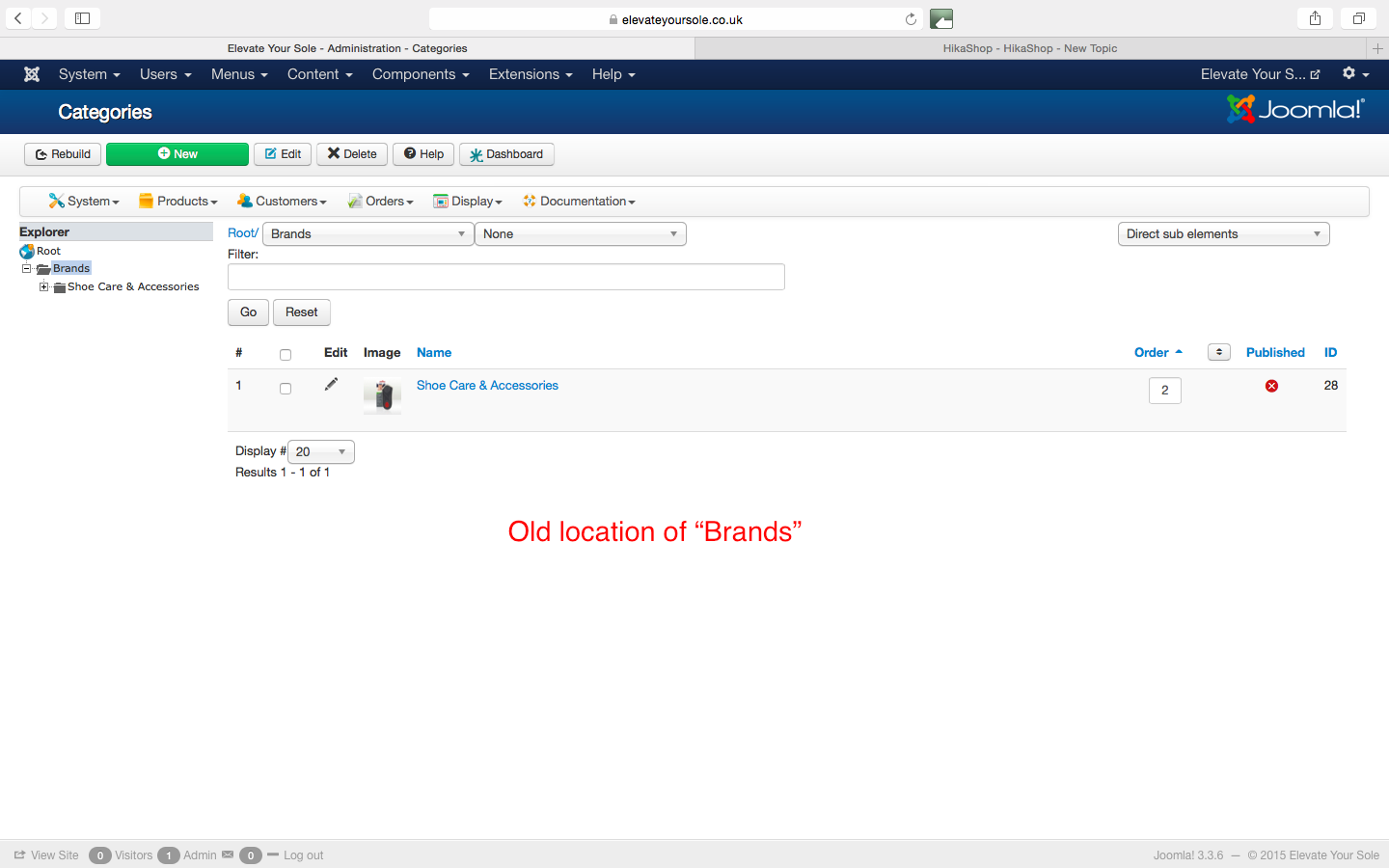

I already had two sub categories "mens" and "womens" within the "Brands" parent category, so I just moved them into their new corresponding parent categories.

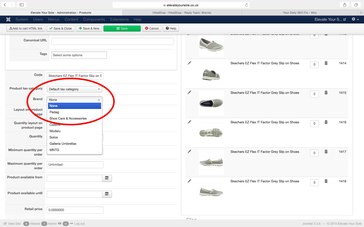

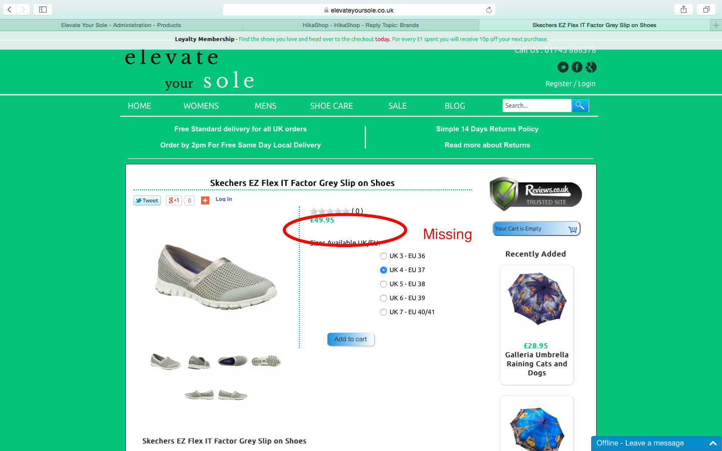

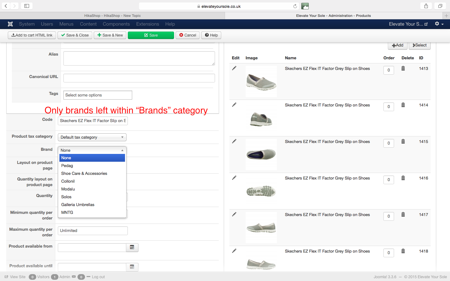

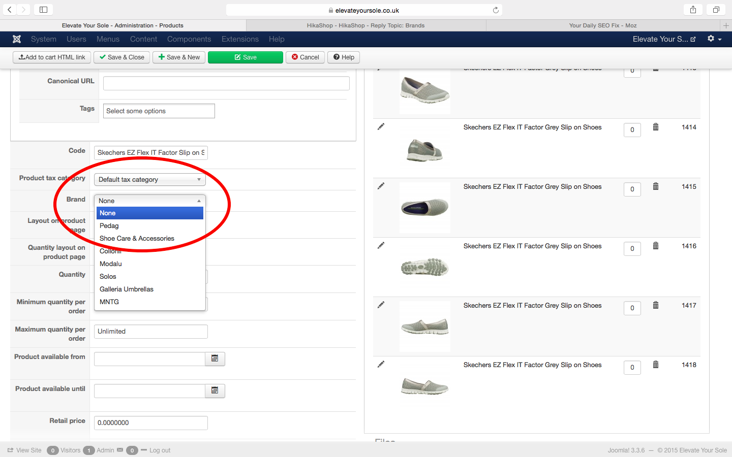

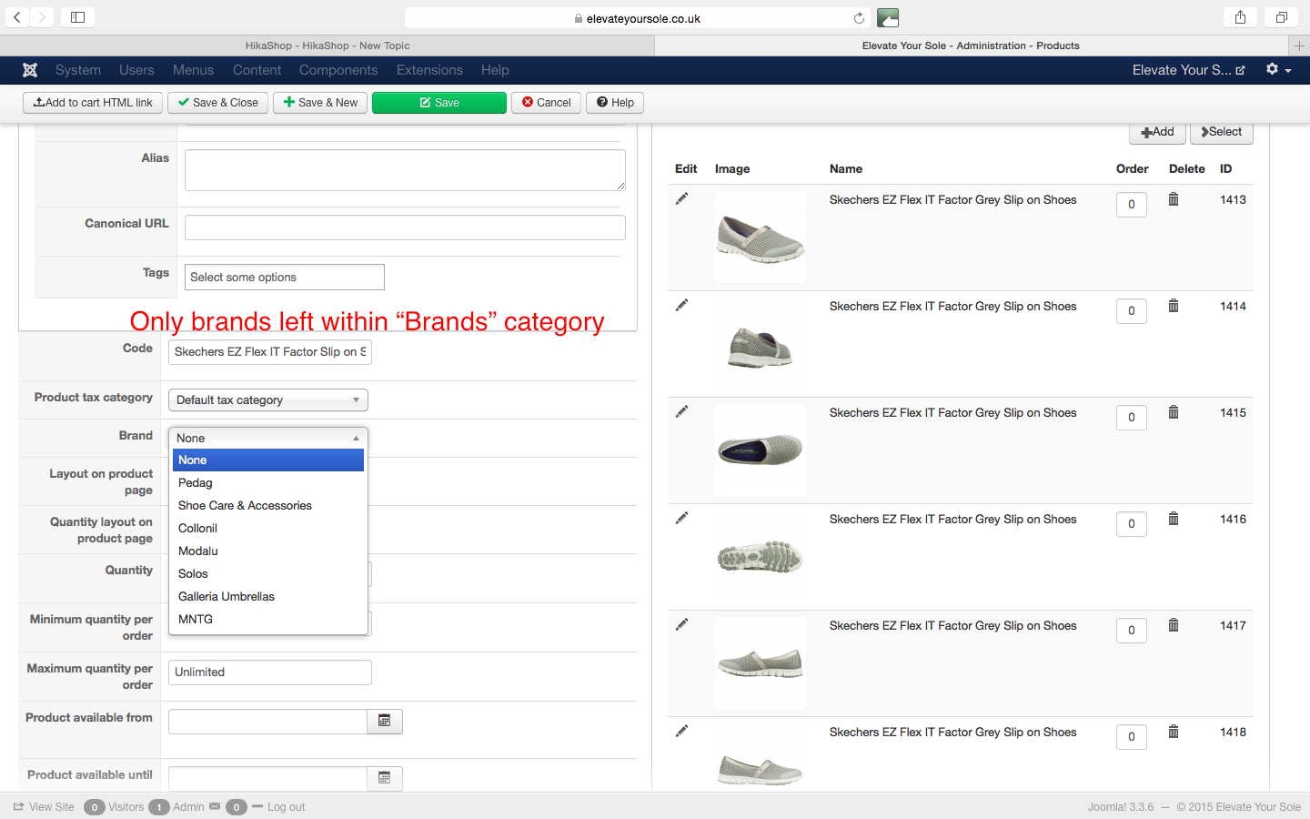

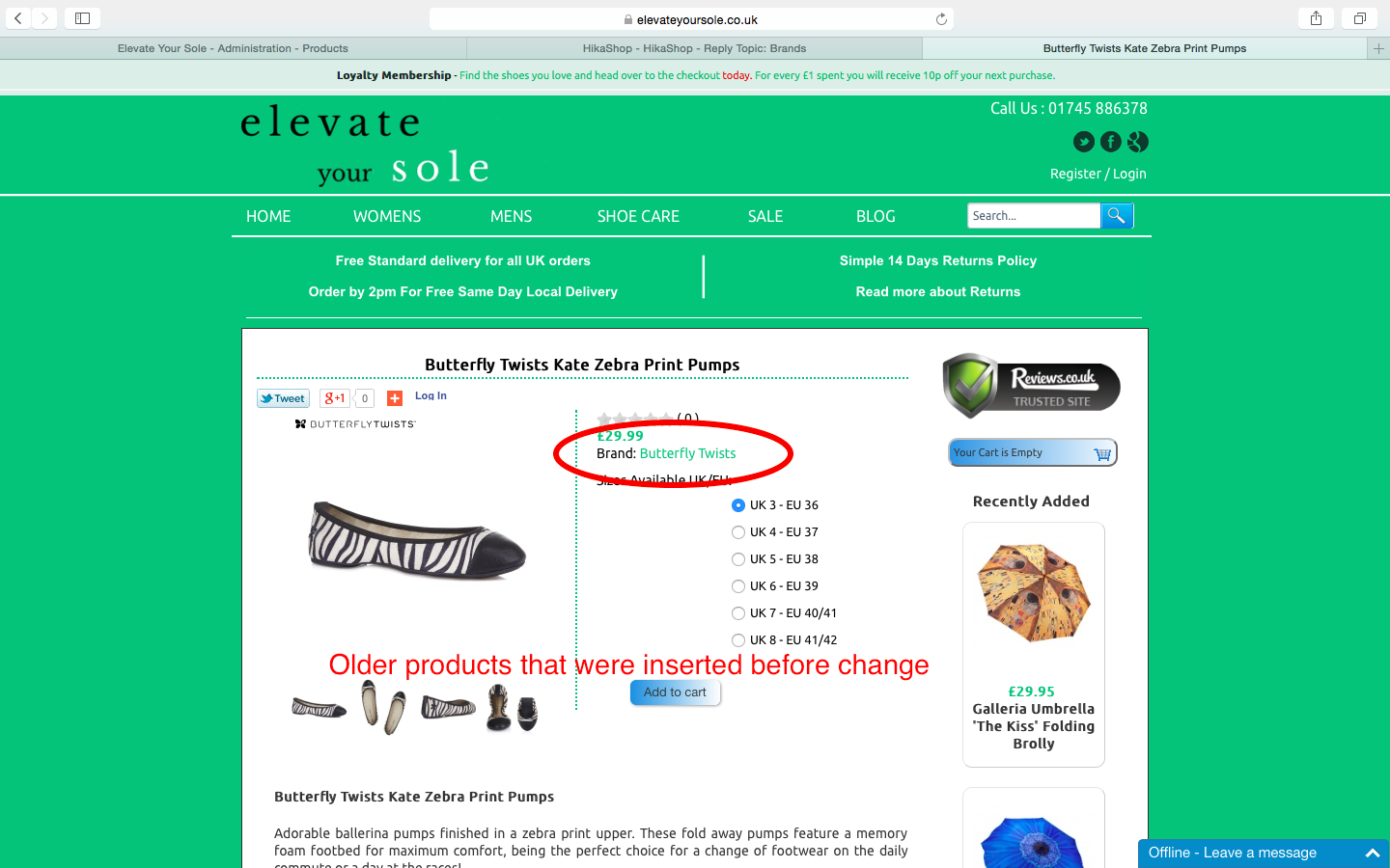

It all looked fine, but as I've tried to add a new product today, I have realised that I can't assign a brand to the product pages. I believe that this is because they are no longer under the "Brands" parent category.

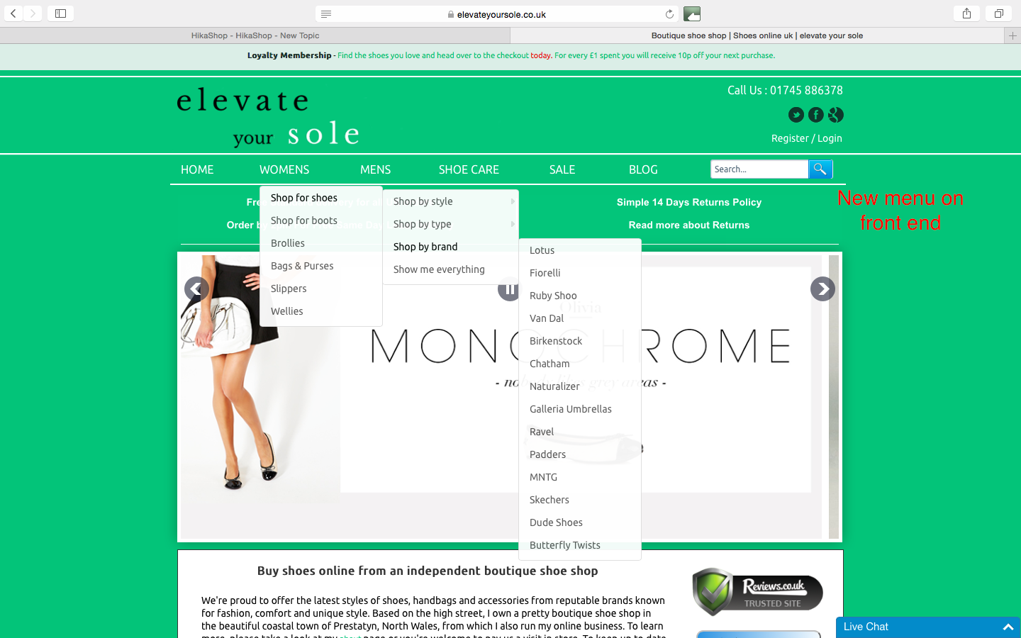

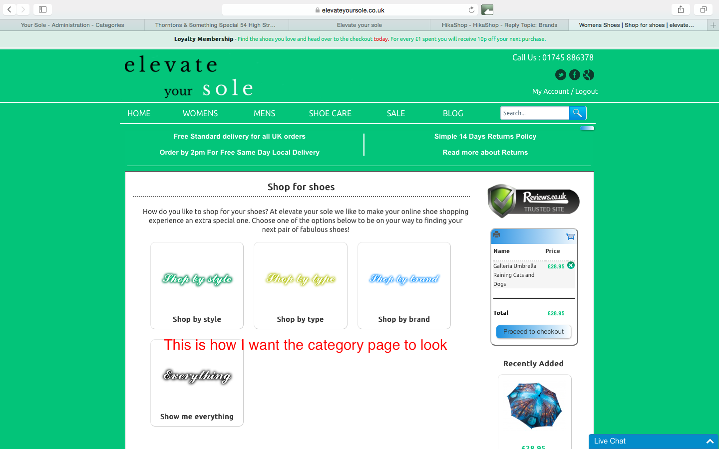

I've added some screenshots to try and explain. The reason that I think this is important is because I would like to maintain the navigation link on the front end, at the page /womens-shoes
I also realise the importance of being able to filter by brand, which I'm not going to be able to do...
I hope that you can help :).

Because a brand is not really a category, what you're trying to do can't work like that.
Even if both are stored in the "category" table ; they have a different "category_type".
That's why the brands are stored under the "brand" category and the product categories are stored under the "product category" category.
So if you want to have brands under the "product category" category, you have to change their category_type in the database so they will be displayed in the product page.

I haven't had a problem moving the brand categories, thats worked fine.

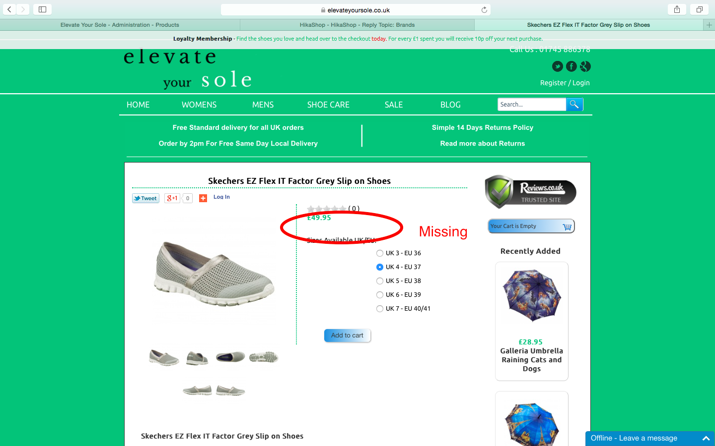

The problem is that I now find myself unable to associate a product with a brand (please see screenshots).

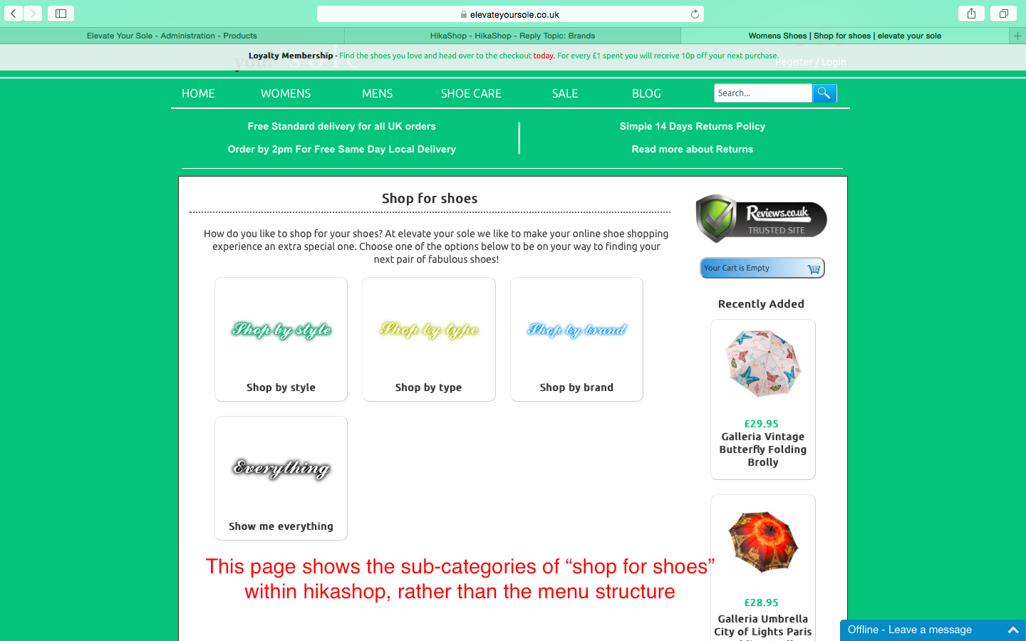

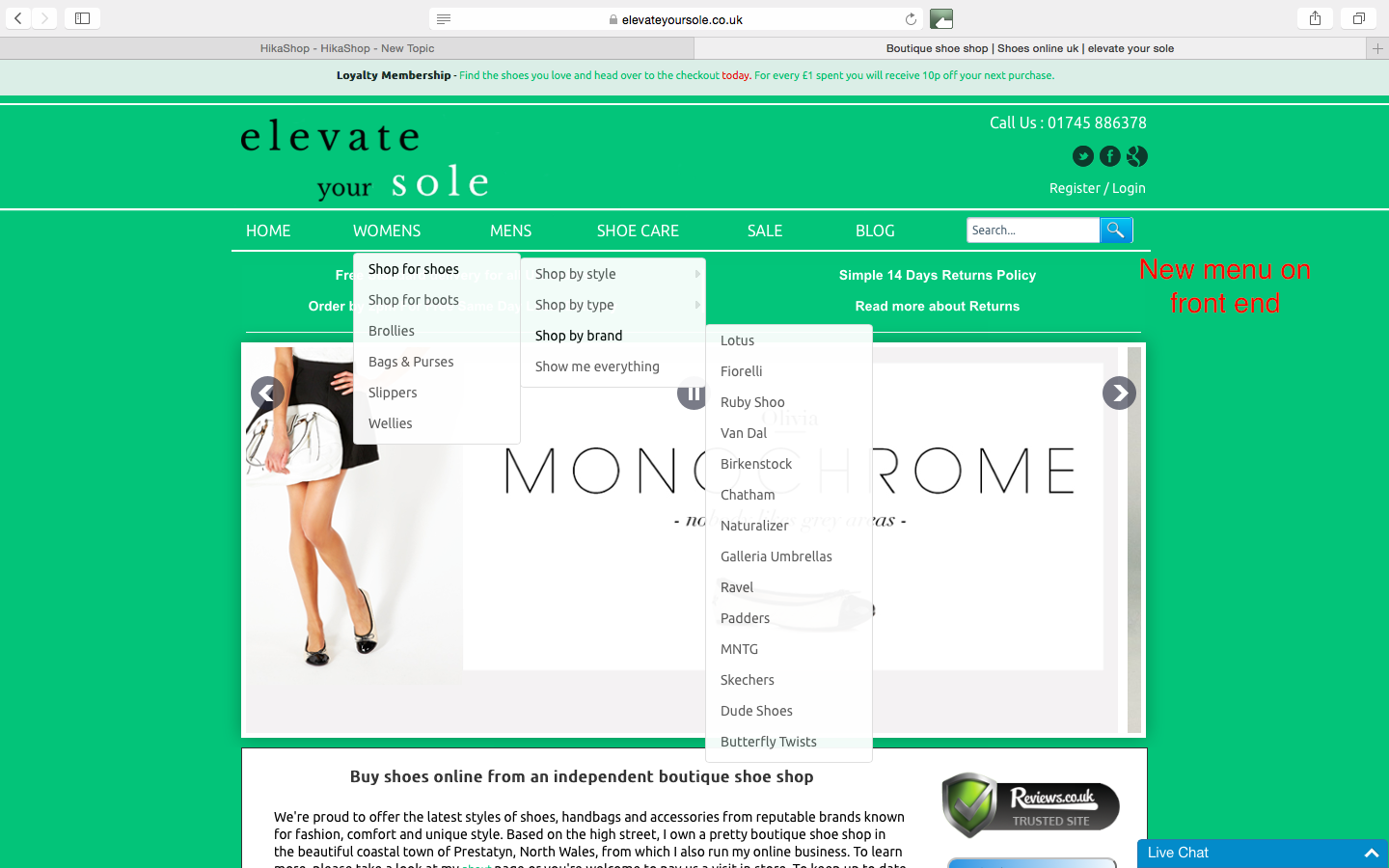

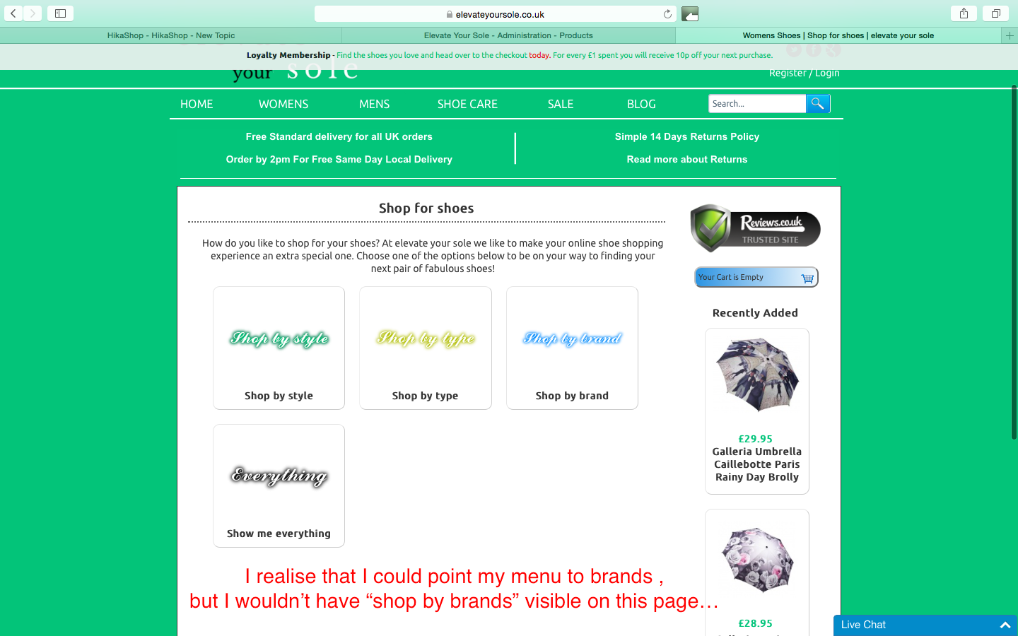

I can point a Joomla menu to a category under the "Brands" tree and it works fine, if you navigate using the menu. However, if you navigate through the category pages it wont be available. It only shows the "product" sub-categories that I've assigned in Hikashop.

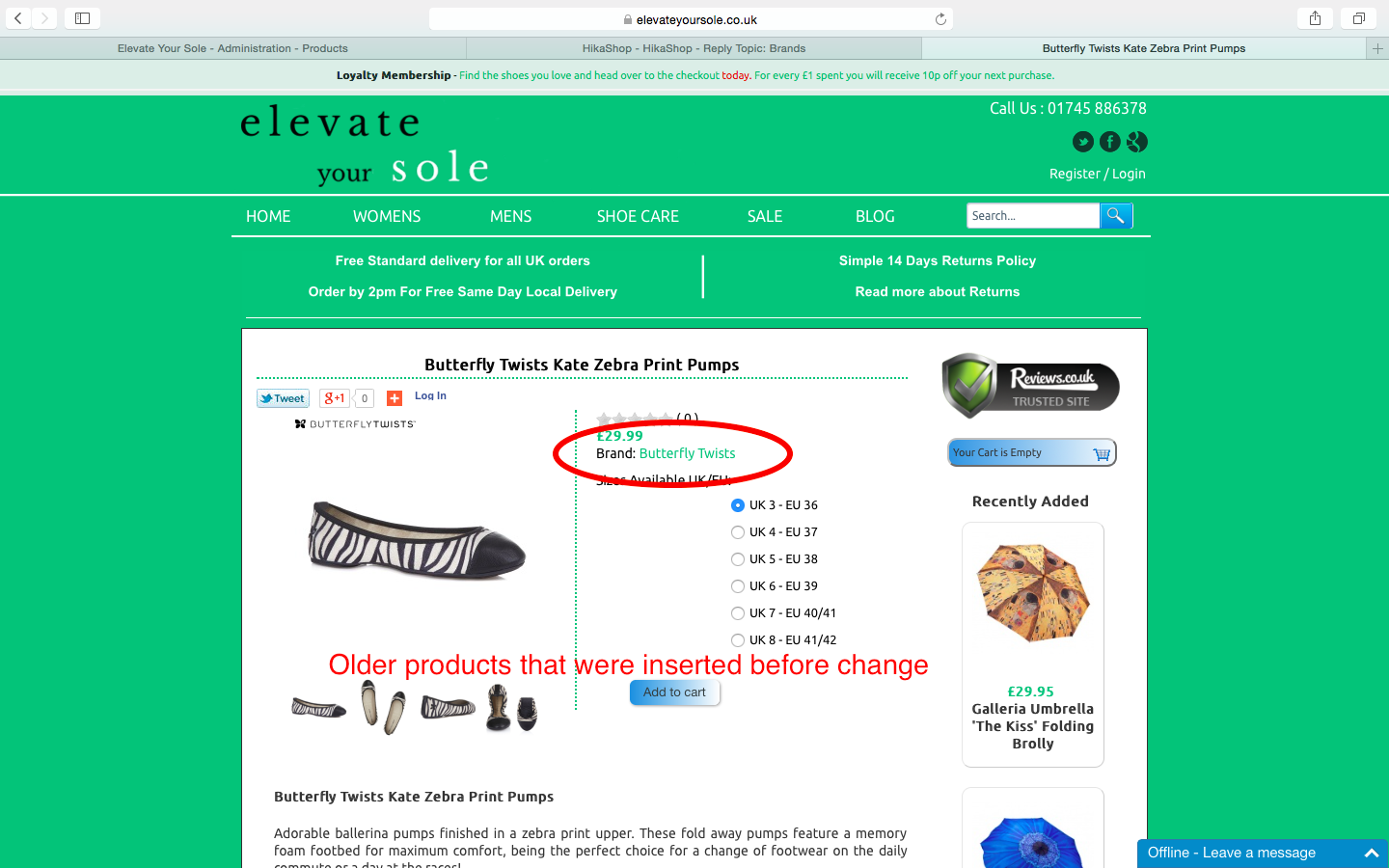

That's normal. You moved the element from being a brand to being a category. So it is not listed anymore as a brand and thus you don't see it in the brands selector or as brand on the product page.
If you want the element to work as a brand, it needs to be a brand inside the main "brands" element.

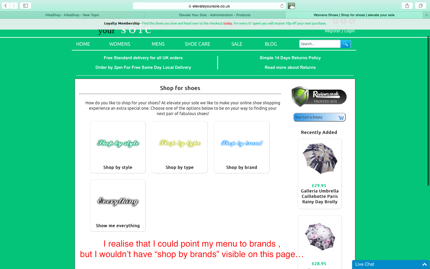

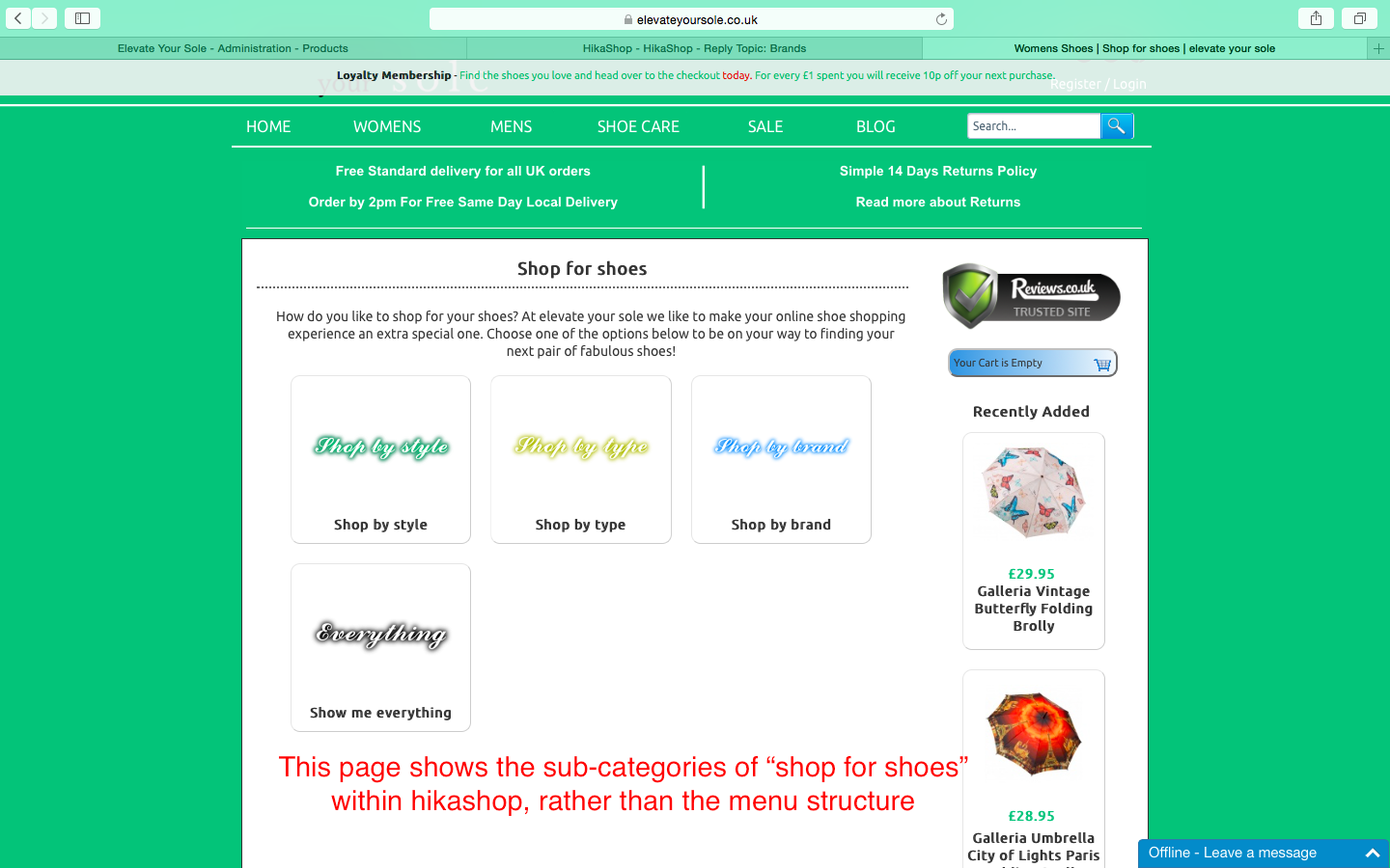

11 years 3 months ago #203058

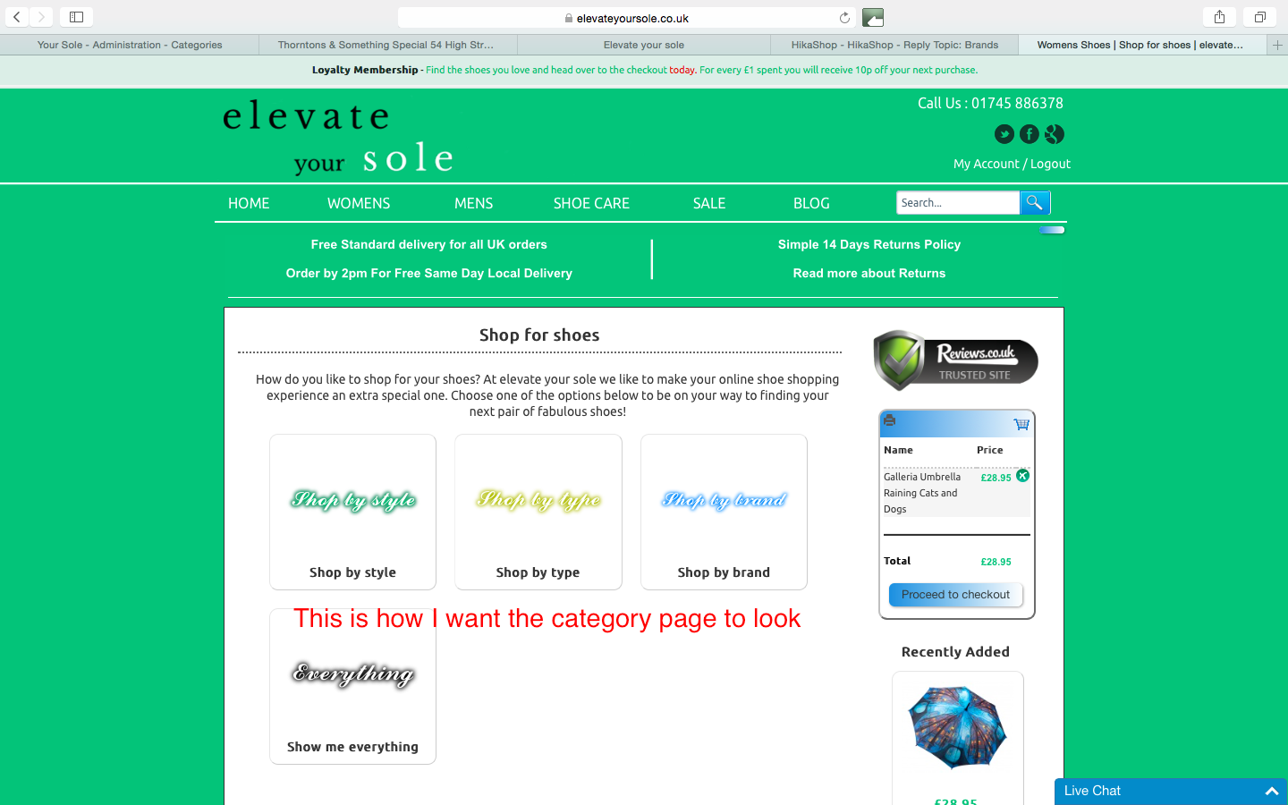

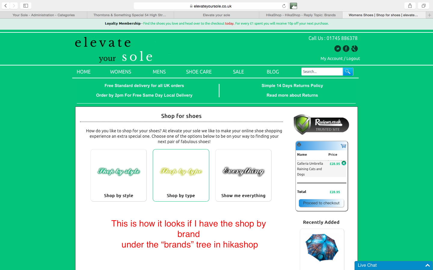

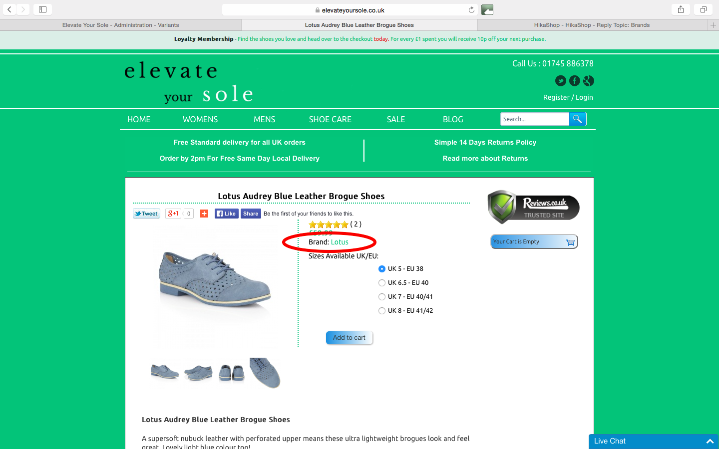

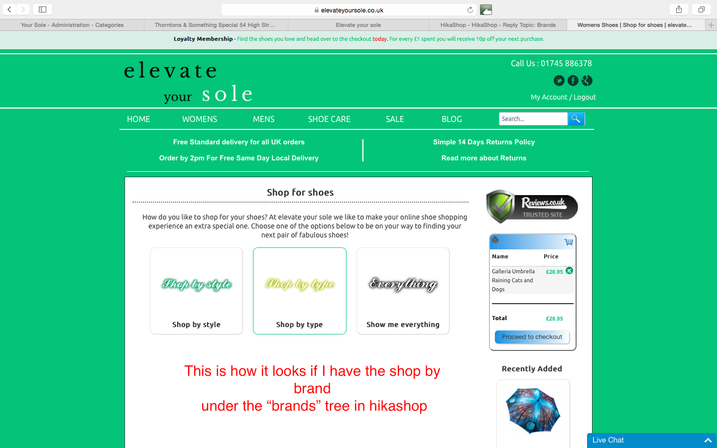

I have attached two screenshots to show the problem on the front end. The Joomla menu works in each case, but the category page doesn't reflect this.
This is why I think the ideal solution would be to automatically show this category if it's used within the Joomla menu. It wouldn't then matter where the category was located within the hikashop category trees.

11 years 3 months ago #203086
Brands are brands. They are not supposed to be listed in categories listings.
It's like if you were asking me if there is a fix to display HikaShop products in joomla article listings.
They are two different entities and like Joomla article listings are not meant to display HikaShop products, categories listings are not meant to display brands. So there is nothing to "fix" here. The issue is conceptual, not code or settings.
One you could do is actually not use a categories listing page to display that first page.
Instead, you should create a Joomla article with four links, each one linking to its category listing menu item or brands listing menu item and then have that article display on a page instead of that categories listing where you're trying to add the brands listing.
Actually, a much simpler solution would be to create a fake "shop by brands" category, and in the "canonical URL" of that category, enter the link of a brands listing menu item, and then make sure that the "force canonical URLs on listings" setting is activated on your HikaShop configuration. That way, you would have a categories listing like you want with the four elements, and the shop by brands would work like you want.

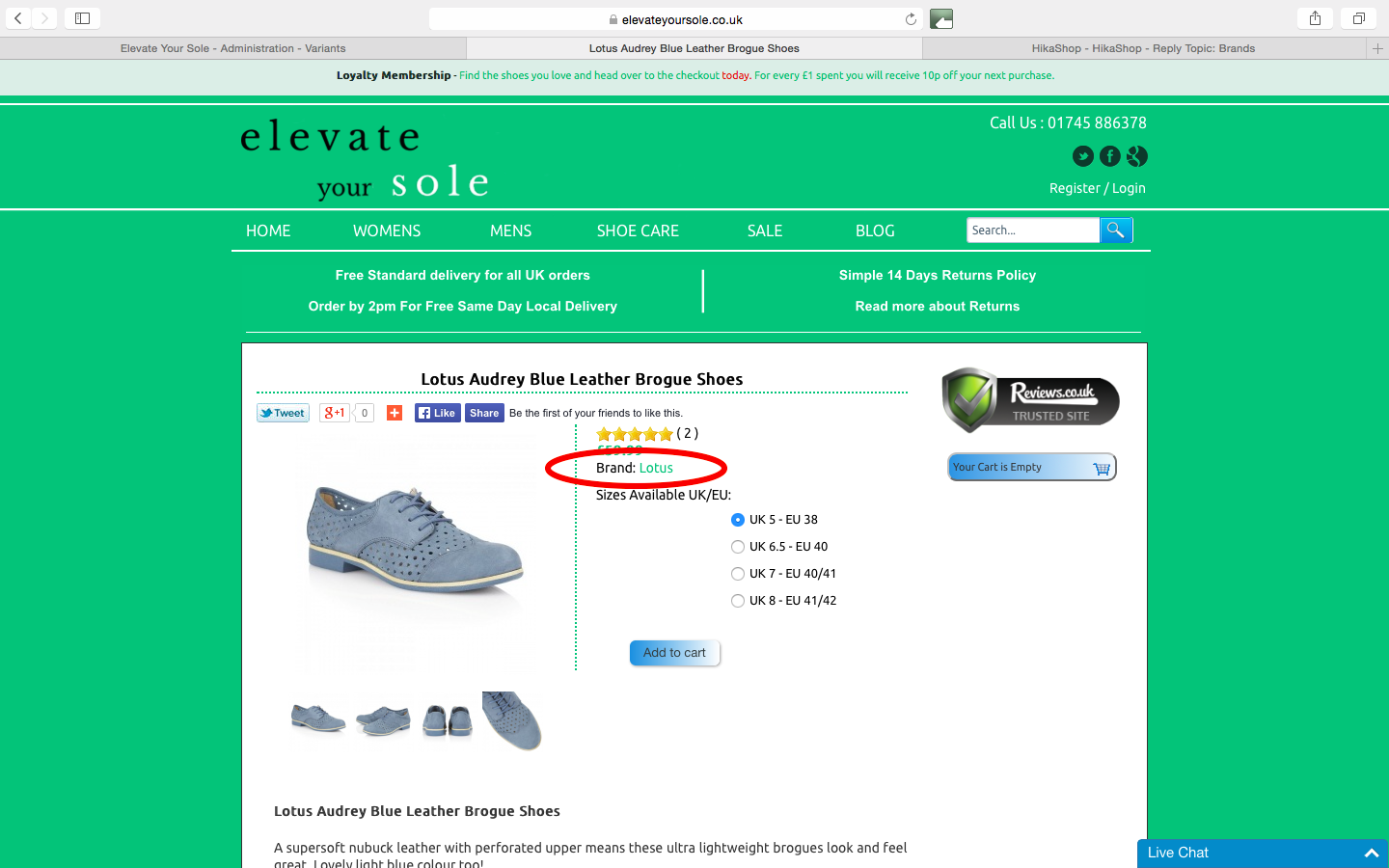

11 years 3 months ago #203764
Hello Hal,
Sure but you'll have to edit the code of the "Show_default" file of the "Product" view of your front-end template via "Hikashop->Display->Views".
