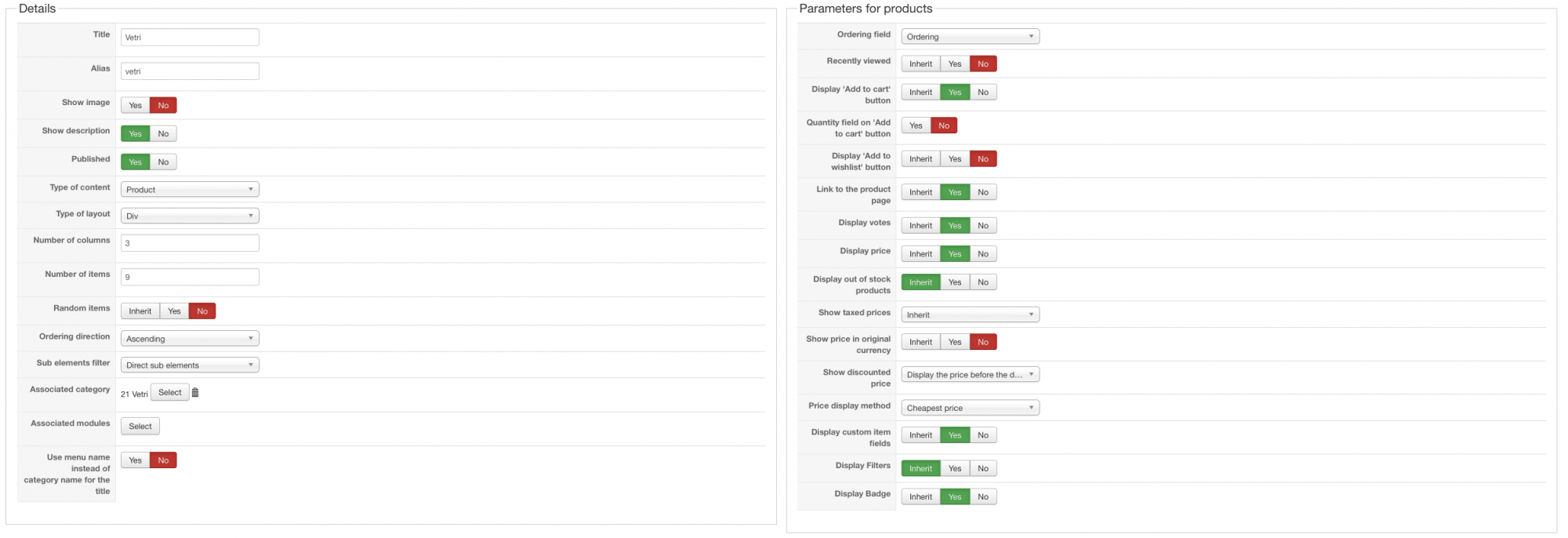

  • Posts: 121
11 years 3 months ago #203818
here the screen.
Thanks.

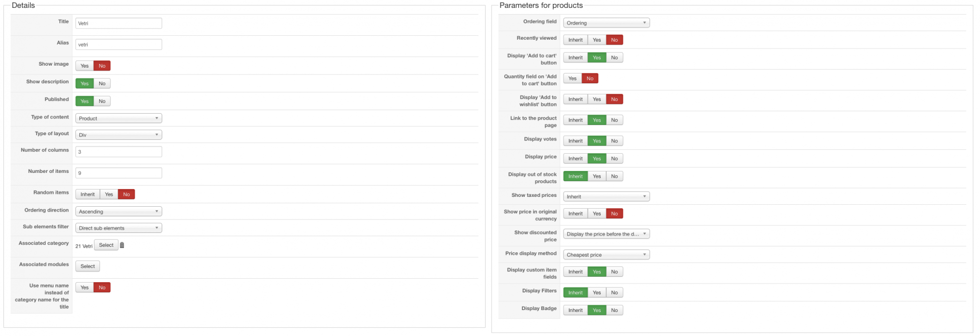

  • Posts: 121
11 years 3 months ago #204152
here the product config.
Matteo
