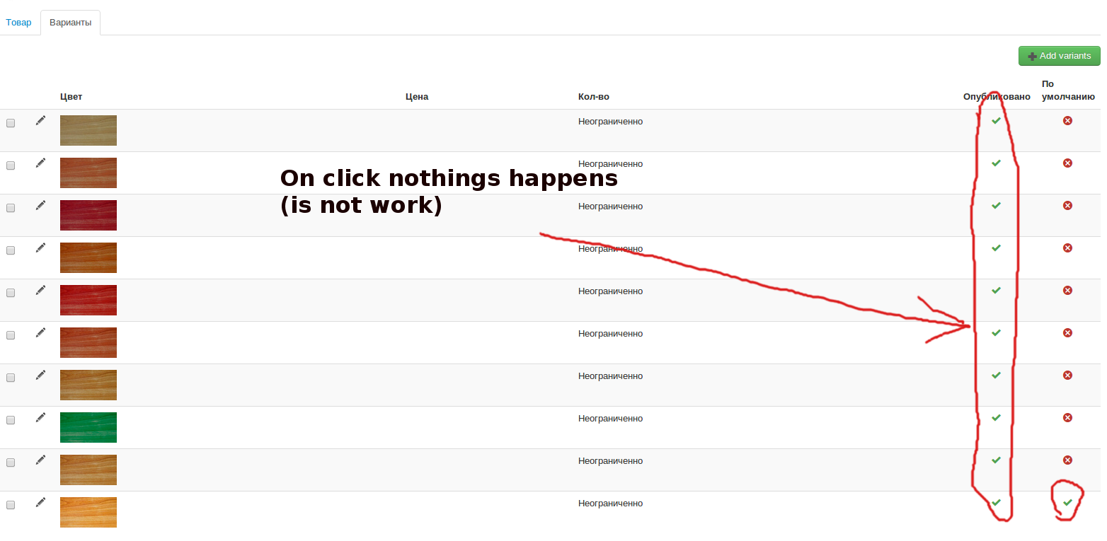

Options "Variant published by default" is not working. Products always display with variant by default if option set as Yes or No.

11 years 2 months ago #205022
Yes indeed this option is no more used, the variant system has changed, now you have to create your variants, they are no more generated automatically so when adding new variants you can publish or unpublish them directly in the listing from the product edition page.
We will see to add back that feature or remove the option definitively. Thanks for the report.

The problem is that I want to that no option is not displayed by default. But I can not do it in backend. Besides that on click by checkmark "published" nothing happens.
11 years 2 months ago #205124
Yes my bad, you have to click on the variant to open its edition and then unpublish it thanks to the option.

But I want that no one variant not published by default. How can i do this?

Finally it received. My mistake was that when I'm choose the characteristic, I'm not filled value by default and tab variants not exist. And I could not guess intuitively.

In the variant listing, you have a column for the "default" where you can see the default variant.
So if in the list there is none variant with the green tick, it means that your default variant does not exist (and you have to choose one in the current list)
When with the old interface you had to read the default variant configuration in one page and check it is exists in the variant listing, with the new interface you can see that directly in the listing.
But we will see to add a little message above the variant listing when there is no default variant in the list.
