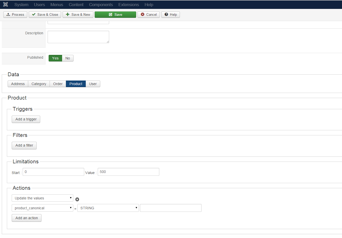

  • Posts: 92
10 years 1 month ago #240671
Hi Nicholas,
I used a mass action to empty all canonical URLs and set the "force canonical URLs on listing" to "No, generate URL " to avoid generating any canonical URLs.
The problem is: mass action does not delete canonical URLs in some products. Before that I fixed database and there was any problem.
This is configuration of mass action:
I'd like to empty all canonical URLs and then to set the "force canonical URLs on listing" in "use canonical URL and generate it if missing" but I'd want to avoid correct them one by one by hand :( :(
  • Posts: 92
10 years 1 month ago #240673
I'm really stupid :oops: :oops:
I just realized my blunder: I did not change value in "limitations" and mass action just deleted first 500.
Thanks and sorry
