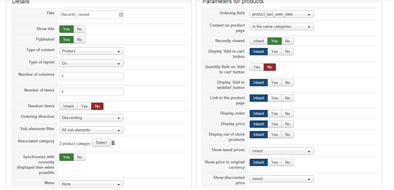

I want to display a recently viewed module that it will display products only from the category that the user is currently seeing.
I've created the module and I gave him the following settings(please see screenshot). On some categories it's working correctly but on others it is not.
thanks!

This looks fine.
Could you provide a link to a page where this doesn't work so that we could look at it ?

I see what you mean now but that's not how the system works. When you turn on the "recently viewed" option, the system forces the display of the recently viewed items and doesn't take into account the current category.
I've looked at the code and I can propose a change which might make it work like you want it to.
Try to add the line:
$pageInfo->filter->cid = JRequest::getInt("cid",$this->params->get('selectparentlisting'));
after the line:
$force_recently_viewed = true;
in the file components/com_hikashop/views/product/view.html.php and that might do what you want.

Even if you force the "filter->cid" ; the filtering won't be processed because the variable $select will not be empty.
Because that variable is set when the "recently view" is activated
if($force_recently_viewed){
  $select='SELECT DISTINCT b.*';
If you let the variable $select empty ; the value of the "filter->cid" (from the Nicolas patch) will be used.
Please note that if you modified a core file ; your modifications will be lost with HikaShop updates.
