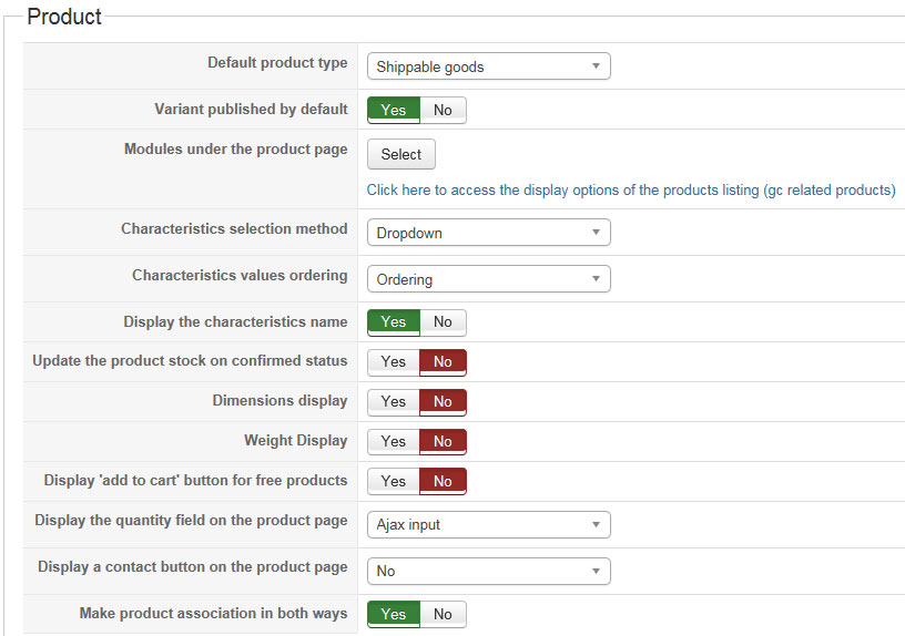

Hi all,
I turned on the option "Append characteristics value to product name" yesterday for a test.
Now I want to turn it off again, but it does not appear in the backend anymore... :blink:
Based on the screeenshot in the documention it should be listed under "Characteristics value ordering" - but it isn´t - see my screenshot attached.
I´m searching for this option for two hours now - did I overlook something?
Thanks.

That option has been removed in HikaShop 2.5.0
We now only display it so that it can be deactivated.
We've had lots of support with people deactivating it and then wondering why what they selected in the characteristic of the product didn't appear on the cart/checkout after adding the product to the cart.
And since almost no one was using it, we decided it would be better to remove it.
If you want to deactivate it, go in the hikashop_config table in your phpmyadmin, and set 0 in the entry with the namekey append_characteristic_values_to_product_name

And I already thought I almost got confused... ;)
I removed it.
