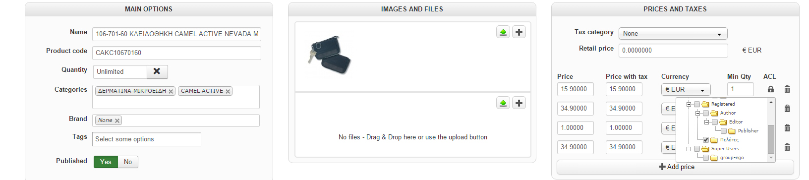

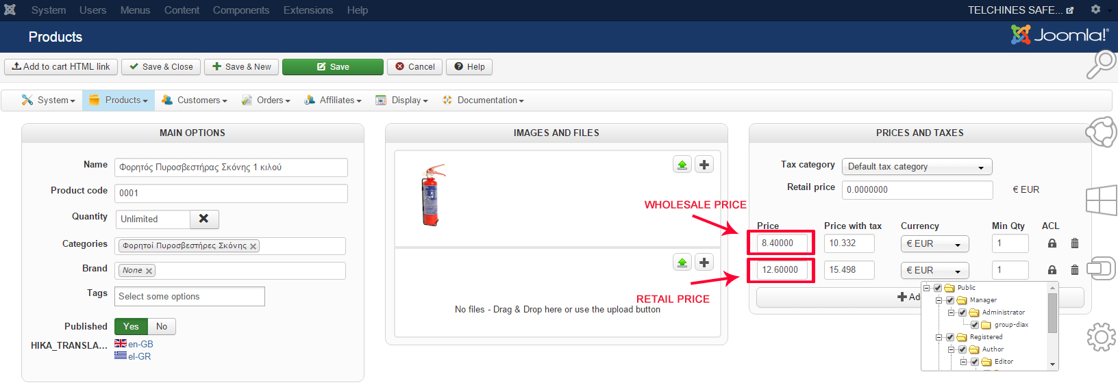

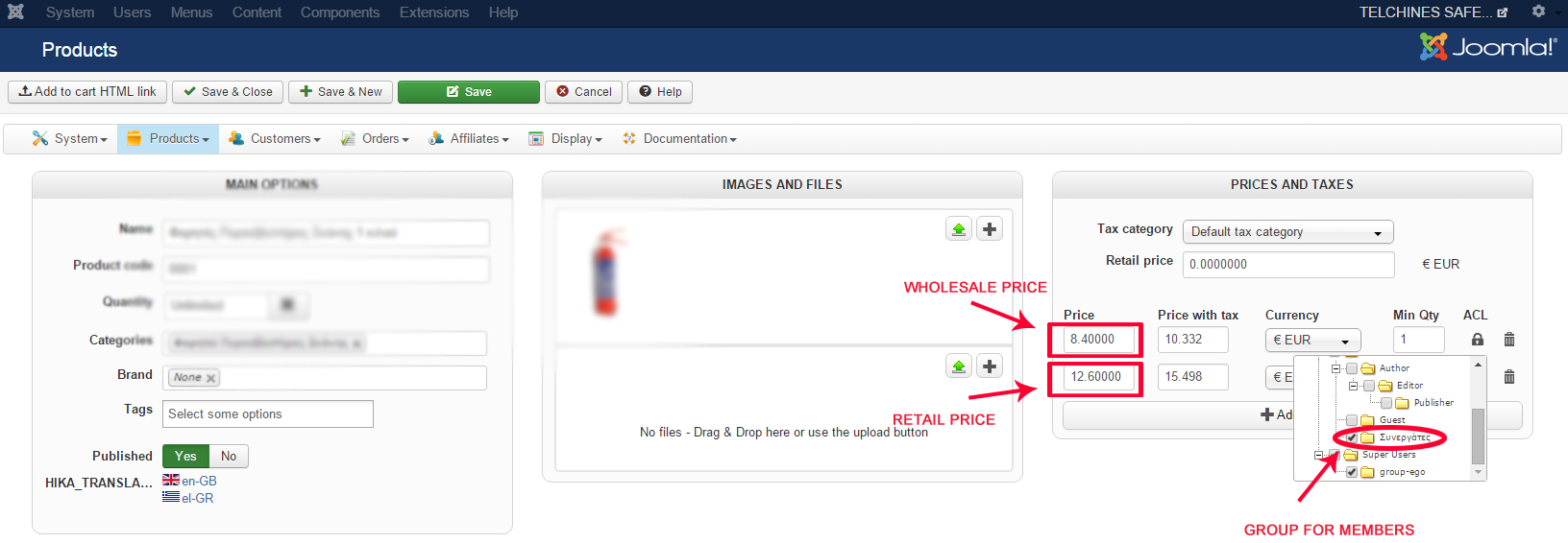

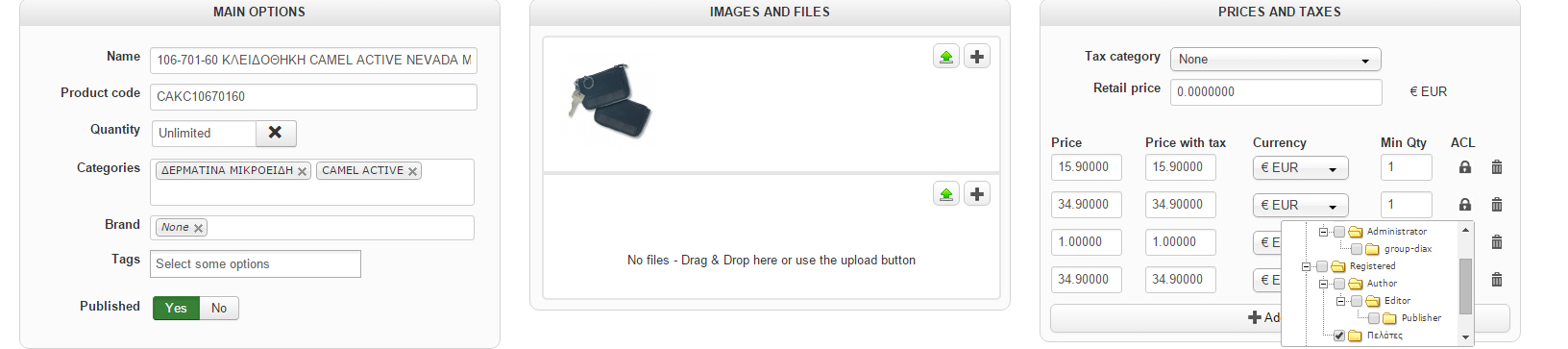

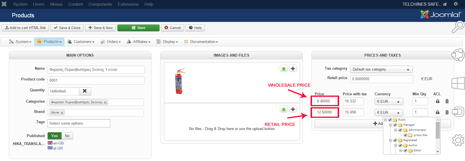

  • Posts: 1170
  • Thank you received: 13
10 years 11 months ago #209280
Hello Nicolas, here are the screenshots of the prices ACL.
  • Posts: 85838
  • Thank you received: 14100
10 years 11 months ago #209337
