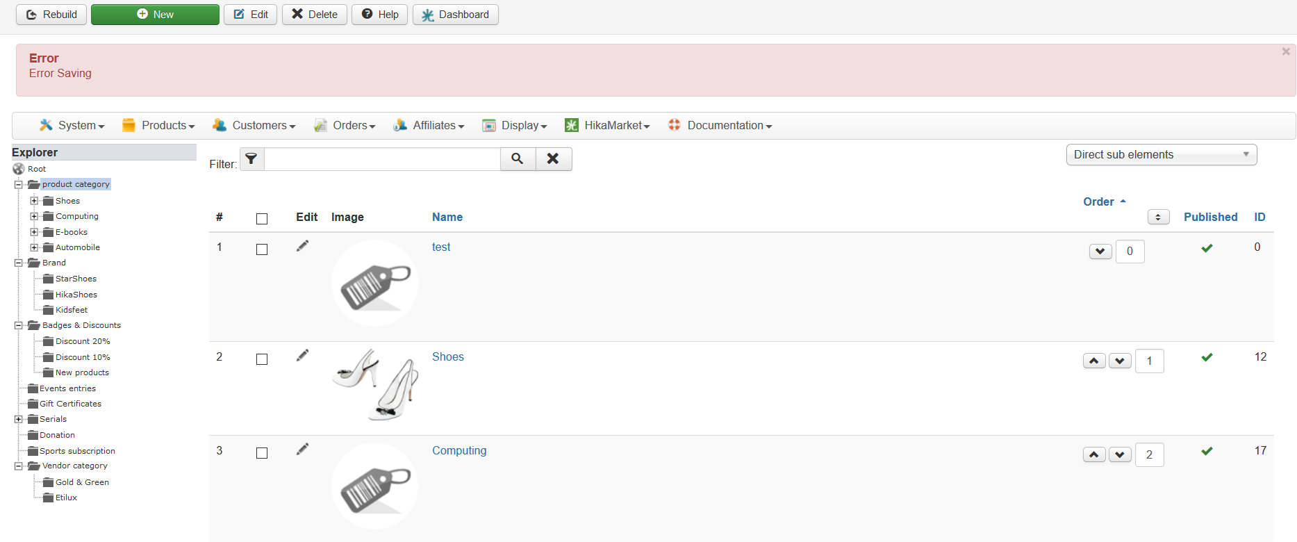

-- Joomla version -- : 3.4.3
-- PHP version -- : 5.5.26
-- Error-message(debug-mod must be tuned on) -- : Error saving when create new category. The new category has always an id with 0
I've made rebuild of categories (after trying to create a new one). I've always the same problem :
"Error saving" appears when create new category. The new category has always an id with 0
* and when i try to use debug mode language ONLY in joomla, the link in the menu component to have access to hikashop disappear.
* and when i try to rebuild categories of hikashop, i arrive on frontend ???
See in attachment

Are you sure that you do not have issues with your database ?
The "category_id" column is an "auto increment" column ; it should not possible to store "0" as an ID.
The case you describe should not be possible with HikaShop.
So I'll suggest you to take a look at your database and maybe re-set the HikaShop data in order to remove the "sample data" from your store.
