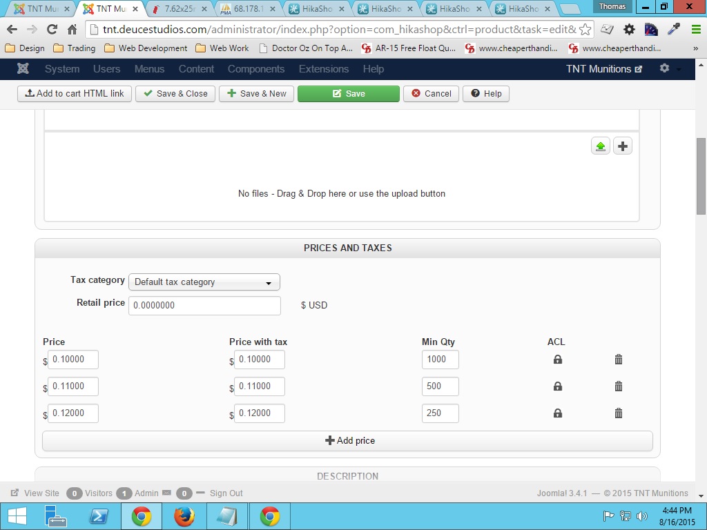

I have created a product that has multiple prices based on quantity (see attached screenshot). I have found a way to display the prices based on the minimum quantities instead of per unit by editing Hikashop->Display->Views->product/listing_price.php where it has:

The problem I'm having is when you land on the page I would like it to show the price for 250 next to "Price with options:" instead of $0.00. I then also need it to update that price on quantity change and option change. For instance:
quantity of 500 with option as yes would display $65.00
quantity of 2000 with option as no would display $200.00
etc.
Right now the price is not updating at all, except if you change the option and then it is per unit ($0.02). What do I need to edit to make this happen.

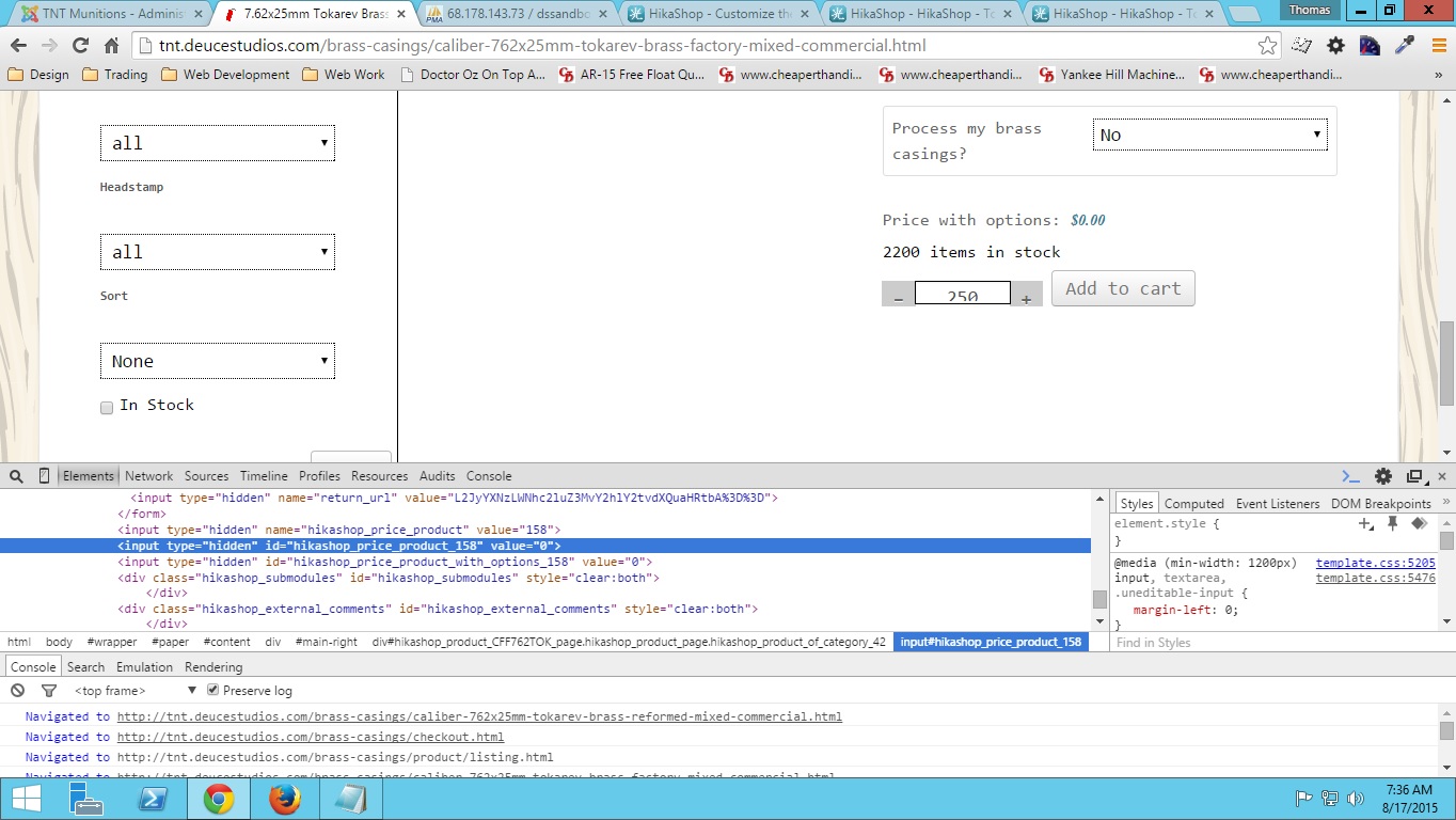

edit: I just did some digging and I noticed that the input id="hikashop_price_product_158" value="0" (see attached screenshot).
I think this may be part of the problem because I would think the value should = 0.12. Am I wrong?
For some reason the appropriate unit price is not in that input's value. Sorry to be such a bother but I really need to figure out a way to make this work and update based on quantity and option. Your help is greatly appreciated.

Why is it if($price->price_min_quantity<=1)? This is the reason I'm getting 0 as a value for the input I mentioned earlier in this thread. For this product all values of $price->price_min_quantity are greater than 1. They are 250, 500, 1000. Maybe I'm just missing something here though.

As I said, the system uses the unit price. As you didn't enter any on your product, you get that result.
Add a new price line with a min qty of 1 in your product and you'll see that the system will take it.
If you want to change the code there to use another price_min_quantity, you can do it, but again, the system isn't made to update the base price when you change the quantity of the product, so even though it might be a bit better it won't be perfect on your website with the way your products are configured.
