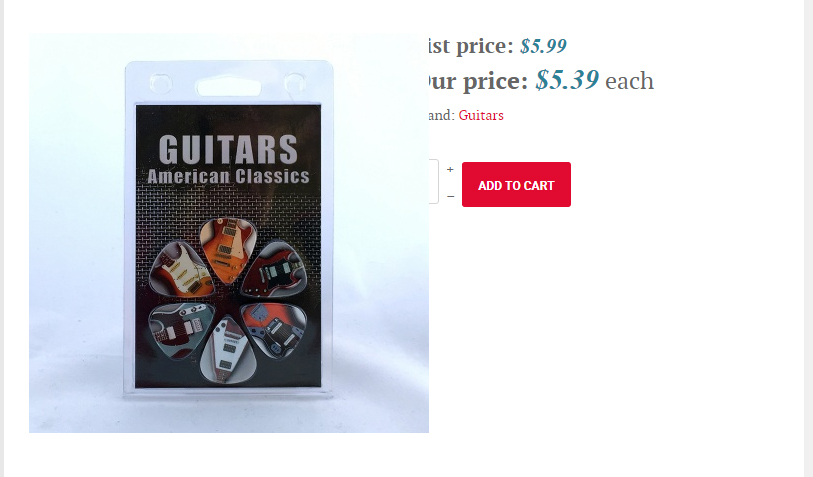

product img div overlaps price-no responsive code?
  • Posts: 24
10 years 10 months ago #212534
-- url of the page with the problem -- : www.hotpicksusa.com
-- Joomla version -- : 3.4.3
Similar is scope to this thread: www.hikashop.com/forum/product-category-...ile-view.html#200027
I am having a very similar issue in the desktop size, until the media size drops to the point the pricing and info falls below the main image. This is because the images are using 400 pixels square as size in the admin as the default.
I have tried every CSS hack and modification I can think of on not only the "display" via the hikashop admin but also the front end stylesheet. I did find where to add some padding on the left side of the pricing div but it only works for the full desktop size. When I look at an iPad in landscape mode, and the column sizes start squeezing together, it would still revert back to overlapping.
Ideally, the best fix for this would be somehow to apply a z-index where the image was set negative and the price div set positive so the price div always remained on top if it overlaps. z-index is obviously coming in to play somewhere because the image overlaps the text.
On the other hand... why aren't the images for the products done per bootstrap? You use one large image, and every screen rendering uses the bootstrap: class="img-responsive" code to re-size on the fly? I need to have my images show up as large as possible at any screen resolution because the products themselves are so small.
Thank you for any help with this!

10 years 10 months ago #212601
If your images are 400px width ; you should modify the product page layout in order to give 400px for the image display.
In that case, displaying the price and the quantity selector might be place below (depending the total width you allow for the global product page).
But yes, if the container is less than 400px width and the image is bigger ; the image will overlaps the container, unless you place a CSS rule like explained in the other thread.

OK, I tried every place in the code possible to make the page display differently by hard coding width=400px in
Product --> show_block_img
Nothing I changed by hardcoding affected the overlap.
Plus a change like this means if I ever have to change the image size in the admin, I would have to remember to change this hard code, and that doesn't seem right.
I am still not understanding why this left DIV holding the image is overlapping the right area. Why is it not pushing the right DIV more to the right? It seems your code was not designed to accommodate images past a certain size? Is there not a way to just change the z-index so if there is overlap, the text on the right always displays over the top of any image? That seems to make the most sense and eliminate any hard coding?

10 years 10 months ago #212906
It not that the default design is not made to accommodate bigger images. It's that the image compared to the width allowed by the layout of the template is too small for the image size you're using and that the template is shifting to responsive only on smaller sizes of screens. So it's not something we can anticipate in HikaShop's code.
What you want is to add such code:
@media (max-width: 1200px){
.row-fluid .span6 {
width: 100%!important;
in order to counter the responsive code of the template which is not adapted to the situation.
Hacking the width of the image on the product page is not a good solution I believe.

  • Posts: 85860
  • Thank you received: 14101
10 years 10 months ago #212939
You can put it in the frontend CSS file yes.
A img-responsive class is not a solution. Suppose that you have an image of 2000*3000px but that you want to display the thumbnail on the product page as a 200*300px image. If you just do it with such class, your browser will have to download the full size image in order to then resize it on display.
What the image size system in HikaShop does is that it creates a smaller version of the original image with the exact size you want to properly fit the space when you have enough space.
That way, the download of the image when the product page is displayed is much faster (which is your first priority on mobile devices).
Then, you can still tell the system to adapt the image width and height with simple CSS. You don't need to modify any view. And in most cases, you don't need any CSS as the image size is ok enough there to fit properly on mobile devices on bootstrap templates.

10 years 10 months ago #213078
I do see the change on your website. On this page:
www.hotpicksusa.com/hotpicksusa/online-s...individual-pick.html
Now, no matter the resolution of my screen, the image never overlaps the text of the right side of the product page.
That was the concern you had as far as I can see.
