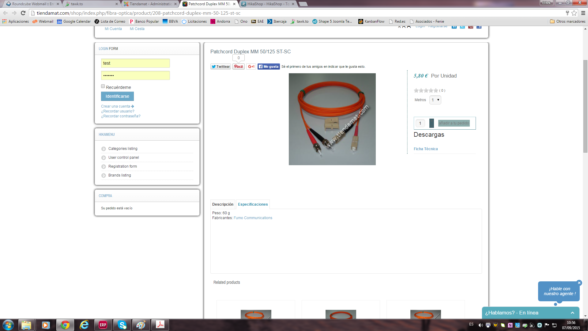

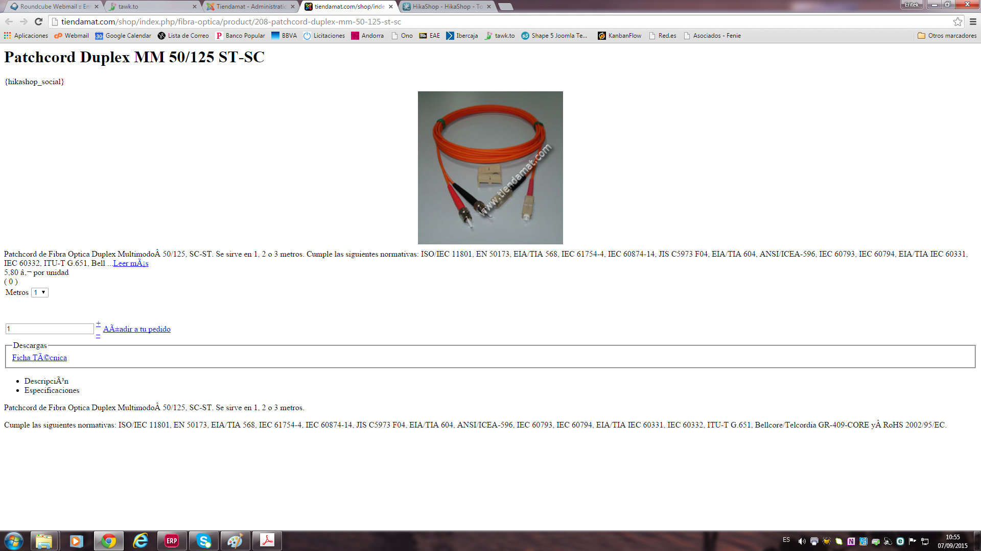

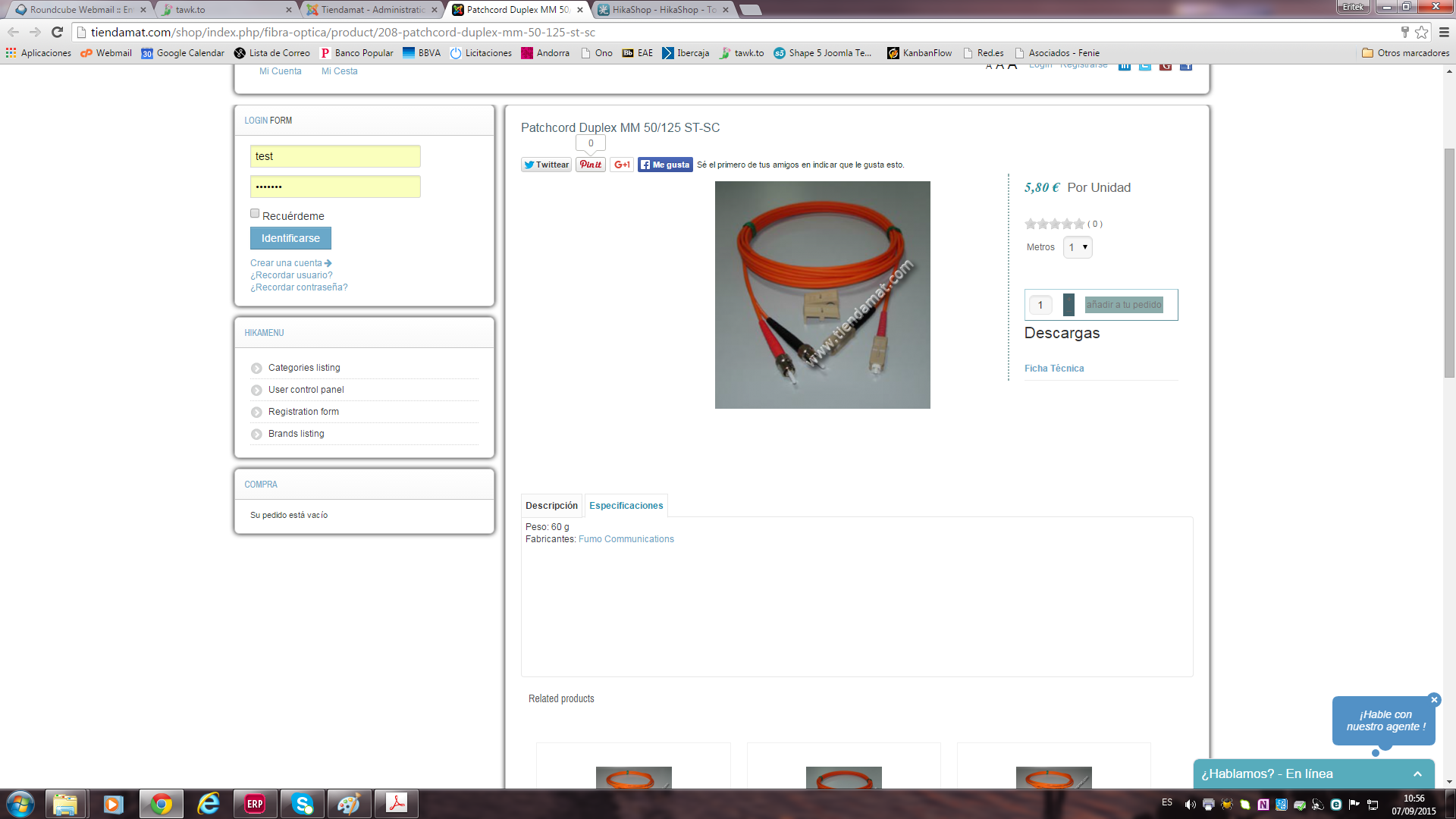

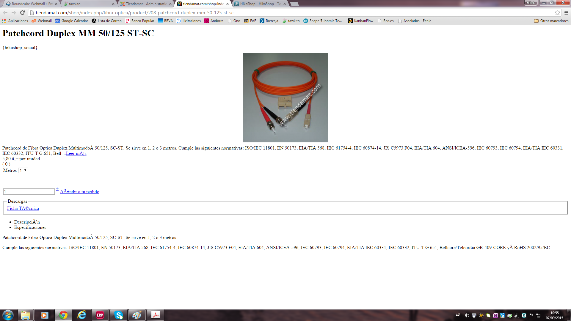

  • Posts: 129
10 years 10 months ago #213478
Hi Nicolas, thank you very much for your help.
Effectively, I was coding the wrong file (didn't realized there was a fil for every template).
So I added the code to the right template, and it completely destroys the template. I attach 2 screenshots, one with the added code, that as you see looks like a mess and there's loads of missing info, and one with the normal appearance without the code.
Any idea why this happens? Thank you.
  • Posts: 85838
  • Thank you received: 14101
10 years 10 months ago #213480
It mean that the code was added in a place of the file which is invalid.
If you turn on the "error reporting" setting of the Joomla configuration, you should get an error message telling you what's worng on the product page.
Also, if you could provide a screenshot of the change you made where exactly in the file, that would help us tell you what is wrong with it.

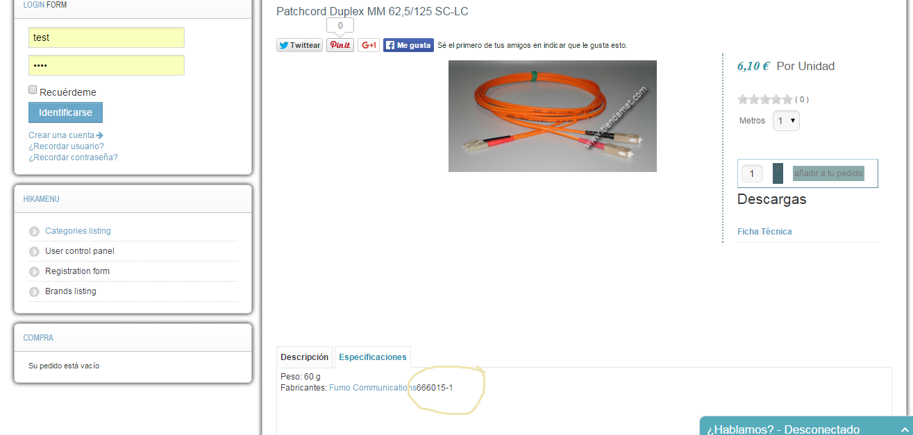

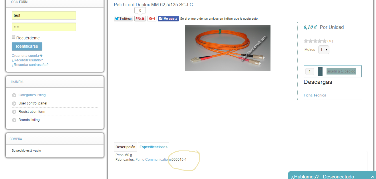

  • Posts: 129
10 years 10 months ago #213640
Thank you Mohamed.
It now appears under the specifications tab, but, as you can see in the image attached, it goes right after the manufacturer instead of going behind. Also, is there a way to put "code number:" before the number?
Thank you.
  • Posts: 26365
  • Thank you received: 4069
10 years 10 months ago #213648
You can put HTML content and use PHP/Joomla to display translated text.
So yes, for sure you can do it.

  • Posts: 85838
10 years 2 months ago #237689
Making it appear on a new line and adding some text before can be done like that:
echo '<br/>code number:'.$this->element->product_code;
The following user(s) said Thank You: vanway
  • Posts: 129
10 years 2 months ago #237774
Worked amazingly.
Thank you very much Nicolas!
