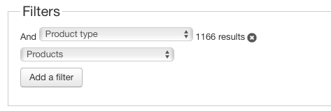

10 years 5 months ago #228834
Hi Jerome,
the 1064 error was over after last Nicolas patch he asked me to install. But now the problem is that the import Mass action only updates products already existing by product_id, but is ignoring the import of new products.
According to a Mass Action filter they are all of the kind "main".
and I checked that both the field definition "product_type" and its value "main" are showing in the exported CSV.
so this information may get lost in the Mass Action Import operation,
