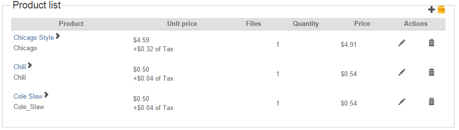

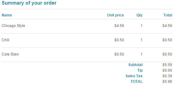

We have the option "Group options with product" enabled. During checkout, it shows up fine. However, in the confirmation email and in the backend, the options show up as individual products. Hence it is sometimes difficult to know to which product they belong.

We upgraded to the newest version (2.5) but while options are grouped during checkout, they still show up as single products in the backend and email (see attachments).
