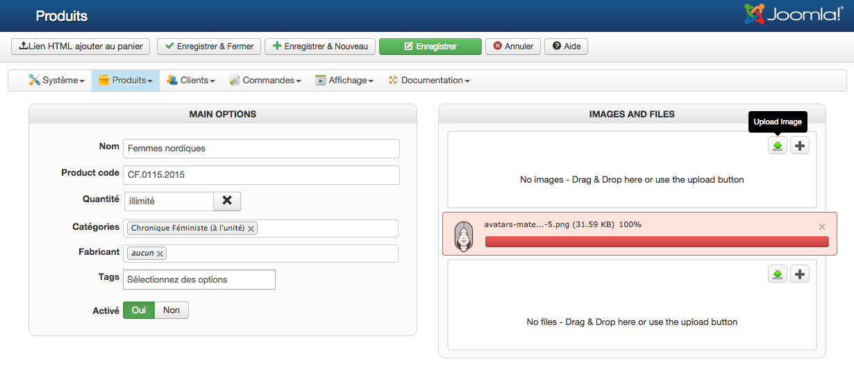

As you can see on the image of my screen : impossible to upload or drag&drop a product image.
The statut bar stay red and nothing happens.
This problem appears since I update Hikashop to the last version.
I have no problem if I choose an image which is already on the server ("add file" option).
I have no problem for category image.
Thanks a lot for your help

In order to avoid such kind of issue, the next HikaShop release will display the error message in the red box ; but with the current release, you need to open the browser inspector to get the content returned by the Ajax upload.
We know that it is not simple ; that's why we worked on some improvements to directly display an understandable error message in the red box.

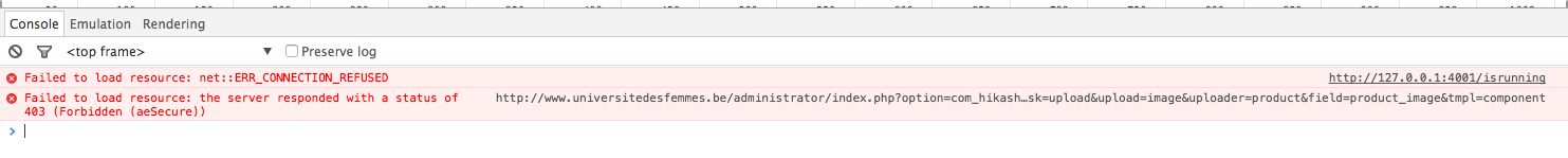

I'm having the same problem, here is the error message I see in my console. I cannot upload from the front end or the administrator portal:

I recreated my problem (uploading new image to my product) and the error message in the browser inspector is :
- Failed to load resource: the server responded with a status of 403 (Forbidden (aeSecure))
Could you please consider that Aesecure (a secure and optimisation application www.aesecure.com/en/ ) was already installed on my server before I upgrade to HikaShop 2.5 and I had no problem to upload images.
Thanks for your help.
Céline
