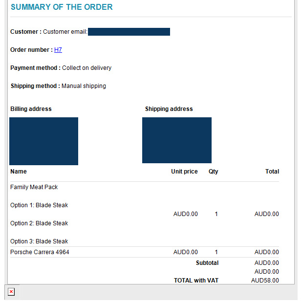

I've now got everything working the way I want but for some reason the prices aren't showing in the emails that are sent to the customer and the shop owner.
As you can see the only time the price is displayed is for the grand total and not the unit price or the unit total. Is there another setting that I need to change or is there something I haven't configured yet? This is the 1st time I've seen Hikashop do this before. Any ideas whats going on?
  • Posts: 26384
  • Thank you received: 4077
10 years 11 months ago #214899
What is your HikaShop version number ?
Do you have overrides for that email ?
  • Posts: 43
10 years 11 months ago #215016
I've got no overrides as far as I'm aware.
I downloaded and installed the free version of HikaShop 2.5.0 and then got HikaShop Essential: 2.5.0 and installed that over the top of the free version. The free version was installed using the sample data as this is set up as a testing environment before I put it onto my client's website.
  • Posts: 86106
  • Thank you received: 14207
10 years 11 months ago #215096
That's strange.
Just in case, try to download again the 2.5.0 install package via the menu My account>My subscriptions on our website and install it on yours.
Maybe that will fix that.
If not, please provide a backend access with a link to this thread via our contact form so that we can check your settings.
