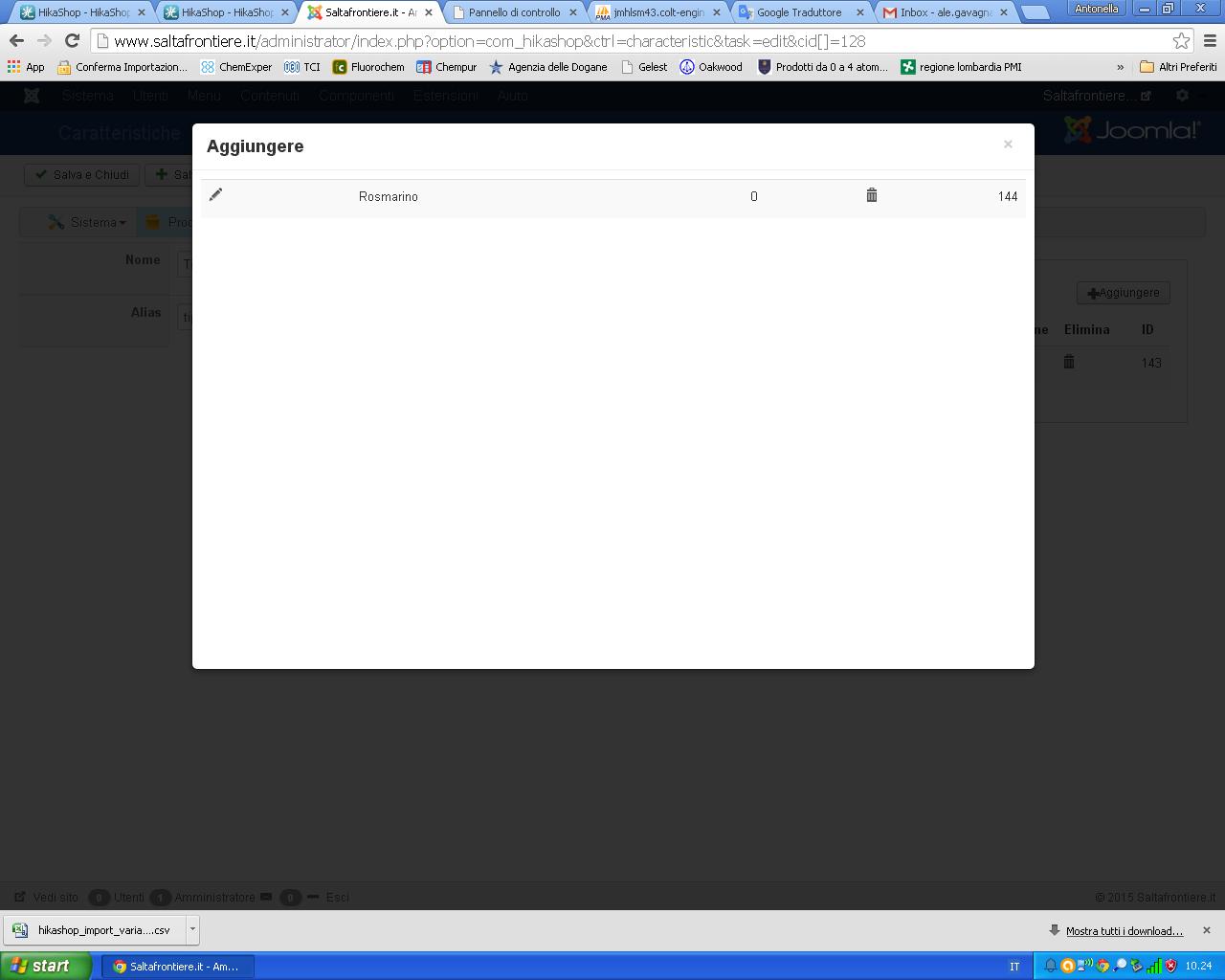

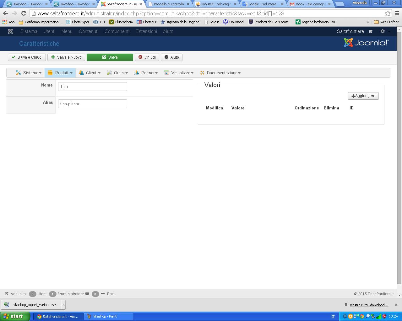

Good morning,
I can't insert values in the characteristics.
I press add, fill out the field, press ok and it remains on the value page like you can see in the attached hikashop.jpg. The Only option left is pressing x but like this it doesn't add any values like in the attached hikashop01.jpg
Thanks in advance
Alessandro
PS. my version of Hikashop is 2.3.0

  • Posts: 86106
  • Thank you received: 14207
10 years 10 months ago #217075
Well that's normal in that case. HikaShop 2.3.0 is not compatible with Joomla 3.4.4.
If you update Joomla but not the extensions, it's normal that the extensions start to break at some point.
That's because we need to adapt our code to the modifications Joomla does with the new versions.
So the solution is simple. Update your HikaShop and it will work.
