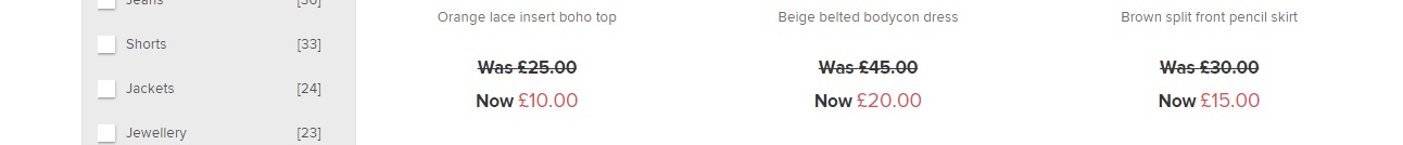

Hi everyone.
Is it possible to tweak hikashop in such way to get this on the products ? (see attachment

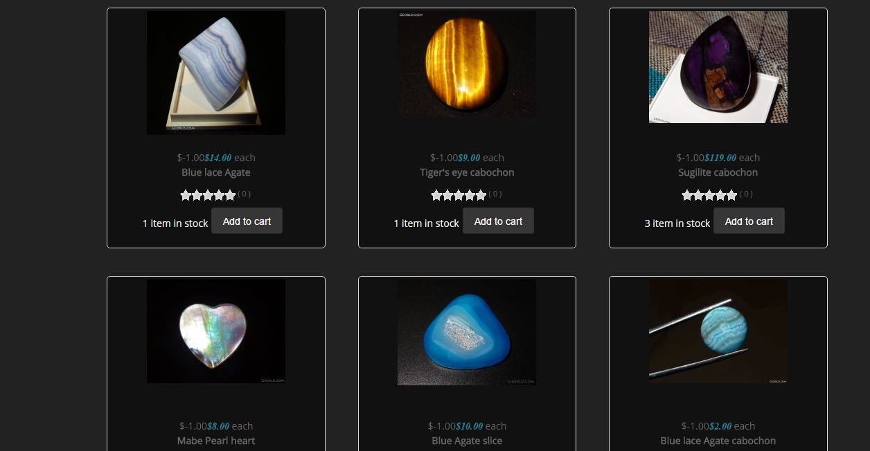

Where is this option in the configuration ? I found the setting "Show discounted price" but no matter which option I choose I get this nonsense: $-1.00 and then the price of the item exactly next to the discount, for example: $-1.00 5.99$.

I found those settings and I did change the discount tab to all the available options. This is what I get
10 years 10 months ago #217715
You should check that you went to the good product listing menu's configuration page, because setting the "Discount" option to "Display the price before the discount is applied" should have done the job.

I only use one menu for hikashop, and I did the change on the option that particular menu. :side:
10 years 10 months ago #217842
That's weird, changing the value of that option SHOULD do the job, can you give me a link to the page where you are having your issue so that I can check it and give you the ID of the module/menu to edit ?

Sure no problem. However I dont have the discount on because it works on all products on the whole website which is unwanted. Would it be possible to apply different discounts on different items?
Here is the link. Any category you click has the same issue: www.georld.com/store
