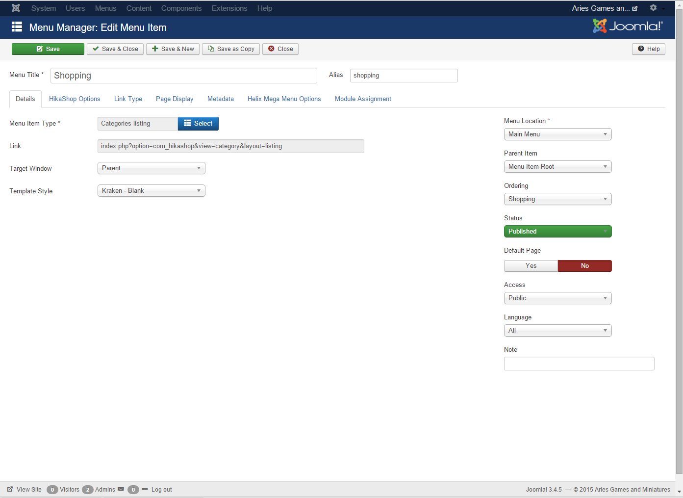

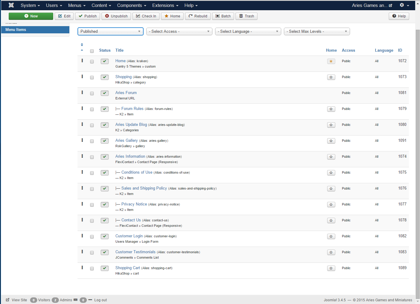

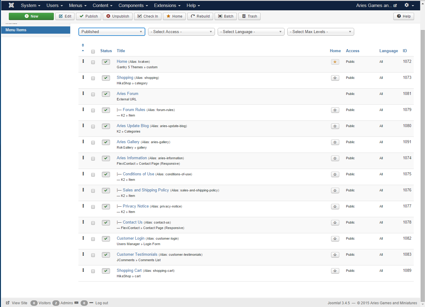

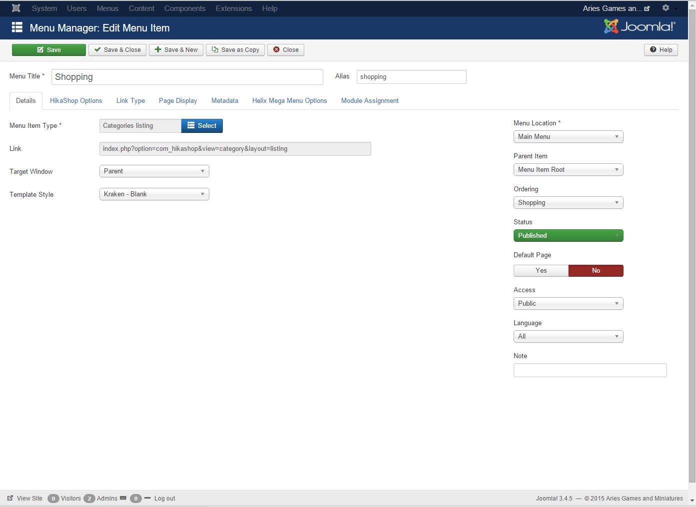

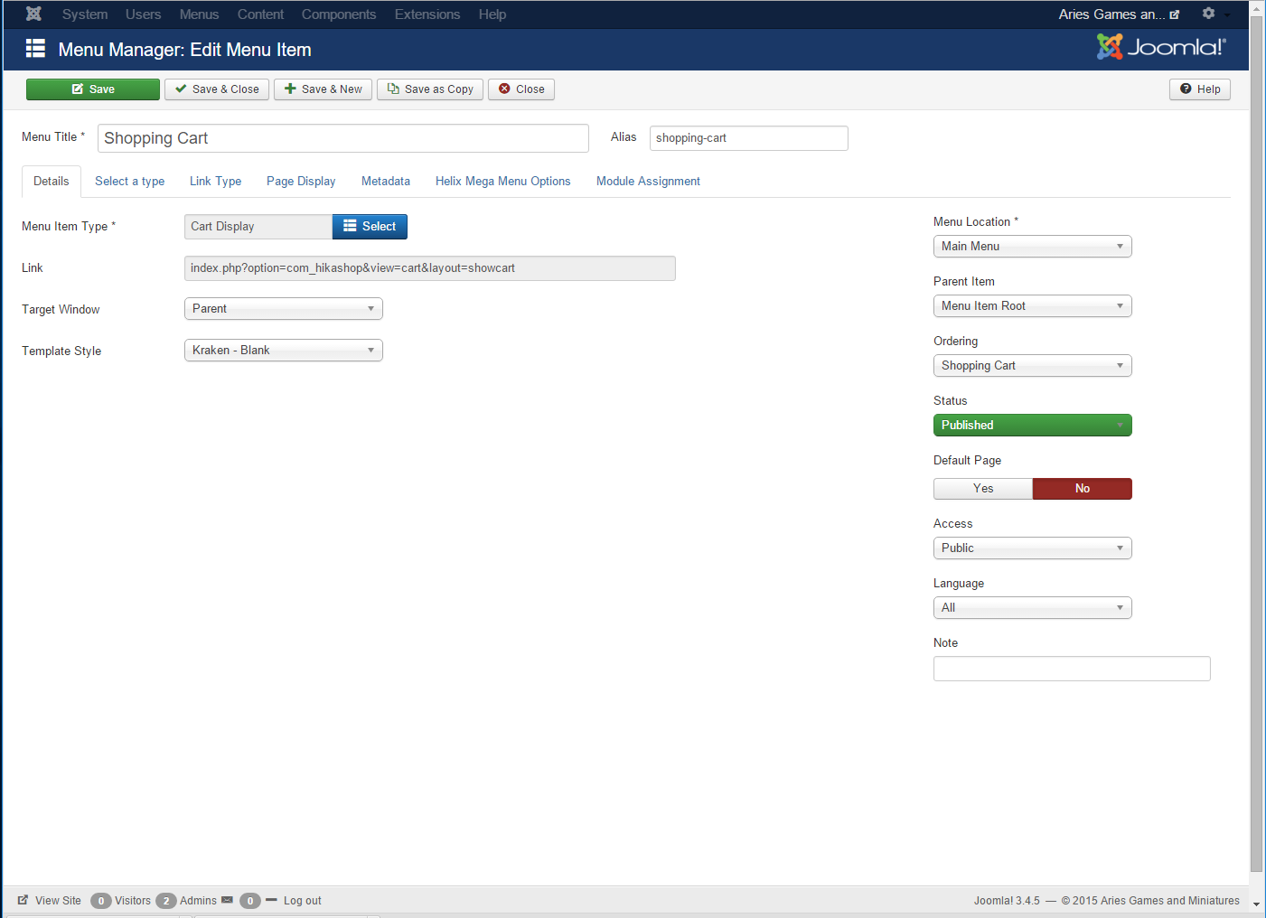

Just to be helpful, here's some images of the menu & their details page.
  • Posts: 86106
  • Thank you received: 14207
10 years 10 months ago #219228
As I said, delete that menu item and recreate it with the same settings and that should work.

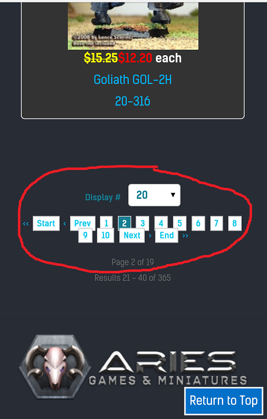

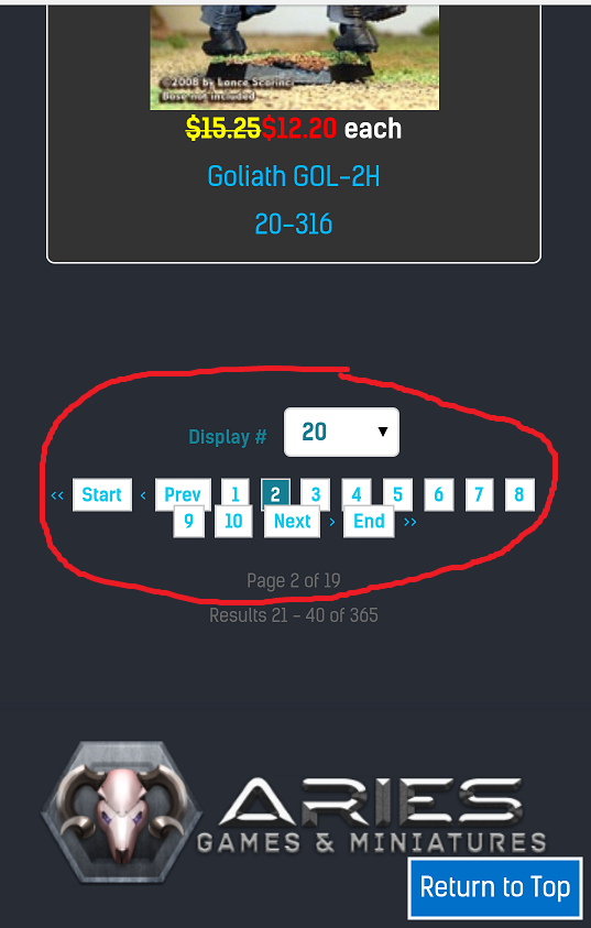

One more quick question...I just enabled the Bootstrap option so the responsive theme would work with Hikashop...and I have another display issue on MOBILE only. Website using a computer works fine, but the mobile aspect of it is off a bit.
Please see the attached image, the display issue is circled in red. How can I space that out a bit so the buttons are not on top of each other?
  • Posts: 86106
10 years 10 months ago #219657
You can add such CSS in order to avoid the problem:
.hikashop_products_pagination .list-footer a.pagenav, .hikashop_subcategories_pagination .list-footer a.pagenav {
line-height: 30px;

10 years 10 months ago #219768
Awesome! That worked Nicolas...thank you!
