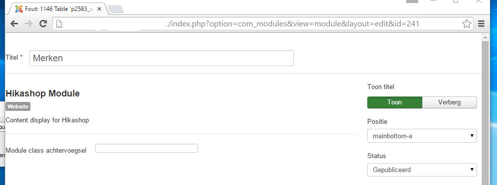

Hi there, we have the same problem :(
What was the solution? So we can fix it ;)
Attached a print screen how the module looks like, after you click the Save button.
Thank you very much!

10 years 9 months ago #220684
Please check that in the file "administrator/components/com_hikashop/views/modules/view.html.php" in the function "options()" you have the code:
		if($this->type == 'manufacturer')
			$this->type = 'category';
After:
		if(isset($this->element['content_type']))
			$this->type = $this->element['content_type'];
		elseif(isset($module->hikashop_params['content_type']))
			$this->type = $module->hikashop_params['content_type'];
		else
			$this->type = 'product';

10 years 9 months ago #220714
Hi Xavier,
The solution works :)
