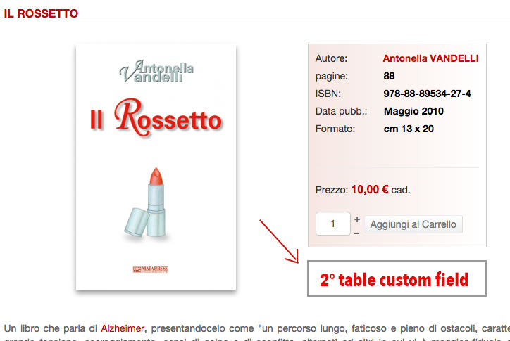

I wish to add a second table with other custom field after the "add to cart" button, out of the first right table.
Any help would be appreciated.
Thank you

I read the page indicated and I think that makes my case show_bolck_product_files, because I want to show a link of the book in ebook format to download, but if I add a custom field appears inside the tablella right, I want to appear to outside and under the right table.
Thank you
