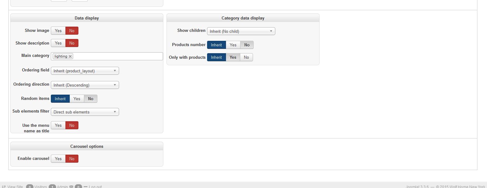

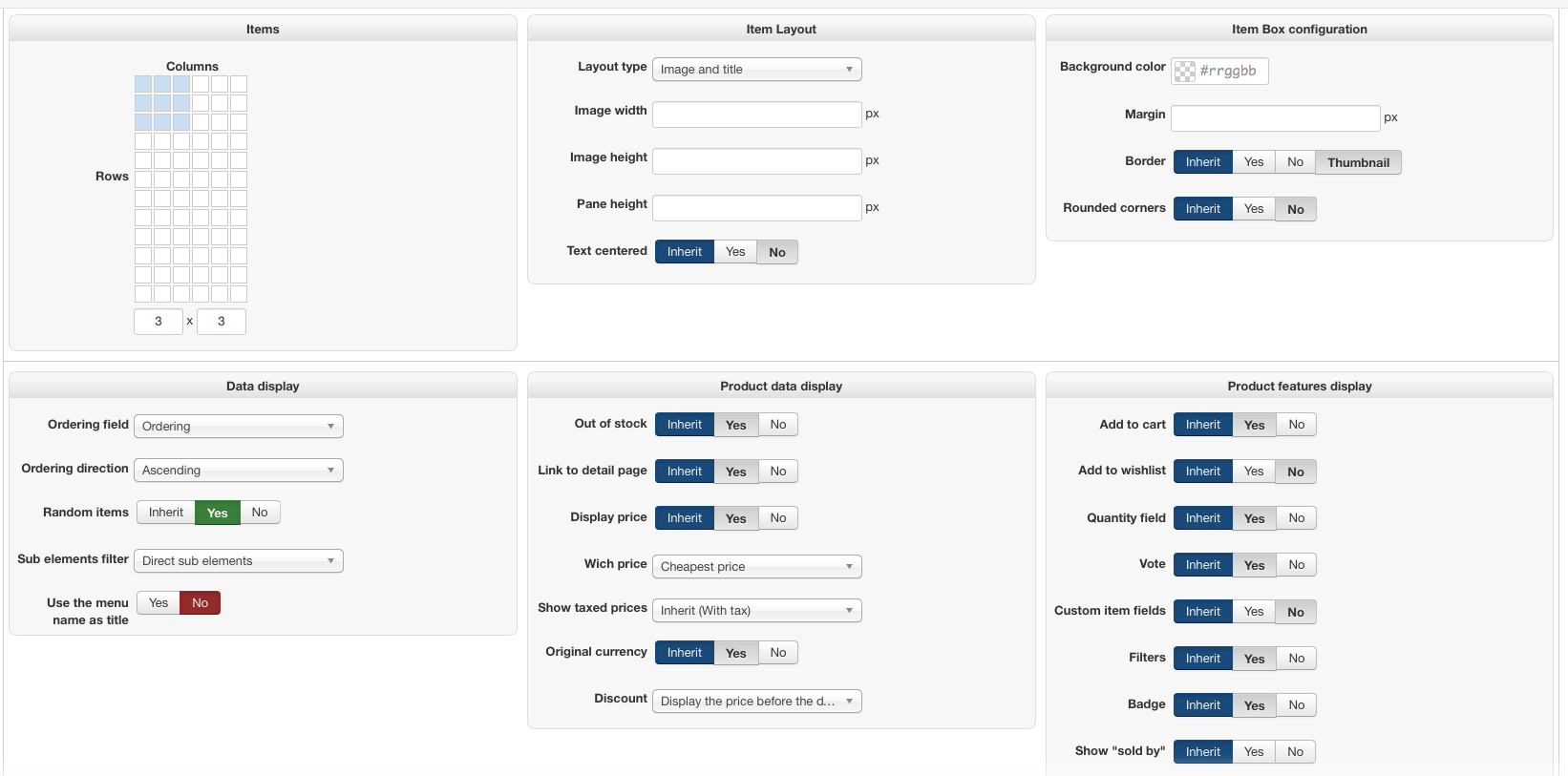

10 years 9 months ago #221139
Please give us a screenshot of your menu settings under the "category options" and "product options" tabs.
@Konstantin1996: This time it is the FTP access which is not working ;)
Last edit: 10 years 9 months ago by Xavier.

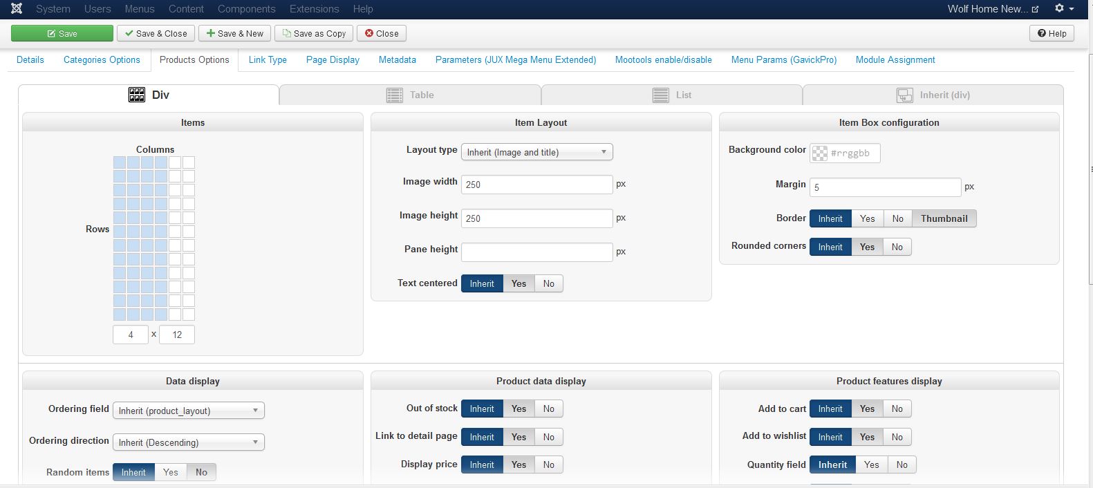

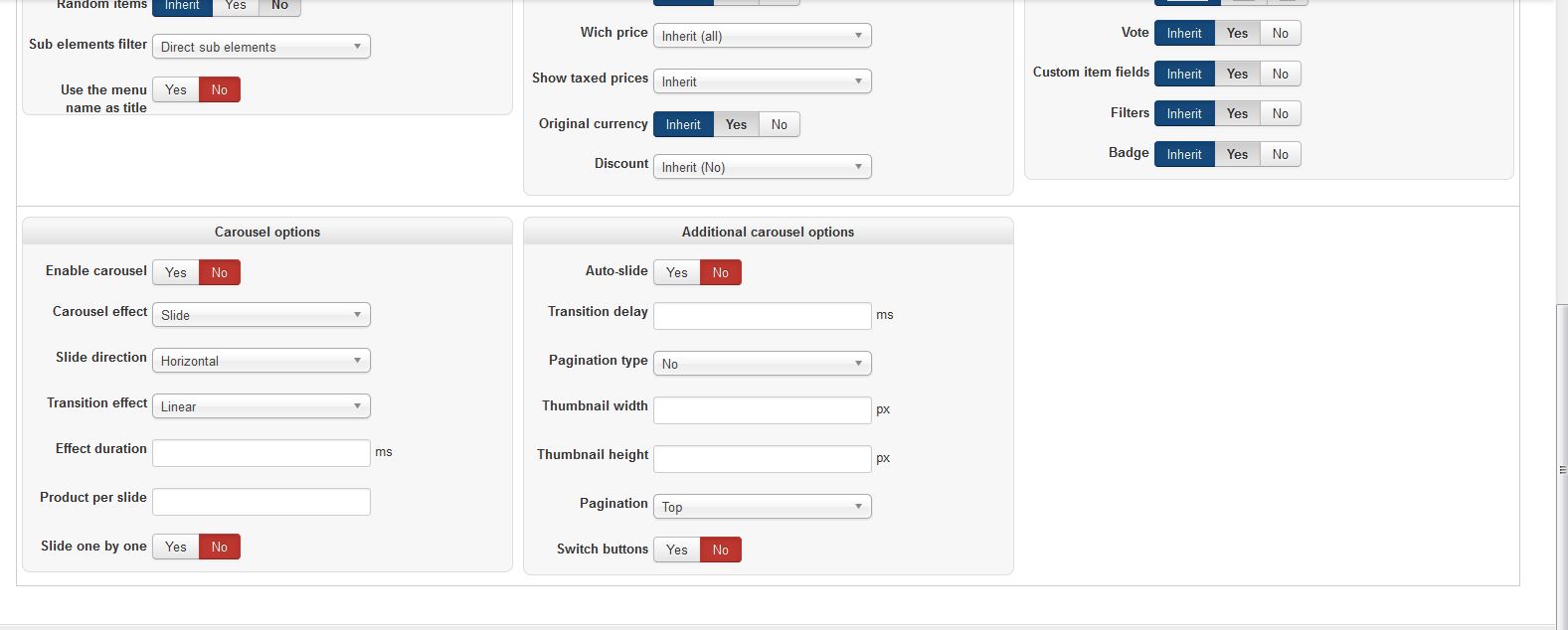

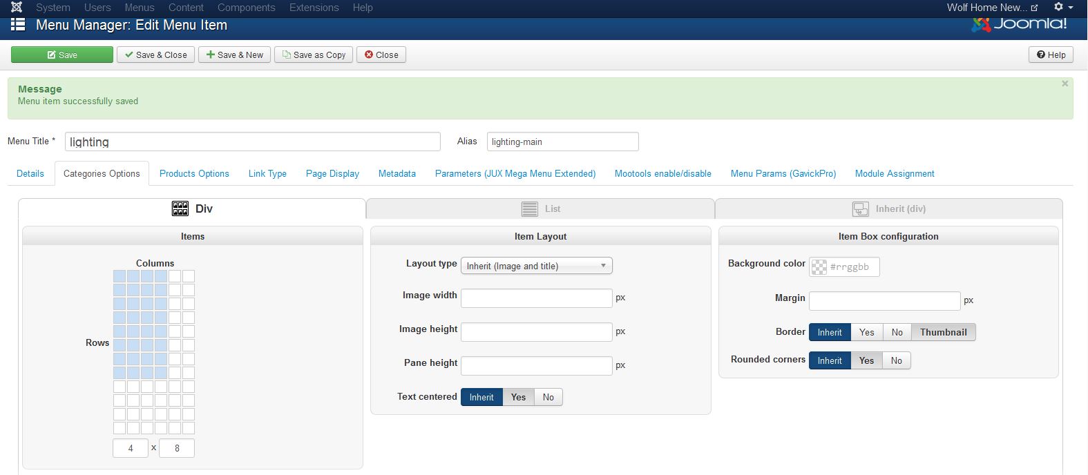

  • Posts: 29
10 years 9 months ago #221253
screenshots attached
