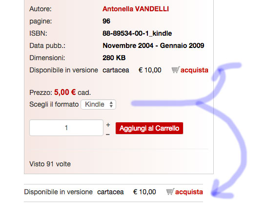

I created the characteristic and it works, but I've customized the page and now when i choose the type of book I've a double customized.
url: matarreseditore.it/index.php/ciao-bella-eb
I'd like to add the icons before the text "PDF, Kindle, ePub".
Last edit: 10 years 8 months ago by leonte54.
10 years 7 months ago #226047
You can edit the view "product / show" and replace the line:
if(!empty($this->fields)) {
By:
if(!empty($this->fields) && $variant_name != 'name') {

Could you kindly explain what happens when I select the radio button of the variants?
When I enter the page: matarreseditore.it/index.php/ebooks/p/ciao-bella-eb the view is correct, the problem occurs when I choose the variant.
I tried to go back to the starting code knows "product / show_block_characteristic.php
if ($ this-> params-> get ('characteristic_display')! = 'list') {
echo $ this-> characteristic-> displayFE ($ this-> element, $ this-> params). '</ div>';
return;
but I can not find the file where to make changes
thanks
  • Posts: 86106
  • Thank you received: 14206
10 years 7 months ago #226674
When you change the variant selected, there is some javascript code (from administrator/components/com_hikashop/types/characteristic.php) which will copy the HTML of the different blocks of the new variant (these hidden blocks of data on the page are generated from the show file of the product view) to the main blocks of the product page layout (these blocks of layout are generated from the show_default or show_tabular or show_reverse file of the product view).

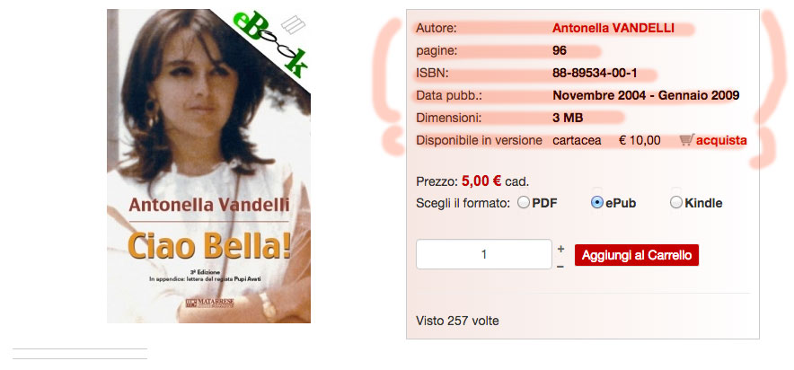

10 years 7 months ago #226802
these are the steps to change to get the double table right below the main, I think I did not duplicate anything that was not necessary.
1) - I created a custom field named "variante";
2) - I tried to follow these tips on the topic: www.hikashop.com/forum/product-category-...m-field-product.html
For example, suppose that the field that you want to display separately is called "test", you could add the line:
if($fieldName == 'test') continue;
after the line:
foreach ($this->itemFields as $fieldName => $oneExtraField) {
in show_block_custom_item in order to skip the display of that field in show_block_custom_item.
And then you could copy past the code of that file in show_default and change the line:
to:
if($fieldName != 'test') continue;
in the file "show_block_custom_item" I get no change but in the file "show_block_custom_main" I get what I need.
3) - I duplicated the file "show_block_custom_main" and I called it "show_block_custom_main2", I added in the file "show_block_custom_main"
foreach ($this->fields as $fieldName => $oneExtraField) {
if($fieldName == 'versione') continue;
and in the file "show_block_custom_main2"
if($fieldName != 'versione') continue;
4) - In the file product / show_default after the first right table I added
<!-- inizio seconda tabella di destra -->
<div id="hikashop_product_right_part2" class="hikashop_product_right_part2 <?php echo HK_GRID_COL_6; ?>">
   <!-- inizio campi personalizzati -->
	<?php
	if(!empty($this->fields)){
		$this->setLayout('show_block_custom_main2');
		echo $this->loadTemplate();
    <!-- fine campi personalizzati -->
      </div>
<!-- fine seconda tabella di destra -->
so everything works great. (see image "variante1.jpg")

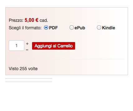

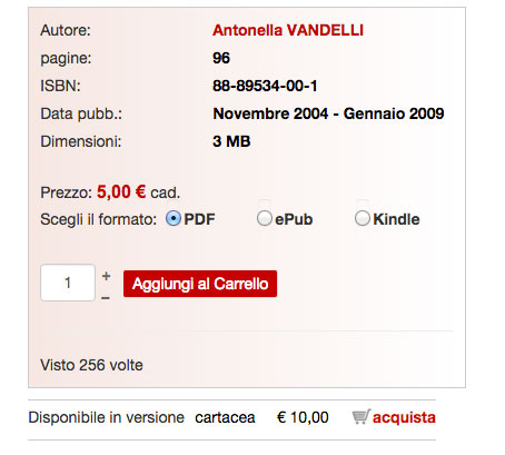

5) - if in the files 'show_block_custom_main' and 'show_block_custom_main2' disable code
<?php //echo $this->fieldsClass->getFieldName($oneExtraField);?>
and
<?php //echo $this->fieldsClass->show($oneExtraField,$value); ?>
rightly I get disabling 2 custom blocks (see image variante2.jpg)
6) - if custom blocks are disabled, if I choose a variant, why I visualize all blocks? (see image variante3.jpg).
I hope for your help
thank you
