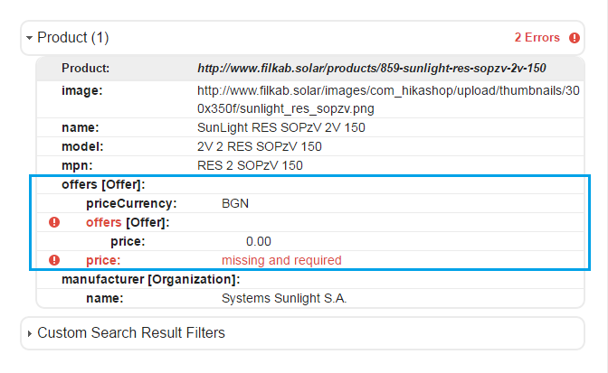

  • Posts: 52
10 years 5 months ago #233835
Dear Xavier,
The code provided in your previous post generates another mistake - the first exclamation mark on the attached screenshot.
If I only leave the rows:
<span itemprop="price" style="display: none;">
    0.00
  </span>
then there is no mistake and the price is set to zero.
Your solution fixes the error but the price is still not correct.
I was hoping that there is a way to "dismiss" the whole offers [Offer] part when I have no price set (the blue rectangular on the attached screenshot.
10 years 5 months ago #233896
So to remove the whole offers part you can remove the HTML code:
<span id="hikashop_product_price_main" class="hikashop_product_price_main" > ... </span> [code] In the view "product / show_default" when there is no price. That way the plugin will not add any microdata for the price.[code]
</span>
  • Posts: 52
10 years 5 months ago #233974
Hi Xavier,
Thank you very much for all your help but I need a little more assistance please. I thought I can modify the code by myself but apparently I'm doing something wrong.
This is the code I added and when testing with Google structured data testing tool the error is still present:
<?php
	if (!empty($this->element->prices)) {
	<span id="hikashop_product_price_main" class="hikashop_product_price_main">
		<?php
		if ($this->params->get('show_price')) {
			$this->row = & $this->element;
			echo $this->loadTemplate();
	</span>
	<?php } ?>
Last edit: 10 years 5 months ago by ydingilski.

  • Posts: 52
10 years 5 months ago #234118
Hi Xavier,
I finally made it work :blink: I'll explain more details just for reference of other people on the forum.
1. Like Xavier said you have to use the correct view. I thought the code should be added in the "product / show_default" view but i was totally wrong. Modify the code in the view you use.
2. This is the code to cut off "offers" microdata when the product has no price for "product / show_tabular" view, plus adding contact button for price request in that case:
<?php
		<?php
	</span>
	<?php } else {
	echo $this->cart->displayButton(JText :: _('CONTACT_US_FOR_INFO'), 'contact_us', $params, hikashop_completeLink('product&task=contact&cid=' . $this->element->product_id.$url_itemid), 'window.location=\'' . hikashop_completeLink('product&task=contact&cid=' . $this->element->product_id.$url_itemid) . '\';return false;');
	<br />
3. Unfortunately another problem occured. I had additional microdata attributes added in the end of the file, right after the hikashop_product_bottom_part div (read the whole topic):
<div id="hikashop_product_bottom_part" class="hikashop_product_bottom_part show_tabular">
</div>
<div>
	<span hidden itemprop="name"><?php echo $this->element->product_page_title; ?></span>
	<span hidden itemprop="model"><?php echo $this->element->product_model; ?></span>
	<span hidden itemprop="mpn"><?php echo $this->element->product_mpn; ?></span>
	<span hidden itemprop="manufacturer"><?php echo $this->element->product_microdata_manufacturer; ?></span>
</div>
The problem is that when the product has no price the rest of the additional attributes are also gone. If I move the div with the additional microdata attributes anywhere after the first code, the one for cutting off the "offers"microdata, another problem arises. It would be either for the products with prices or for the products without prices. Or for both of them.
To fix that I had to move the additional microdata attributes div just before the code for cutting off the "offers"microdata:
<div>
	</div>
	<?php
		<?php
	</span>
	<?php } else {
	<br />
I don't know what was the problem. I didn't have time to spend on it and even if I had maybe I wouldn't find out. :whistle:
Once again this code is for "product / show_tabular" view. Attached is my working file if someone want to dig into it.
