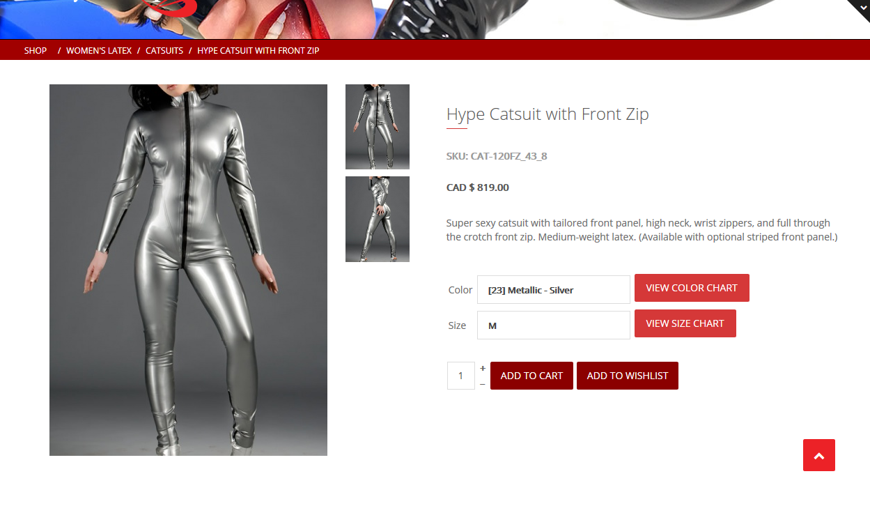

Ok,so I have many different variants.ie:Colors, sizes,patterns, etc...

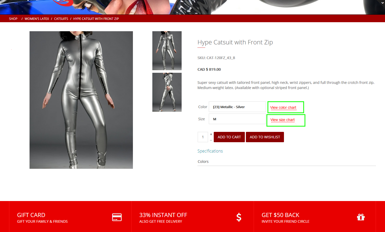

What I attempting to do is add a link right after the variant selectbox. And that link is in the module and when clicked opens custom modal. So , in other words the link and modal is all contained in the module I'm trying to load conditionally.
So I need to editing/customize the products/show_block_characteristics
All I want to do is get the variants field label value (ie.: Colors.Sizes,etc) and using a switch statement load the corresponding module after the selectbox .
I included a screenshot, as it will will be obvious to see what I'm trying to do.
I was thinking of just adding a switch statement to load the corresponding module.
Example only - so variables might not be correct.

The buttons I'm using might get edited, but it works !
(c.f: attachment)
