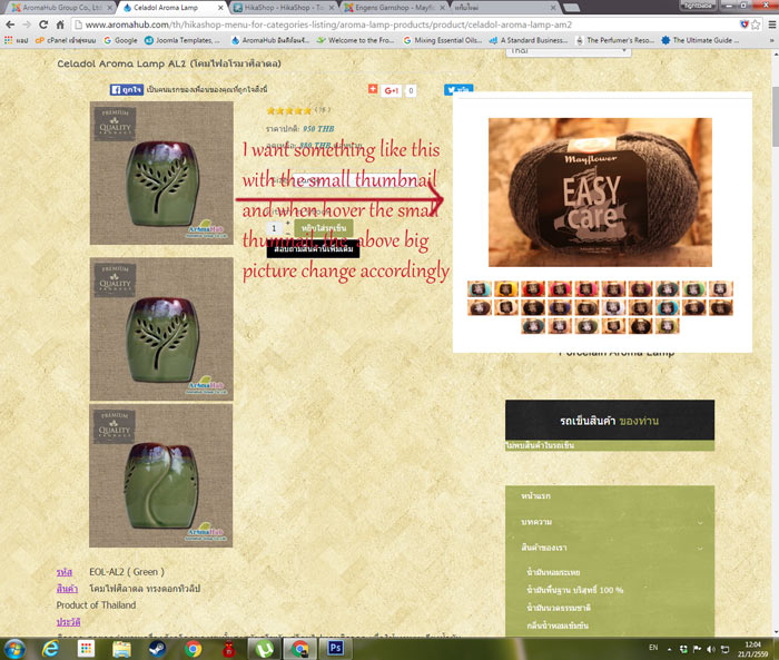

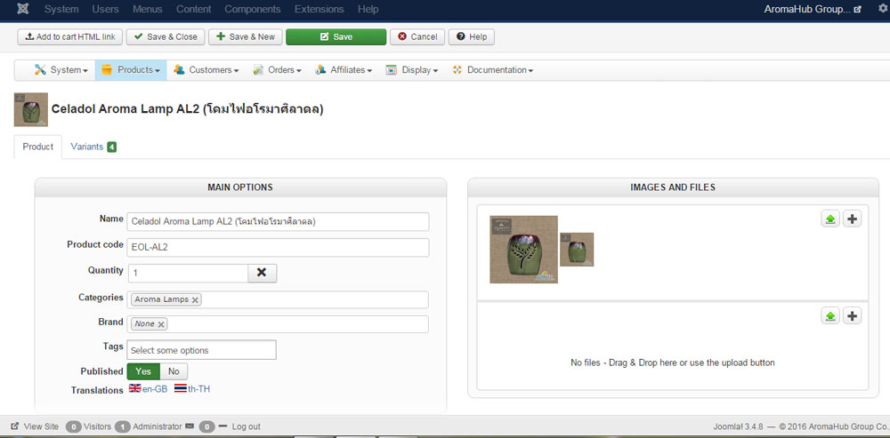

Dear sir
I want to have more than one product picture on the product page.But when I upload 2 pictures in the back-end ( see the attached Back-End image). It display the 2 pictures vertical instead of display 1 big picture with the small thumbnail under the big picture (See the attached Front-end image). I also want the big picture change accordingly when we hover the mouse over the underneath small thumbnail . How to fix the problem? Did I make something wrong?
Thank you very much
  • Posts: 19
10 years 7 months ago #227153
I have tested by changing the default template(Shape5) to Beez (Joomla template), It work fine , it show the small thumbnail correctly. As I am not a coder>
I would be appreciated if you could give me suggestion ,how to fix this issue.
Thanks again
10 years 7 months ago #227176
As you can see by yourself by changing your template your wrong display is link to your template, and so unfortunately I can only say to contact your template creator.
