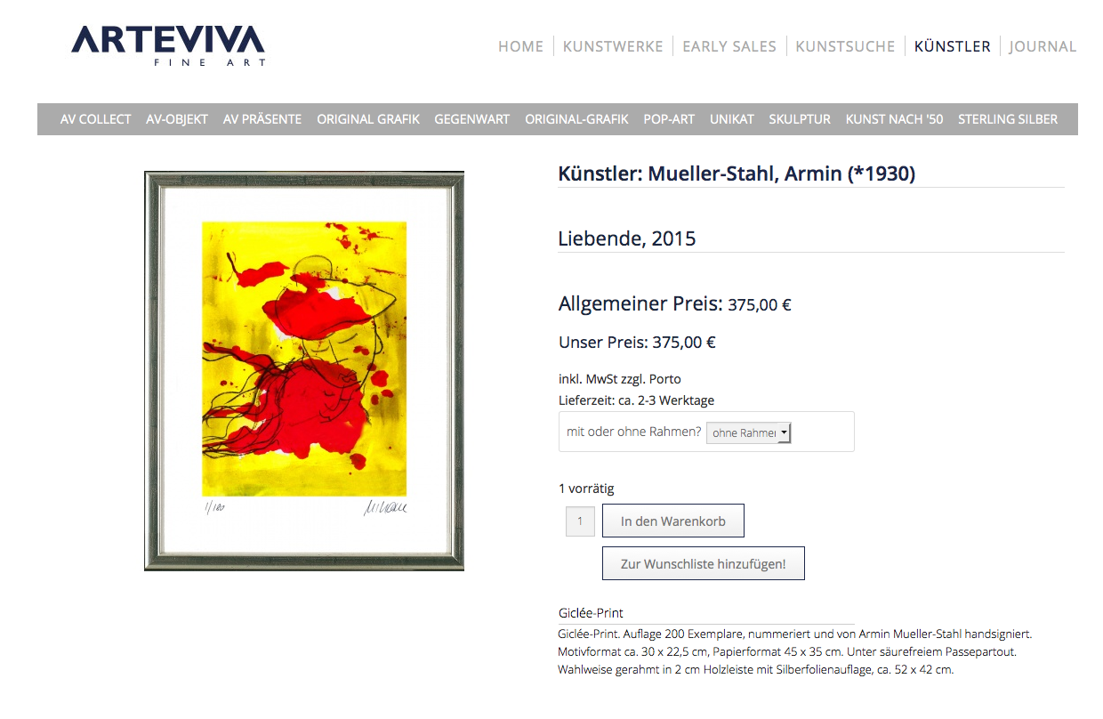

Thanks, I got the Variants going but noticed my main problem is the Variant does not switch. On the following Link:
s553057611.online.de/av-2016/kuenstler/p...t/136-liebende,-2015
I have with or without frame option on the Variants but it doesnt switch the price. On changing to Protostar it changes. Its a Super Helix Template and I allready had similar problems with the Payment redirecting ( Sofort Payment Method Thread ).
You managed to fix that, how did it go again?
Thanks in advance.
Wolfram

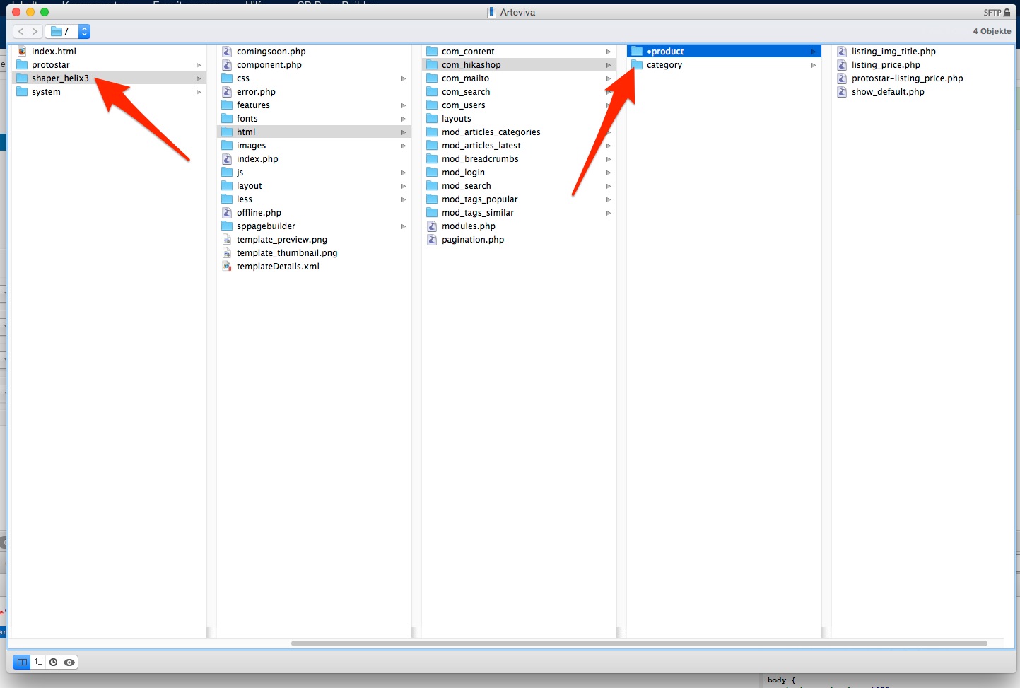

  • Posts: 5
10 years 7 months ago #229561
Well Helix told me they dont deal with 3rd party Plugins. Sorry I didnt get by reanaming my template by ftp will help?
The error i get from the Console is:
ReferenceError: hikashopUpdateVariant is not defined
<!DOCTYPE html>
Last edit: 10 years 6 months ago by immagine. Reason: More Information
  • Posts: 86105
  • Thank you received: 14206
10 years 6 months ago #229570
Well, the issue is that the problem is in a file of their template which overrides a HikaShop view. So it's not a problem of 3rd party plugin...
But yes, you can use the FTP method I talked about. That should do it too.
  • Posts: 5
10 years 6 months ago #229642
Well i tried that as well, I feel I am getting closer but renaming didnt change the result.
Any other ideas?
  • Posts: 86105
10 years 6 months ago #229755
The problem is indeed with the template but not in the view overrides.
The problem is that the javascript of the template is broken:
take.ms/RaZNE
Because of that, the hikashopUpdateVariant function of HikaShop is not initialized and because of that, the switch is not happening when you change the dropdown.
From what I can see, the error comes from the javascript code of the template:
take.ms/jTX40
There is a "iif" instead of "if".
You'll have to ask your template provider on how to fix that.
