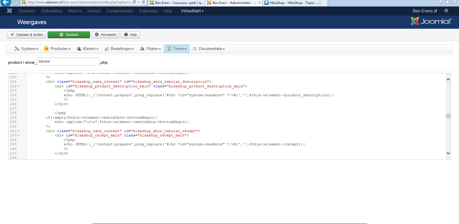

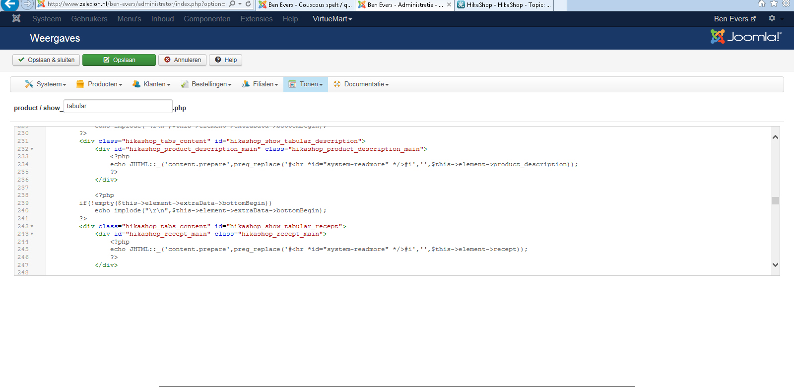

I have created some extra tabs in the show_tabular file.
<li id="hikashop_show_tabular_recept_li" onclick="displayTab('hikashop_show_tabular_recept');"><?php echo JText::_('RECEPT');?></li>
Now i have to link them to the custom fieds i have made.
I've put this code in the tabular file but it's not working:
<div class="hikashop_tabs_content" id="hikashop_show_tabular_recept">
<div id="hikashop_recept_main" class="hikashop_recept_main">
<?php
echo JHTML::_('content.prepare',preg_replace('#<hr *id="system-readmore" */>#i','',$this->element->recept));
</div>
Can someone help me with this?

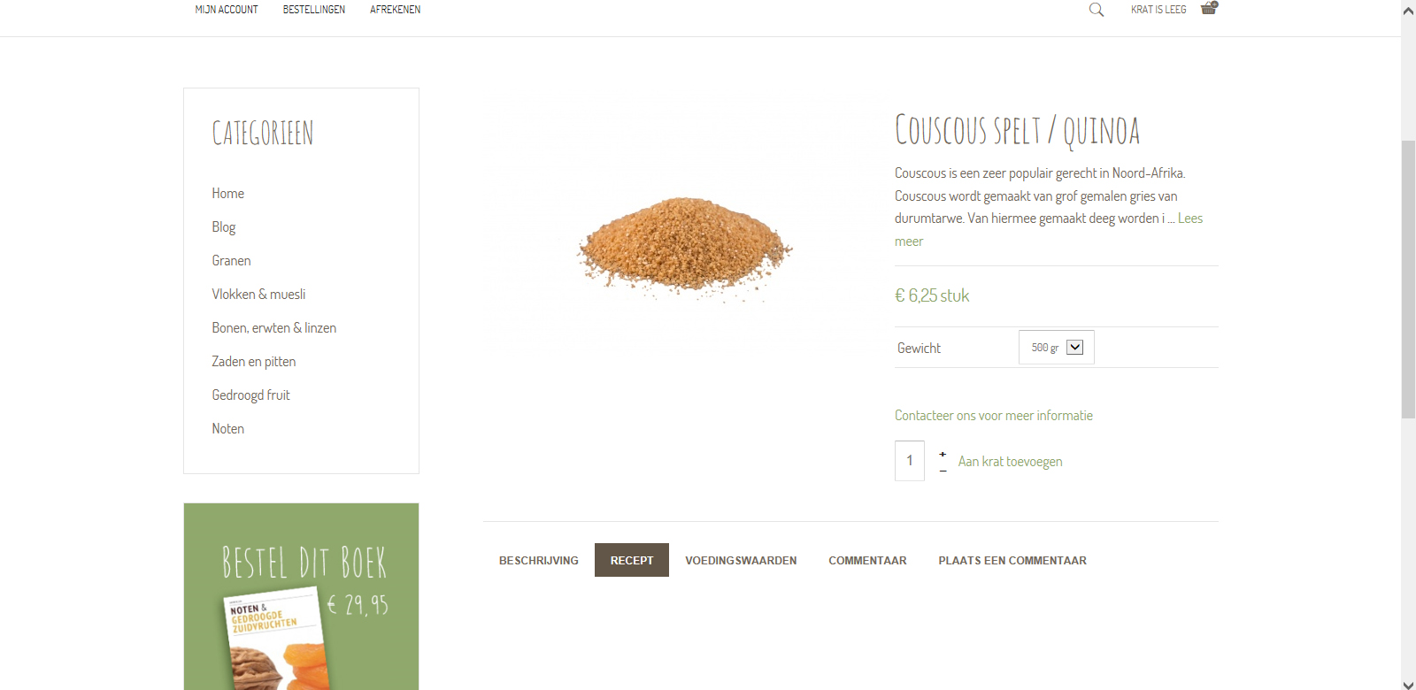

Hi Mohamed,
These are the screenshots. The custom field 'recept' i want to show when you click on the tab 'recept' on the product page.

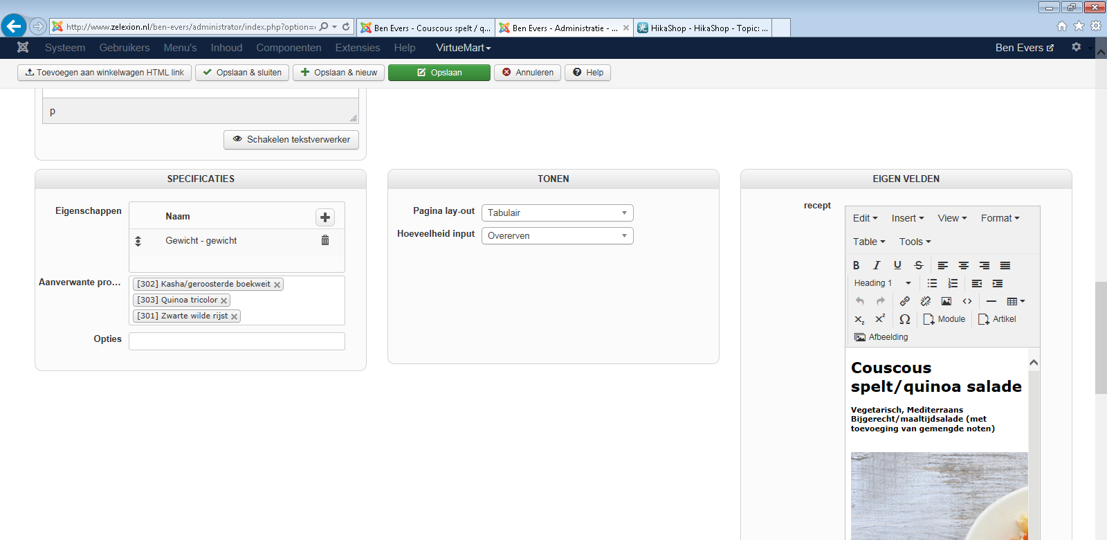

Of course:

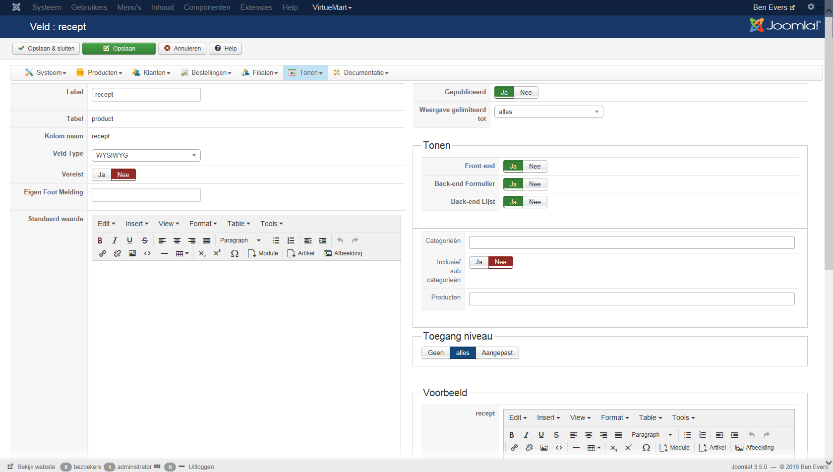

www.zelexion.nl/ben-evers/granen/product/couscous-spelt-kamut
In the attachment the screenshot of the custom field settings.
10 years 6 months ago #235456
by Xavier
Replied by Xavier on topic Show tabular with custom fields
The code seems to be correct, even if it uses an old version of the view.
Could you try to backup your view override and remove it and add the code in the new view code ?

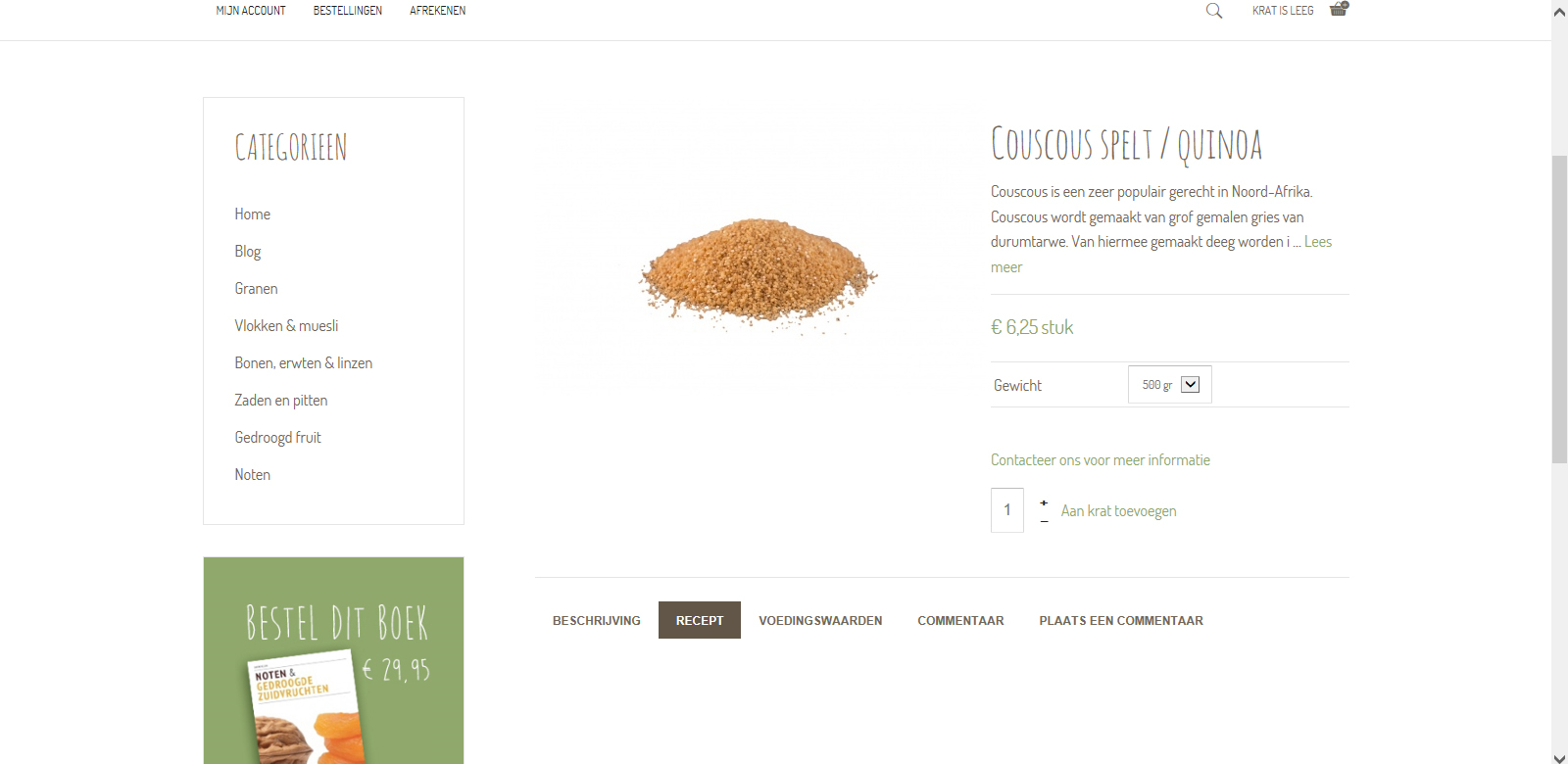

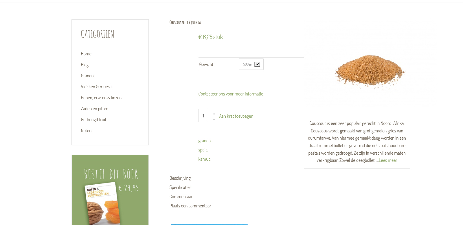

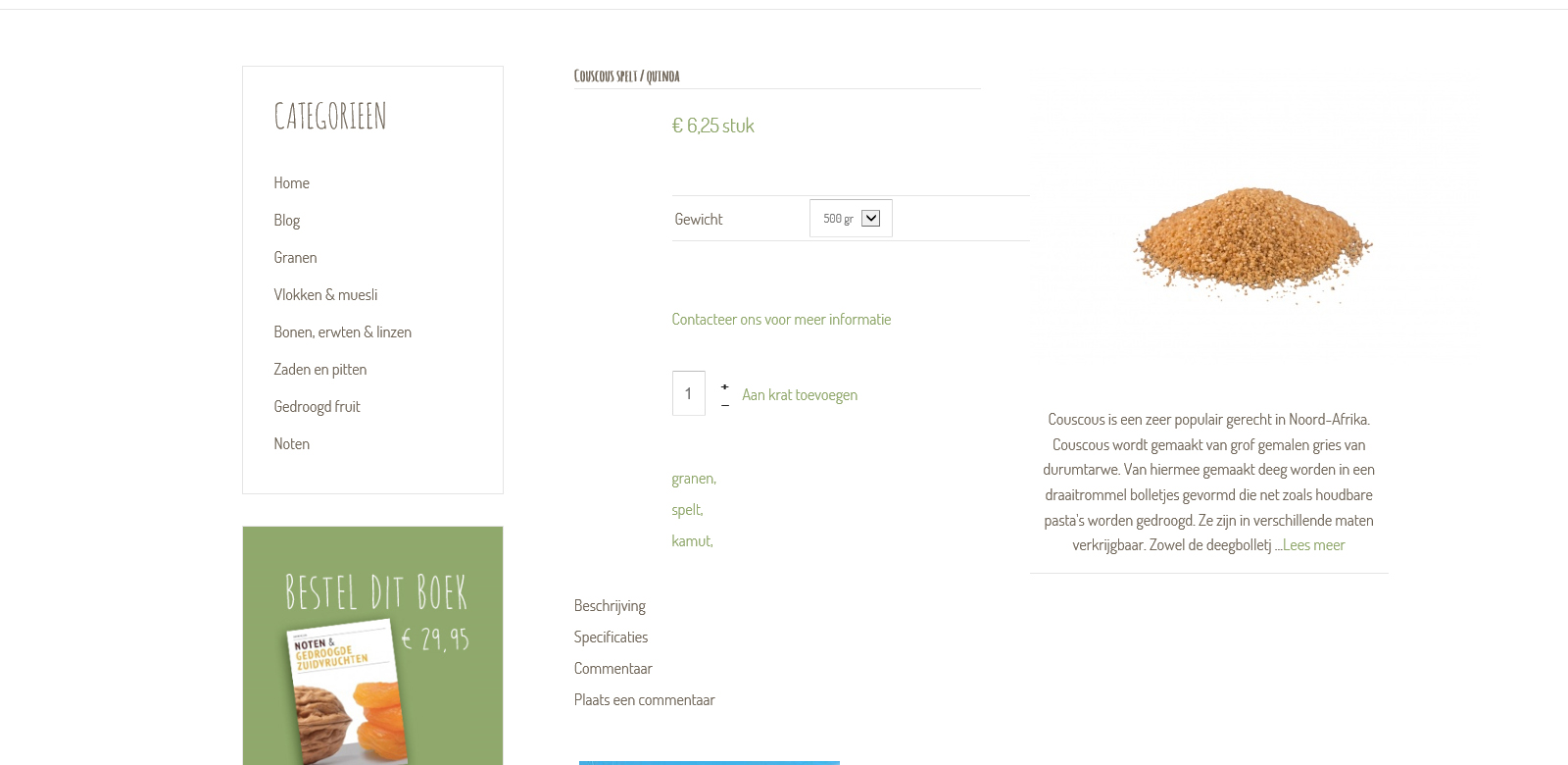

10 years 6 months ago #235844
by nancytoemen
Replied by nancytoemen on topic Show tabular with custom fields
Now i have a much bigger problem. I backed up the show_tabular file and removed it on the server. Then i have published a new show_tabular file and everything looks different. So I copied the backup show_tabular file back where it was but it doesn't work anymore. In the attachements you see the product page before and after.

10 years 6 months ago #236415
by nancytoemen
Hmmm i think you didn't understand my issue. In the attachement you see how the product page looks like before i put the new code you provided in the show_tabular page. The looks of the page where great, but the tabs 'recept' and 'voedingswaarden' didn't work. I have backed up the file show_tabular and removed it from the server but the layout of the product page is a mess now. So i tried to put the backupped file back on the server again but the layout stays the same mess. It has to be as the attachement. So i have 2 problems now. The tabs are not showing (and the custom fields are now at the 'specifications page, this has to be 2 pages with the tabs 'recept' and 'voedingswaarden'). And the looks of the productpage are not what it meant to be (like the attachement).

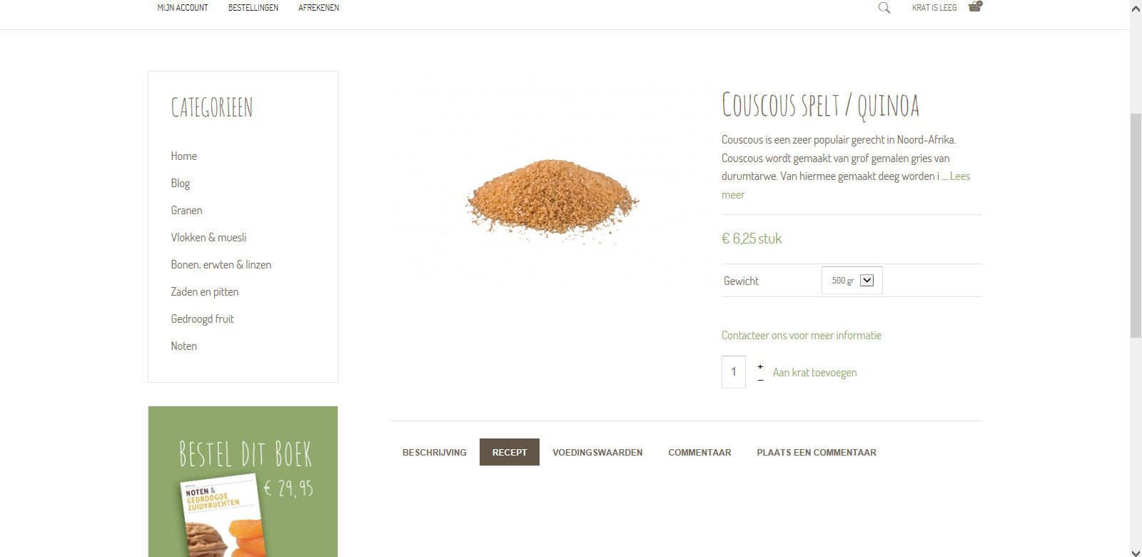

10 years 6 months ago #236462
by Xavier
Problem solved, there was missing css properties.
You potentially changed the value of the option "Front-end CSS File" in Configuration > Display > CSS.
And I added your desired tabs in the show_tabular view.
