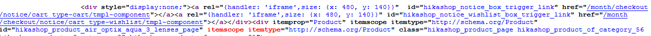

This one div on show_default.php was the problem messing up my layout
<div itemprop="Product" itemscope itemtype=" schema.org/Product " >

Such thing happened if HikaShop Microdata on Product Page plugin is enabled.
I compared product's view show.php and I see that the last version (com_hikashop_business_v2.6.2_2016-04-12_01-31-16) includes itemprop="Product" itemscope itemtype=" schema.org/Product ".
So hikashopproducttag adds second itemprop="Product" itemscope itemtype=" schema.org/Product ".
