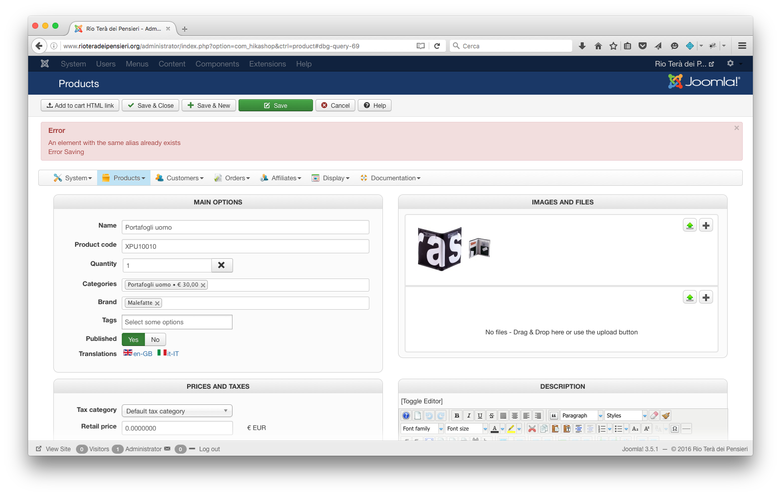

I've a problem whit last Hikashop's version. When I try to save some change on product item. System give me back this error: "Error - An element with the same alias already exists - Error Saving".
In attach a screenshot about this error.
10 years 2 months ago #242856
Can you click on the "Check database" button via "Hikashop->System->Configuration" and test it again after the check is complete ?
Thank you.

  • Posts: 86104
  • Thank you received: 14203
10 years 2 months ago #242941
Then please make sure that the alias you're using in your product is not already used by another product.
It should then work fine.

10 years 2 months ago #243016
Ok, Now it works. It was about alias.
