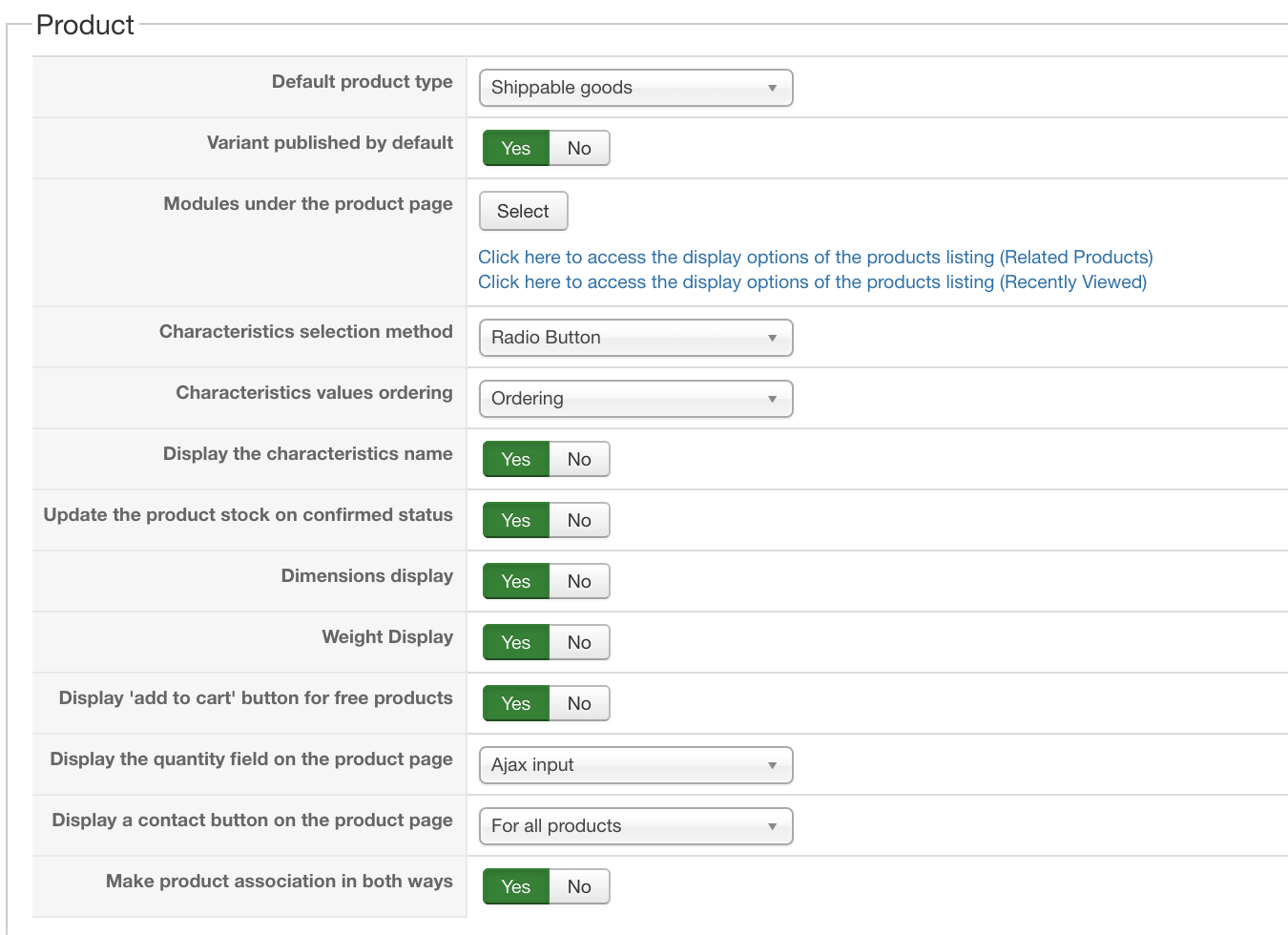

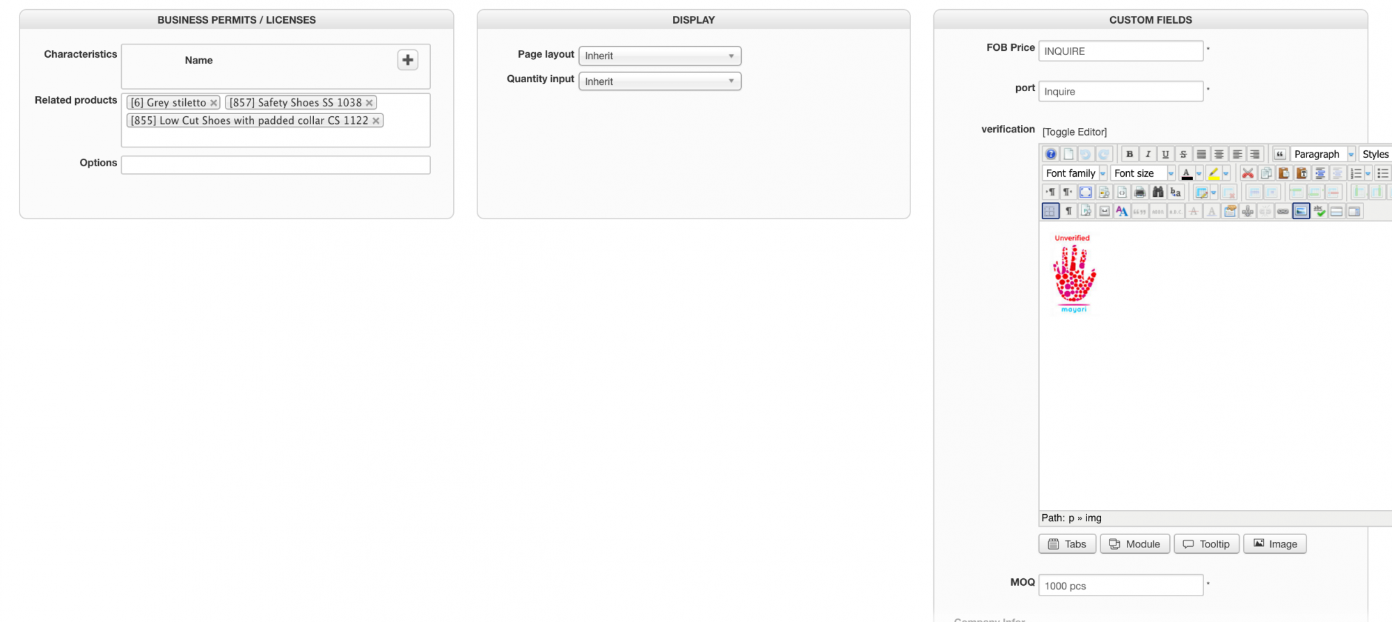

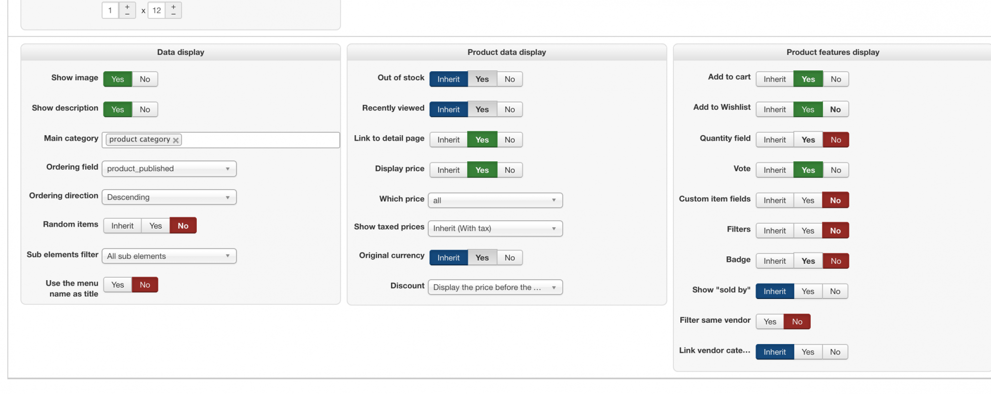

  • Posts: 490

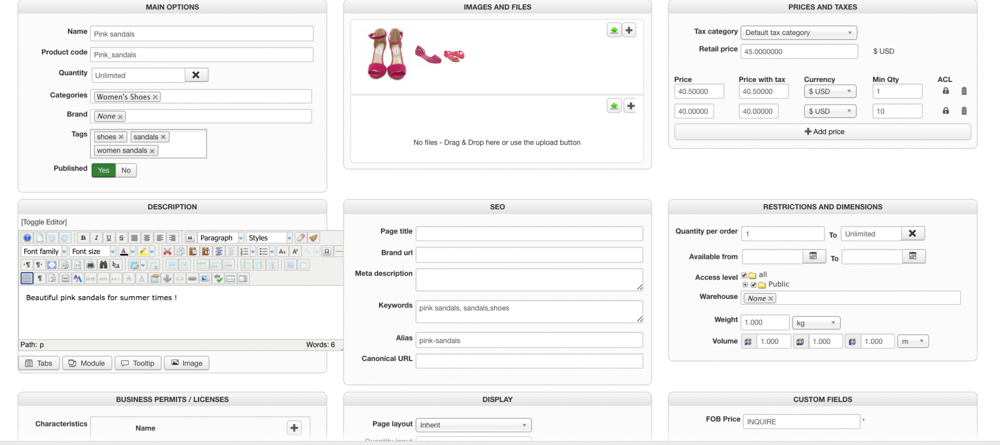

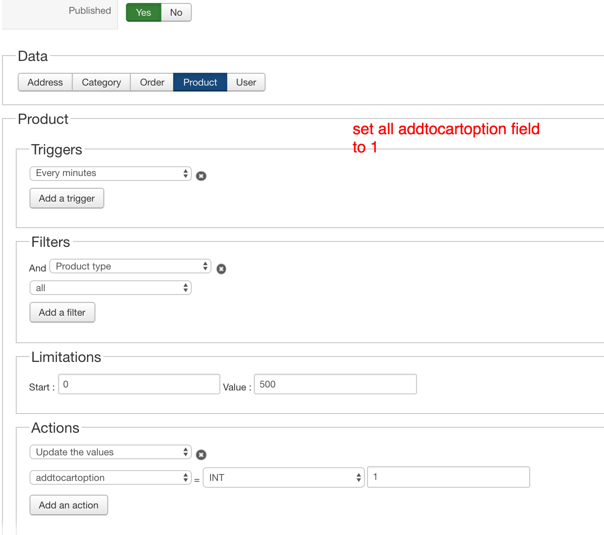

9 years 11 months ago #246446
the code removes both add to cart button and the add to wishlist.
how can we retain add to wish list.
i just want to remove add to cart.
Also how do i update all the values of the other products that has been created before. can i use mass action?
this is my settings. I got it to work but not all products are affected. Do i need to increase the limatations field?
thanks

2. You don't want a trigger or a filter in your mass action. Just have the action, and click on the "proceed" button. Also, note that it will only process the first 500 products you have. So you'll have to change the limitations area to process the other products after that.
The following user(s) said Thank You: ronron

9 years 10 months ago #248304
tried you suggestion but it doesnt work. i remove the changes and used the initial code
this is the link to the page
Part of the message is hidden for the guests. Please log in or register to see it.
this is the settings
thanks again
  • Posts: 26365
  • Thank you received: 4069
9 years 10 months ago #248305
and provide a link to the product page where that doesn't work with a screenshot of the settings of that product ?
You gave information about product listing ; not the product page.

9 years 10 months ago #248433

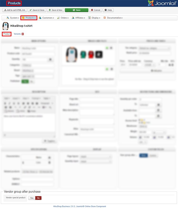

I will guide you, first, Nicolas ask you the product page with the issue, and not the listing page (we understand that maybe the product is among the listing, but the complete product page url will able us to be sure of what we do)
Ex : YOURWEBSITE/store/product/product-name
And for the screenshot of that product, we need this :
Reach it, Components => HikaShop => Products, and click on the product name (with issue) to see his configuration screen.
Awaiting news from you
Last edit: 9 years 10 months ago by Philip.
  • Posts: 490
9 years 10 months ago #248604
oh i see, here it is.

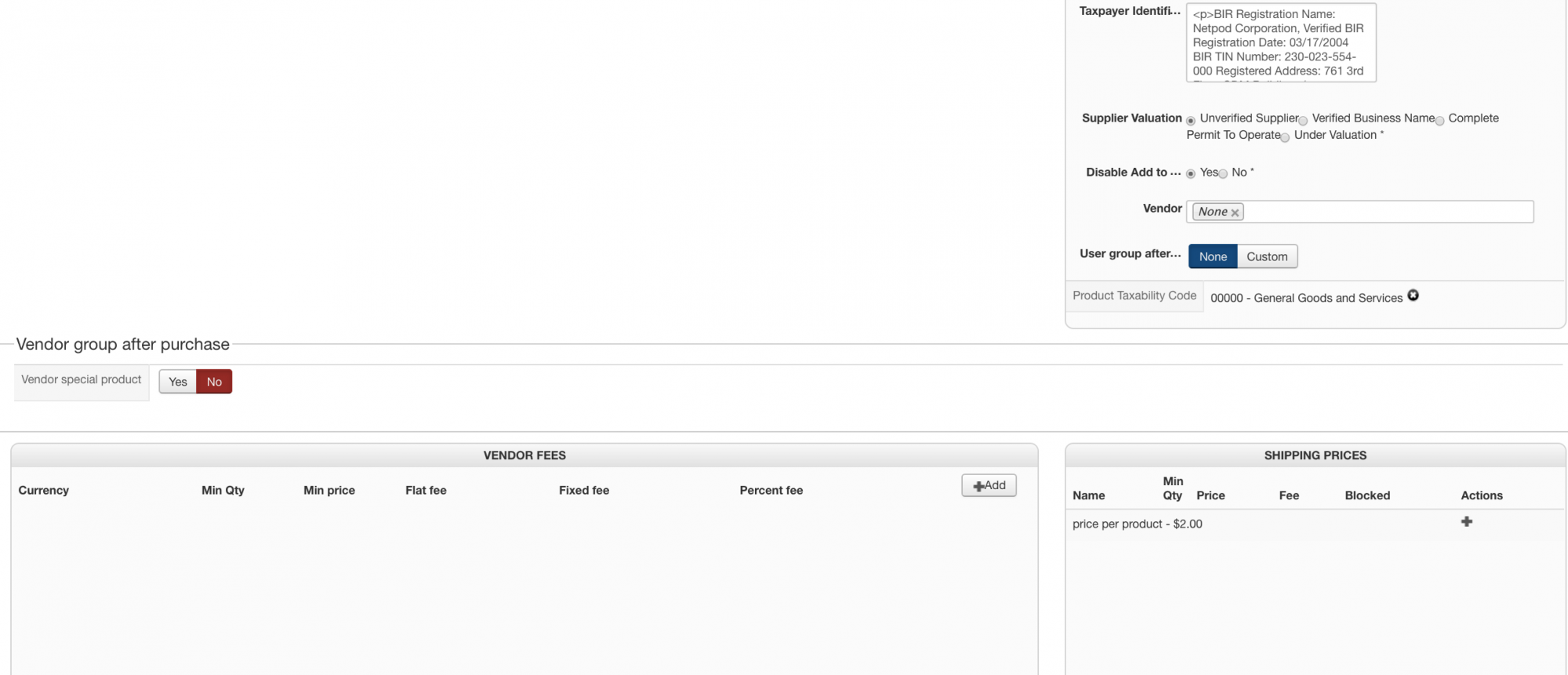

also all products are behaving the same. Both add to cart and wishlist does not appear. Not just one when i use this code
if($this->row->addtocartoption == 1)
$this->params->set('catalogue', 1);
else
$this->params->set('catalogue', 0);
sample product
thanks
  • Posts: 85838
  • Thank you received: 14100
9 years 10 months ago #248677
So I suppose that the problem is that you're not using 1 and 0 as the values of your custom field. Which explains why it never goes in the else of the condition.
Can you provide a screenshot of the settings of your custom field ?
