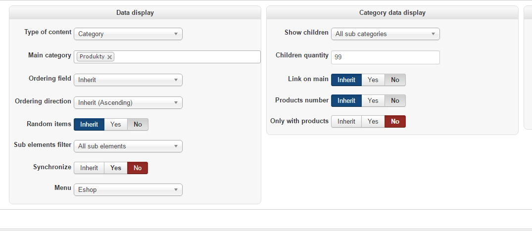

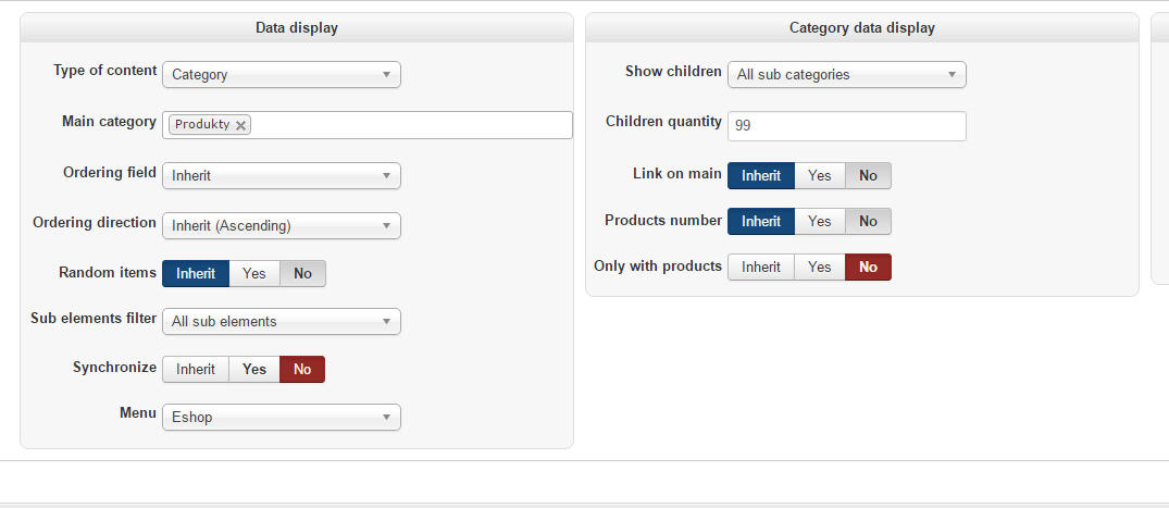

9 years 10 months ago #247857
I can't see the link so I don't know if it's related, but with settings as on screenshot, all children categories are displayed twice.
In file components\com_hikashop\views\category\tmpl\listing_list.php from line 95
$this->rows holds all categories to display.
Each child category is first time displayed in first foreach loop (line 100) and then also in second foreach loop on line 129
