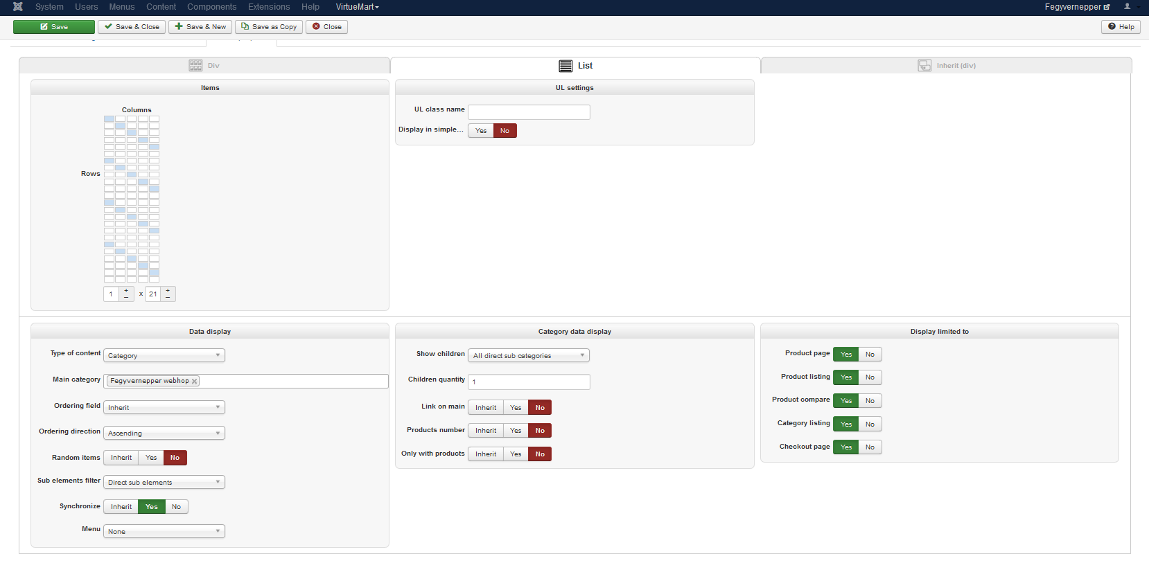

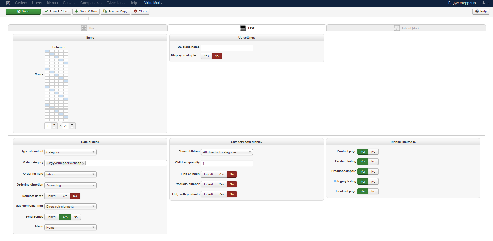

Hard to say as you didn't give a link to the page, nor some examples of the links, nor screenshots of all the settings of the module and associated menu item.

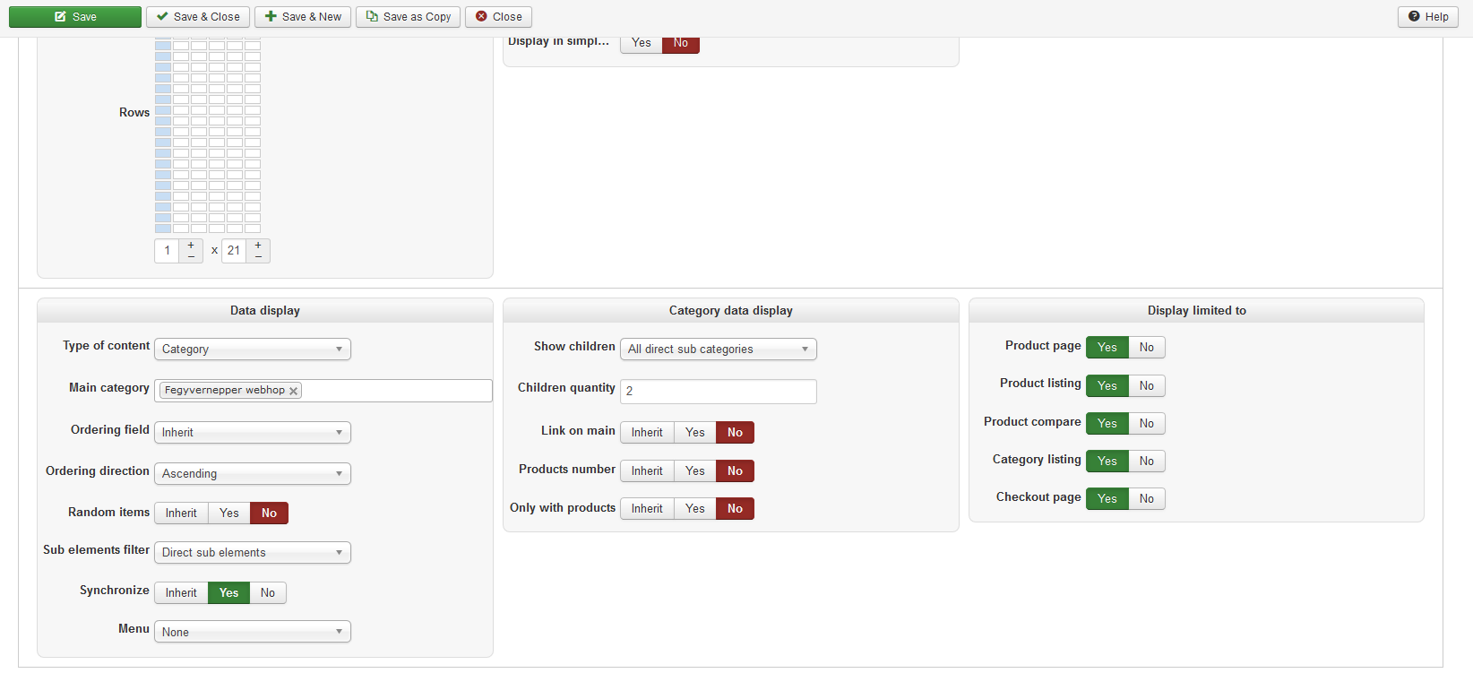

First, you should select a products listing menu item in the "menu" setting of your module. If that doesn't help, then it's probably linked to the settings of that menu item. We would need a screenshot to say more.
  • Posts: 85
9 years 11 months ago #250209
I gladly give a link to the webpage, but at the moment HikaShop is restricted to SuperUsers. I made a screenshots about the module settings.

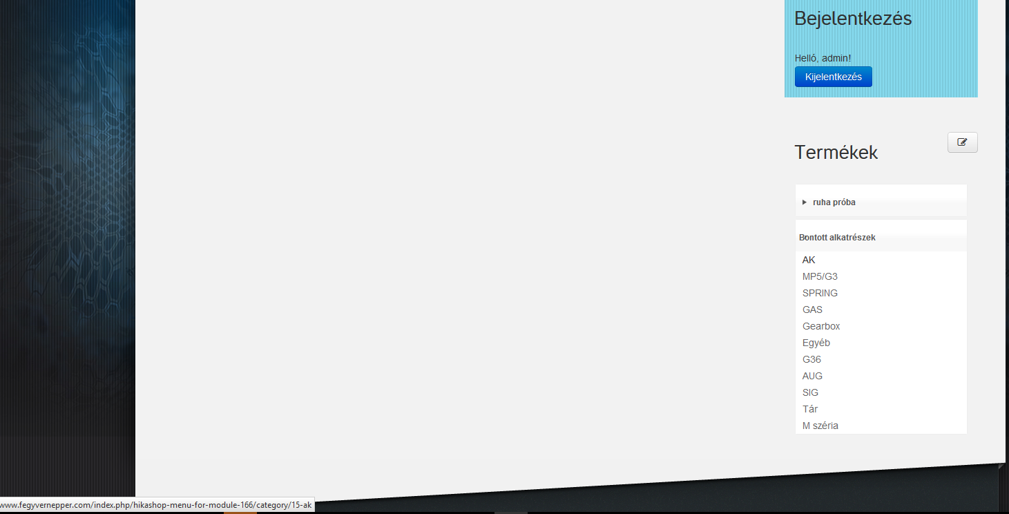

If I click on the sidebar what is use the content module the link is:
www.fegyvernepper.com/index.php/hikashop...e-166/category/15-ak

So as I said, in the "menu" setting of your module, select a category listing menu item.
In your case, you should select the menu item with the alias "hikashop-menu-for-categories-listing"
You'll then get the same link as through your menubar.
