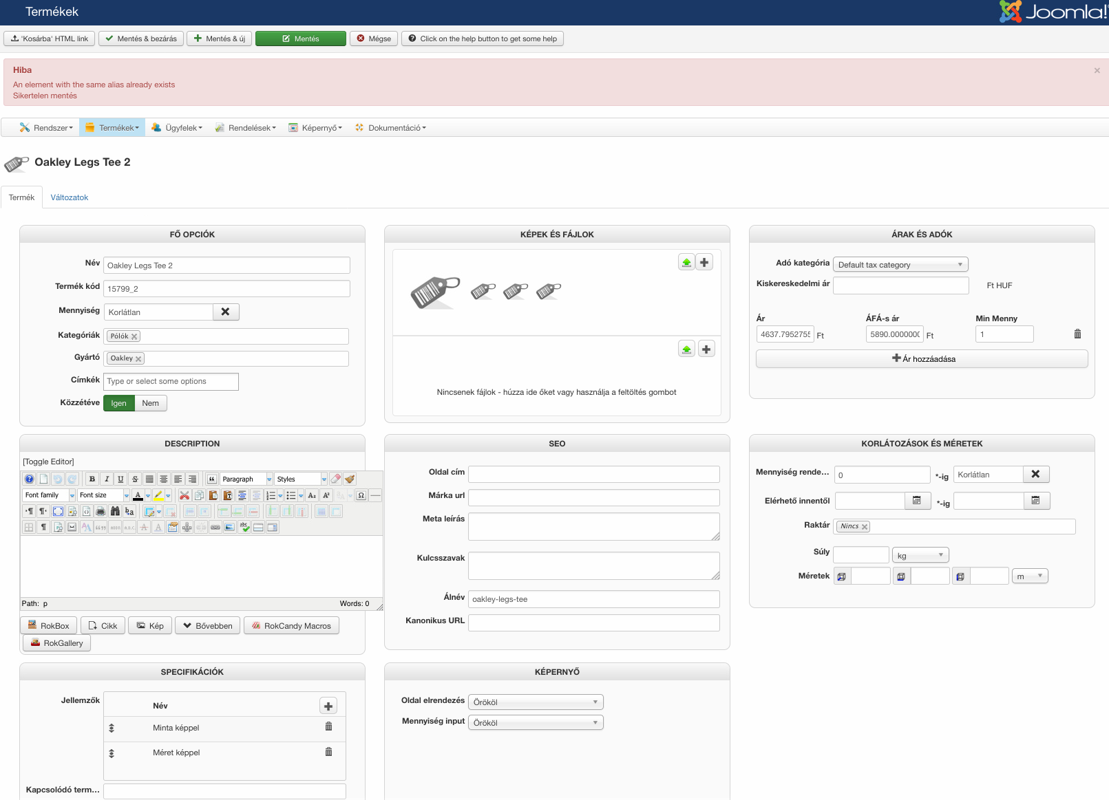

I tried to make a new product, but I get an error message "An element with the same alias already exists". But the strange thing is that I not make any other prduct with the same name or with the same products code.
After this I try to make a new product with "_2" like the attached screenshot, but I get the same error message.
At the moment I'm clueless what I made wrong.

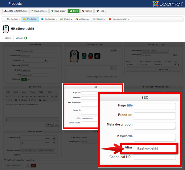

9 years 11 months ago #251355
Yes the alias is needed and so automatically created, BUT you can edit/modify it in order to avoid your issue here, in your product page configuration :
Hope this will help you to solved your issue.
