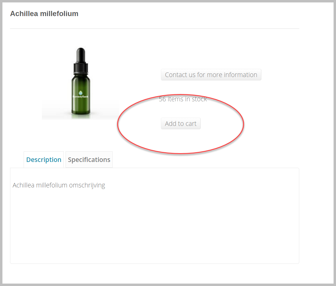

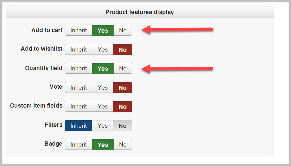

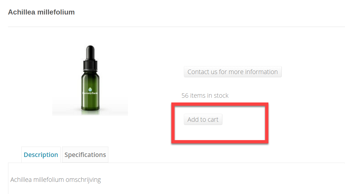

Hi Team,
I want to have the quantity field into the table view. But this is only possible when I turn on the Add to cart button.
But I only want to see the quantity field not the add to cart button. Is this possible?
Kind regards,
Lumiga

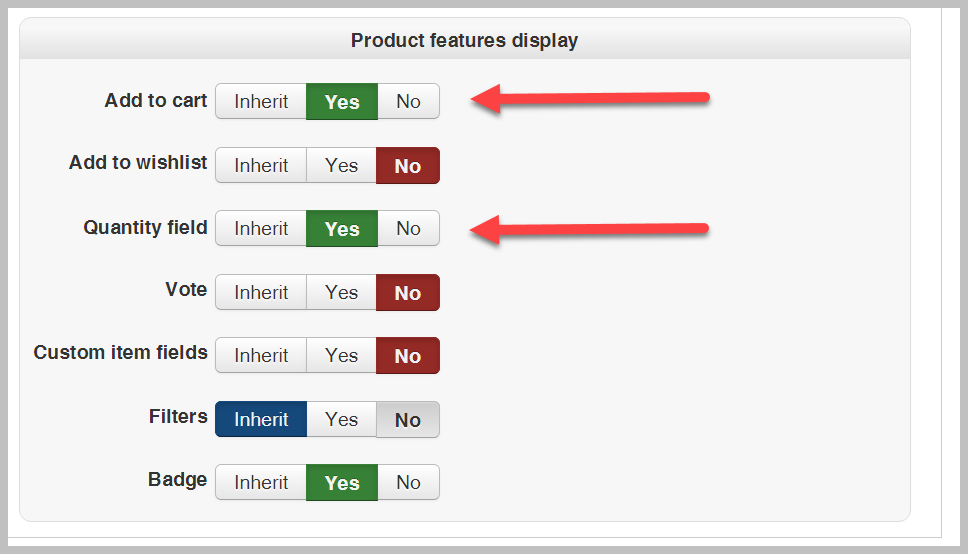

In that case, you want to change the "Display the quantity field on the product page" setting to "global on listing" in the HikaShop configuration.

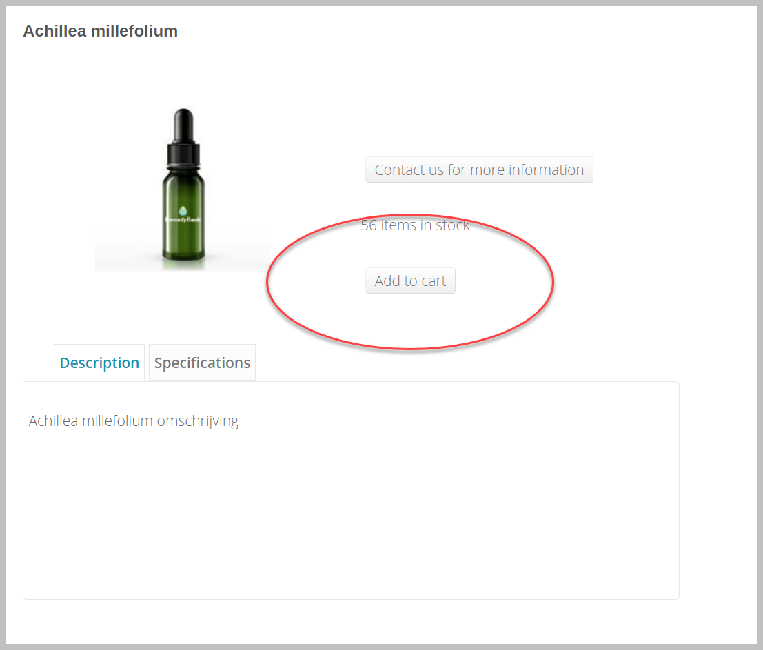

9 years 10 months ago #254182

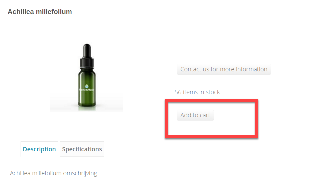

Hi, sorry for my late response, but I didn't get any e-mail from your replay.
But anyway if I set "Display the quantity field on the product page" setting to "global on listing" in the HikaShop configuration. It looks perfect but it also delete the quantity field on the product-page and that is no what we want. Is there any solution for?

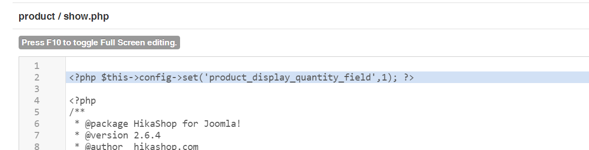

9 years 10 months ago #254192

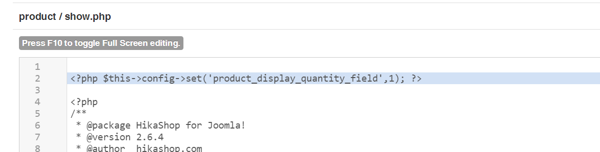

In the "show" file of the view "product", add the code below at the top:
<?php $this->config->set('product_display_quantity_field',1); ?>

9 years 8 months ago #257958
Sorry for my late response.
I add the code to the "show" file of the view "product" but nothing happens.
I cleared the cache but still no quantity filed on the product page.
I put the code over here.
But still no quantity field.

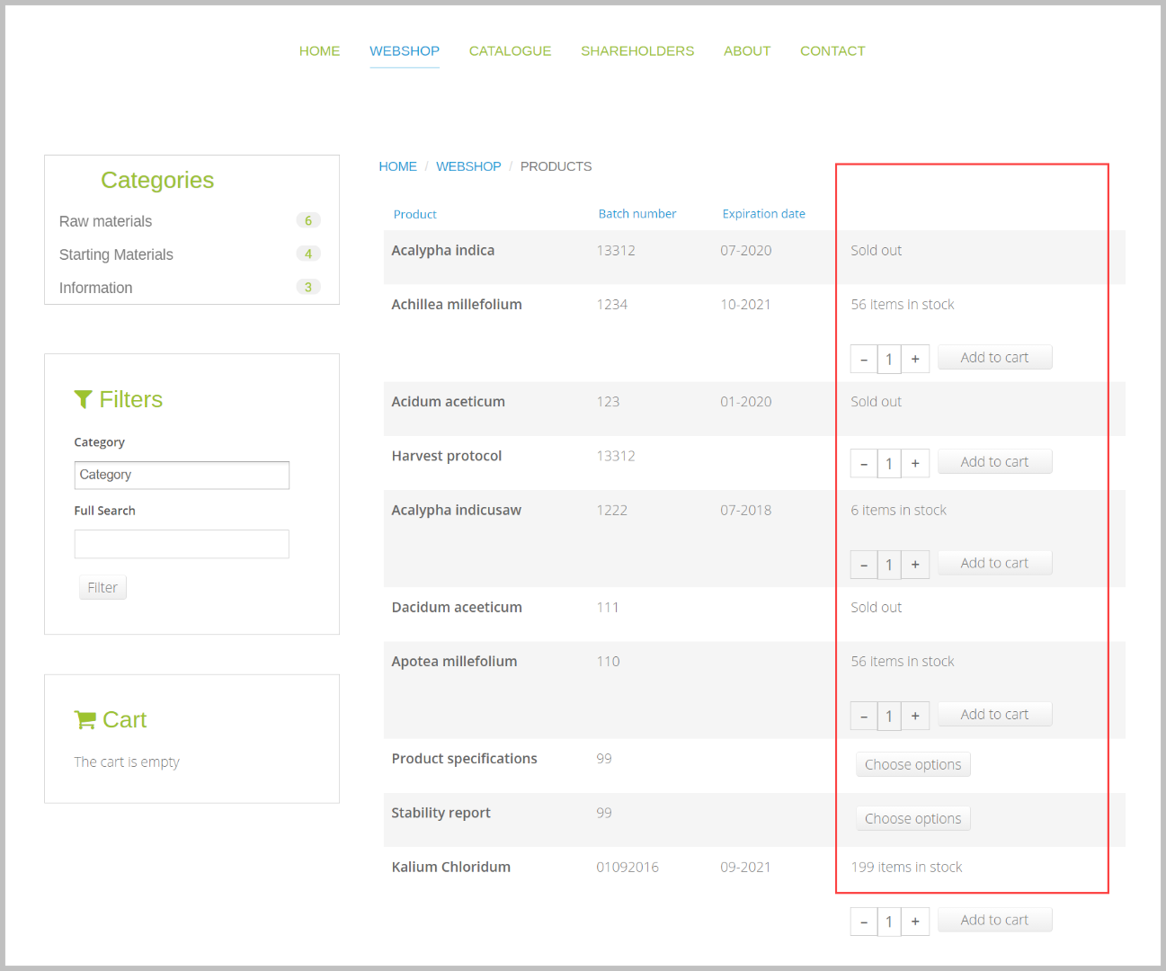

  • Posts: 637
  • Thank you received: 26
9 years 8 months ago #258004
I replaced the code and it works fine now.

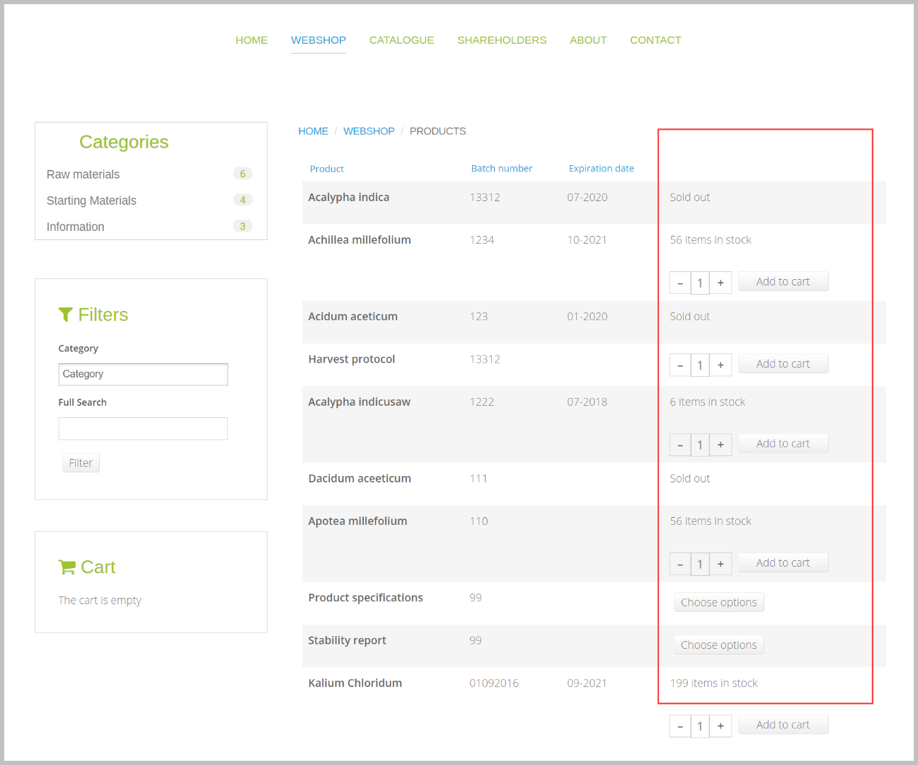

But I realise this is not what we need. We need only to display the stock on the list view.
I'll make a new ticket for that. Because this one is solved. ;-)

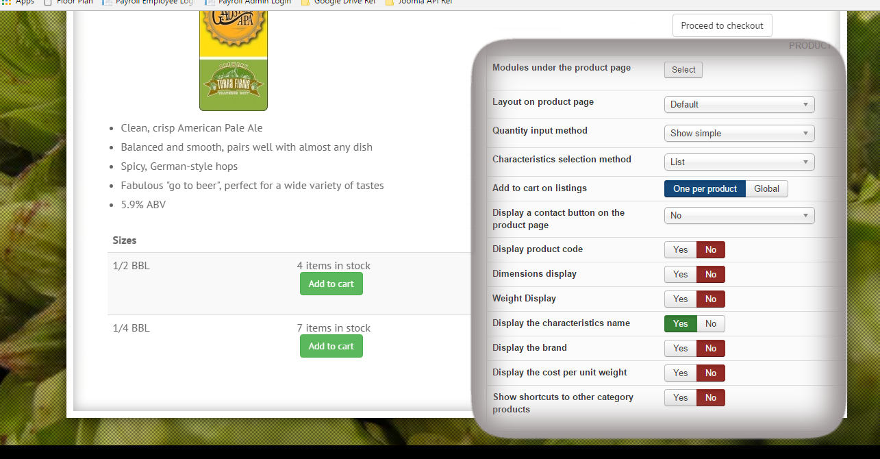

  • Posts: 42
9 years 6 months ago #262973

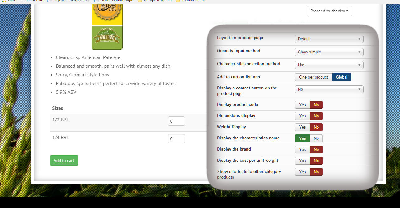

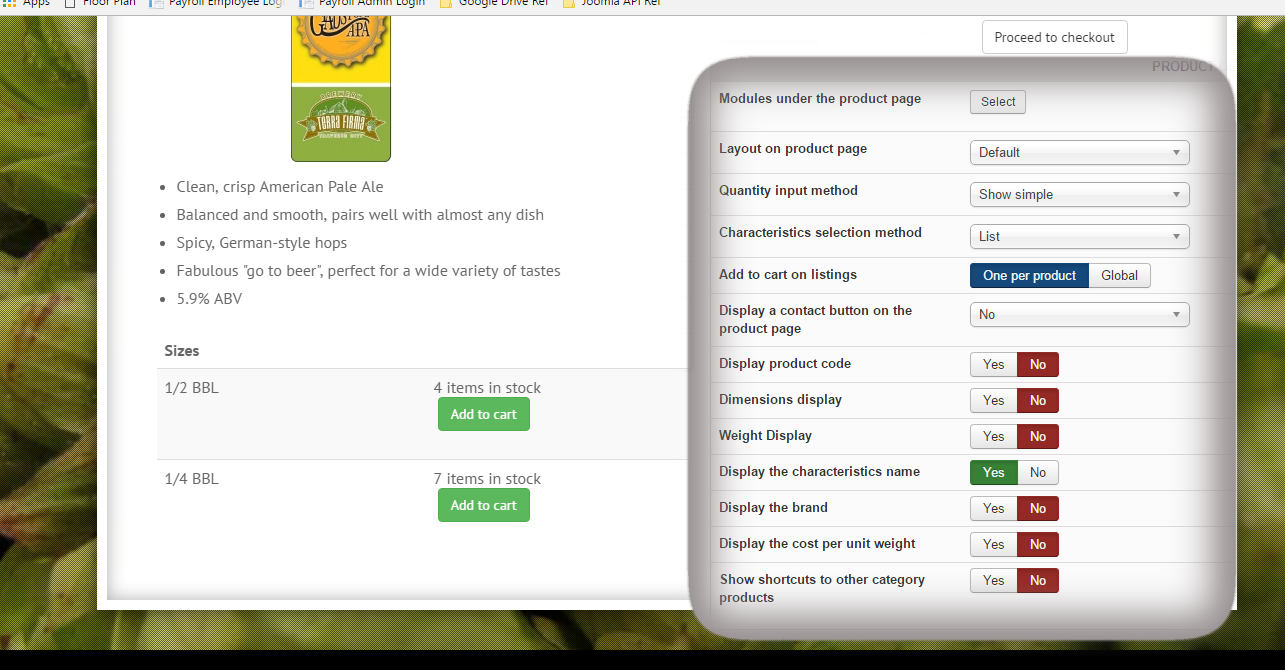

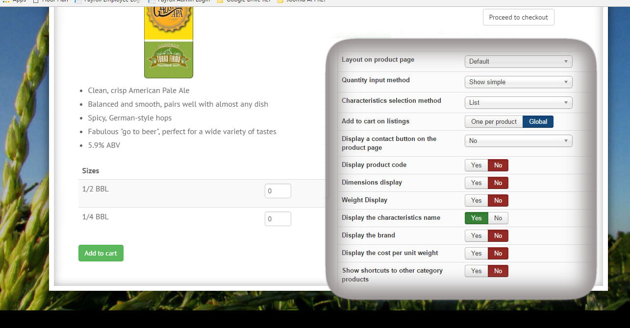

I've been struggling with this same issue (and a few others related to some previous customization) since upgrading from Business 2.6.1 last night. The code overrides detailed in this thread are not currently working for me, but it seems odd that they should be needed. I would expect that the "Show Quantity" configuration should apply regardless of the layout style chosen. It's also puzzling that the ability to input a quantity changes with the One Per Line-vs-Global Add To Cart config option. Am I missing something? (I usually am...)
Matt

9 years 6 months ago #262993
That thread is related to the HikaShop 2.6 and I suppose that you're using HikaShop 3.0 ; which have a refactoring of the cart and checkout system.
And the configuration setting also changed between 2.6.x and 3.0 :
www.hikashop.com/support/documentation/5...html#display_product
