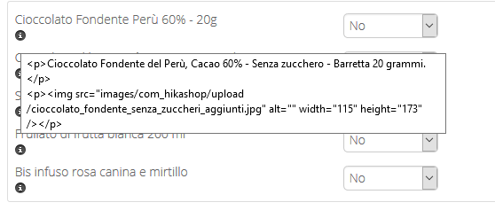

found several discussions about that, but no one leading to a concrete solution for the problem/request.
Product options are additional products added to the main products.
Since the options are real products in HikaShop, they have also their product images.
Actually is not possible to show the image next to the optional product in the "options" list.
But, for each optional product we have the "description" displayed in a tooltip.

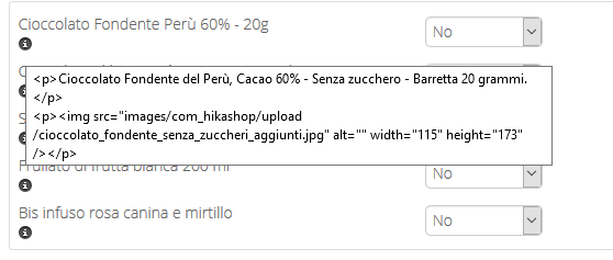

If i add an image in the description field, the image is not displayed.
Tried to look at the code and I found why, working through overrides.
file: option.php line 126
$description = $this->escape(strip_tags(JHTML::_('content.prepare',$optionInfo->product_description)));
Actually, due to the "strips_tags" PHP function, all the HTML tages are stripped and plain text is shown in the tooltip.
If I try to use "allowable_tags" function coupled with strip_tags, in order to allow the image tags, it doesn't work.
If i remove "strips_tags" I see all the HTML code (product name + link to the image). Please remember that the image is included into the Product description (for each additional product). Output in the image attached.
What i'm not able to do is to display the "result" of the HTML code.
If the code will be treated as HTML, the image will be displayed in the tooltip.
Can you please help with this?
Thanks!

  • Posts: 22

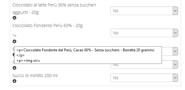

9 years 10 months ago #253863
thank you for your answer.
Unfortunately it doesn't work.
It breaks the HTML tags and it still shows "unexpanded" html tags.
See the image attached.
Can you please provide other suggestions?
  • Posts: 86087
  • Thank you received: 14194
9 years 10 months ago #253895
Then it means that the tooltips system doesn't support HTML tags.
You need to replace the line:
$options='<span class="hikashop_option_info" title="'.$description.'">'.$options.'</span>';
with a tooltip tag. For example: extensions.joomla.org/extension/tooltips

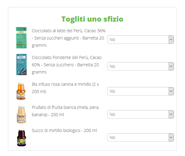

BTW fixed in a different way.
Decided to remove the tooltip and to display the product description (including the image) instead of the product title in the option box.
Changed this line:
$html = '<span class="hikashop_option_name">'.$optionInfo->product_name.$options.'</span></td><td>' . $html;
with:
$html = '<span class="hikashop_option_name">'.$optionInfo->product_description.$options.'</span></td><td>' . $html;
Result attached

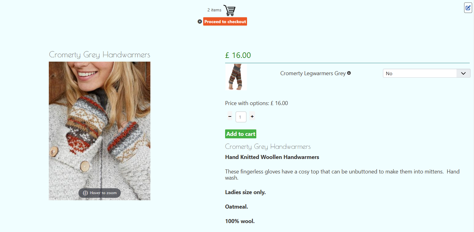

I am trying to replicate what Lippo did, with a thumbnail preceding the product options, I guess the code has changed over the last 8 years as I'm struggling to recreate what Lippo managed?
Any ideas on how to do this now?
Ian

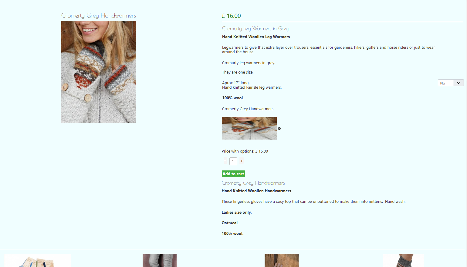

1 year 9 months ago #364537
Unfortunately that isn't working for me, it just adds the current last image from the main product to the last option?
Am I missing some extra code somewhere else?
What I ideally would like is product image then product name and keep the tool tip for the option?
Ian

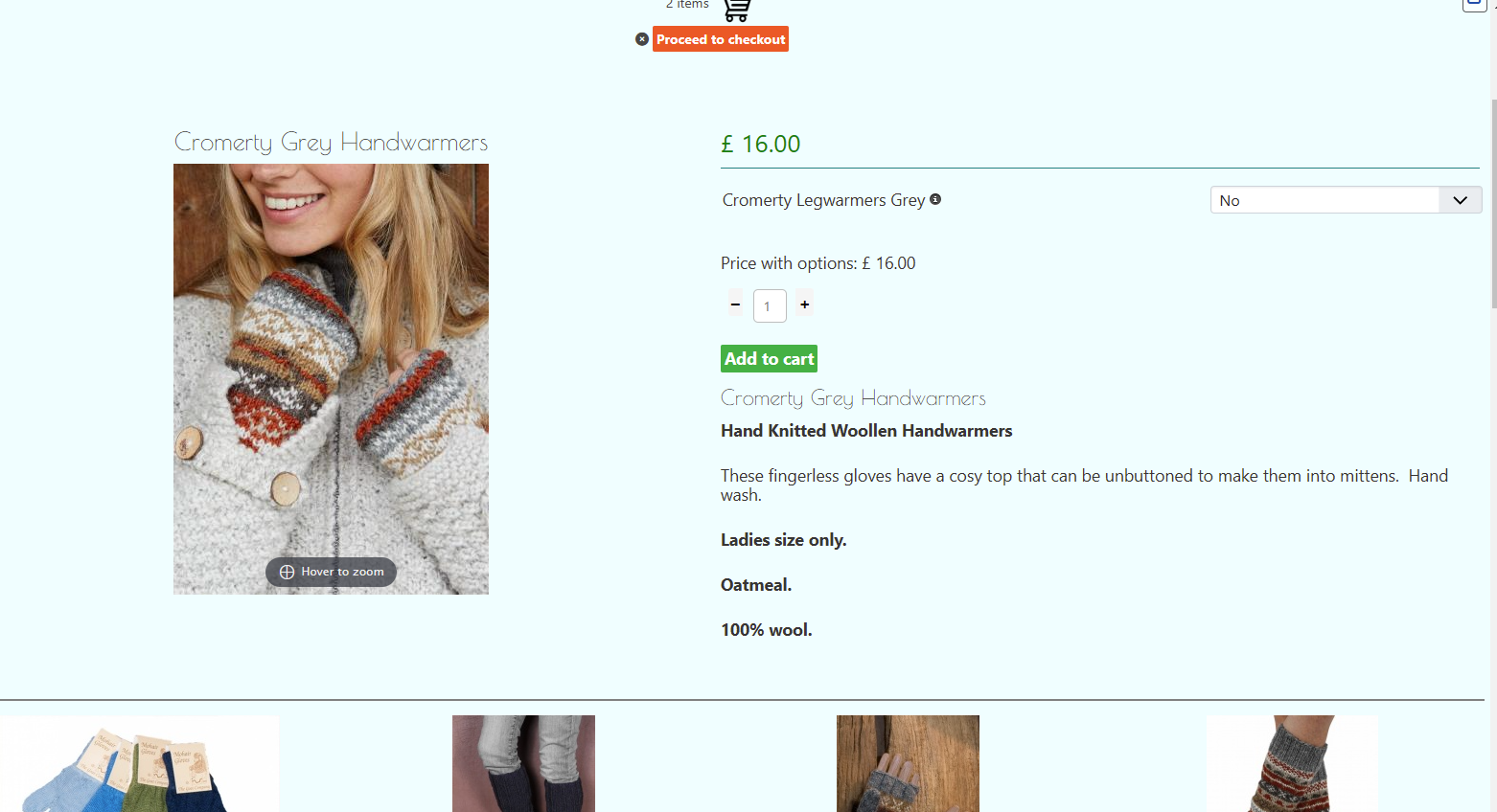

  • Posts: 173
  • Thank you received: 8
  • Hikashop Essential
1 year 9 months ago #364553
I've attached the screen shots, I removed all display modifications before changing the code. I've attached the the before, after and what I'm trying to achieve.
Ian

1 year 9 months ago #364560
So the modification does what it says it does:
It displays the description of the option product. It's just that you have the same description in the description of the option product as the description of the main product.
