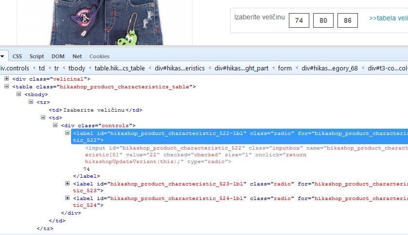

I would like to "simulate" radio buttons to be something like regular buttons (check screenshot). When user click on desired size of cloth it should change color and stay in that color. If user pick other size it ll change color when he click on other button. I managed to change display, but button color changing doesnt work. Button changing color on :hover but not on :checked. What am I doing wrong? :)

the line
.hikashop_product_characteristics_table  label  + input[type=radio]:checked {
has two errors. First of all, the radion button is inside the label element, not a sibling of it, so the + is not correct (you should use the > selector). Secondly and more importantly, the CSS will select the element coming after the + and so your CSS is changing the background colour of the radio button, not the label.
It is a bit unfortunate that the Hikashop code places the input element inside the label, because in CSS it is not possible to style a parent element, so it's not possible to achieve what you want just through CSS.
But there are two possible ways:
1. You could use Javascript to add for example a class to the label when the radio button is checked.
2. You can make a small modification to the Hikashop code for the characteristics to add a span around the label text (the "74" in your image).
In the file /administrator/components/com_hikashop/types/characteristic.php you could change line 212 from
$values[$k]=$value->characteristic_value;
to
$values[$k]='<span>'.$value->characteristic_value.'</span>';
Now you will see a span element around the "74", and you can then easily style it with CSS using the selector
.hikashop_product_characteristics_table input[type=radio]:checked + span {
Note however that this is a modification in a Hikashop core file and it will be undone when you update Hikashop, so it's not ideal. Perhaps we can ask Hikashop to add a span around the label value so it's easier to style it.
