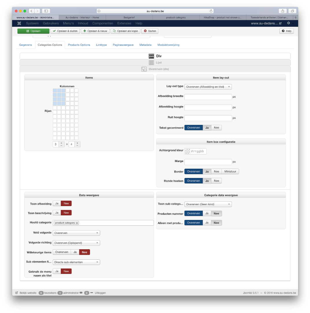

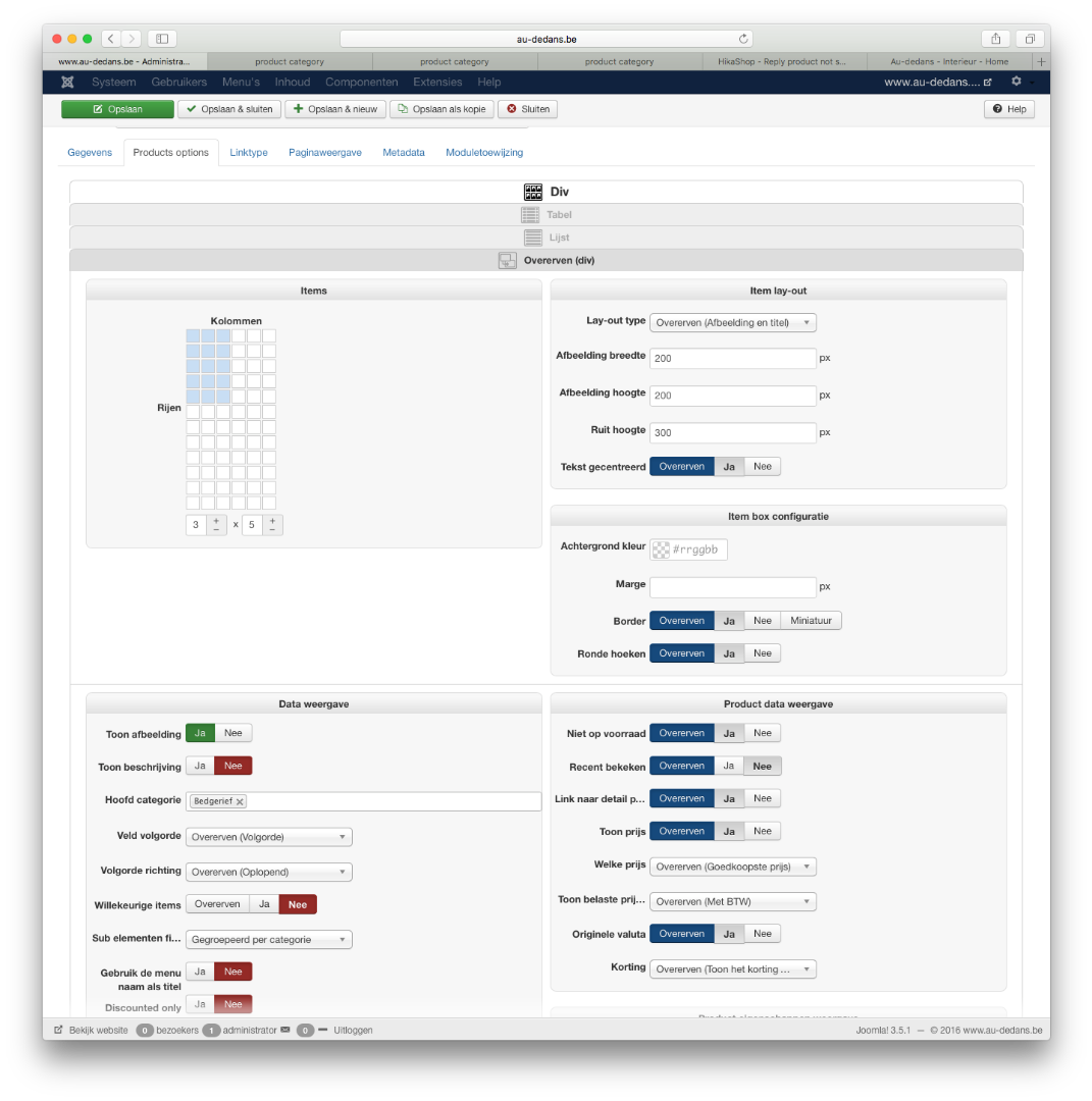

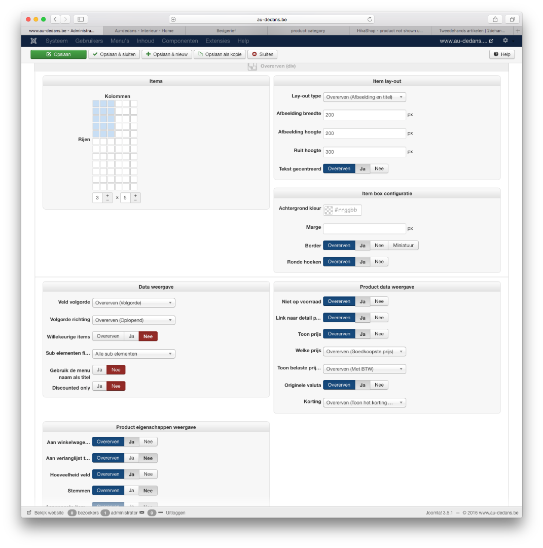

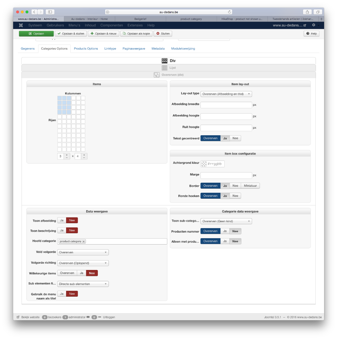

Attached you can find the screenshots of the categorie options and product options page.

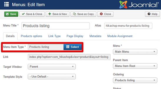

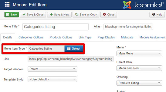

9 years 9 months ago #254822

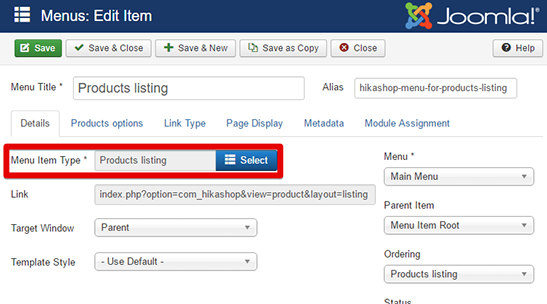

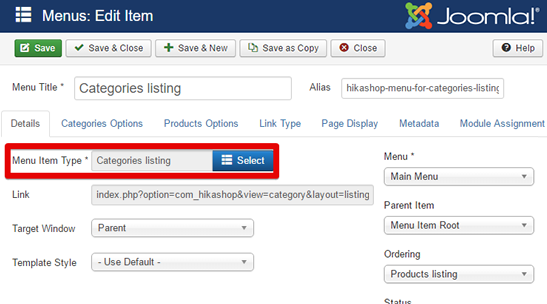

Can you check in your item Menu configuration in Details tab, your Menu Item Type ?
I think your have tihs :
Instead of this :
If yes, can you try to switch for Products listing type and see if that works.
Awaiting news from you.
