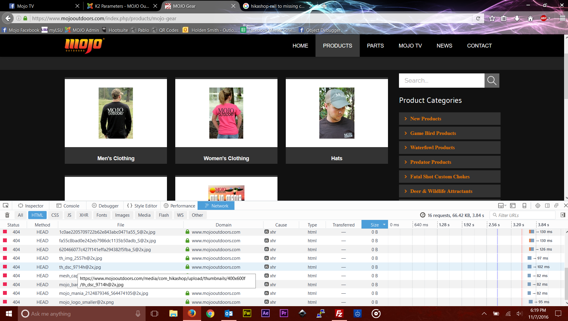

I've recently been having tons of entries in the error log of my site. Most are calls to either images or folders that do not exist. More specifically, my product pages are calling some cache folder that does not exist, creating an entry in the error log (making it impossible to sift through to find major errors). See attached screenshot. Any idea why it would be calling to a folder/image that does not exist, yet still displays the images properly?

HikaShop need to have write access for his upload folder ; it also need the permission to create folders (and these folder should also have write permission).
Otherwise, it won't be able to create the folder and you will have these 404 issues.

755 means that only the user owner of the folders/files is able to write into them. So if the user owner of the folders/files is different from the user used by your Apache (and that's often the case) in order to process the pages of your website, it still won't have write access to them.
If you set the permissions to 777, any user of the web server will be able to write files in that folder and it should prevent these issues.
It might also be possible to change the owner of the files to the user used by Apache and keep the permissions to 755.
But I can't say what's best as I don't know how your web server is configured. That's why Jerome said that it would be best to consult with your hosting company.
