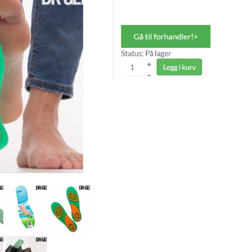

OK this is what my product page on my test-site looks like now.
When I paste a URL in the in the product "brand url" field the button "Gå til forhandler/Go to dealer" links to this url.
But now both button displays. I need the standard "add to cart" button to be HIDDEN when the product "brand url" is filled out
So that only the new button "go to dealer" displays.
NOTE: I know that I can use code to remove the standard "add to cart" button, but I have some products that I sell myself so I need it to display on these products.
Any advice on how two write code like that ?
tnx
How my explenation makes more sense. =)
