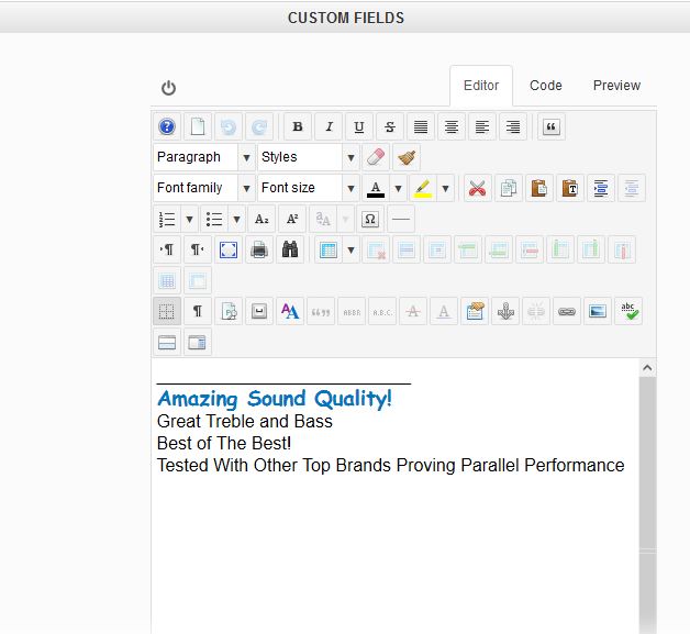

In the past I have used a wysiwyg editor on the product back end page. I was able to add details images, etc. However, I can't remember how I did it. Can you please tell me how to setup the editor so I can add extra details near the pricing like this attached image. I have hikashop bus.

You created a wysiwyg custom field.
www.hikashop.com/support/documentation/1...shop-field-form.html
And the display of the product custom field in your backend will use the editor you have selected in your HikaShop configuration.
www.hikashop.com/support/documentation/5...g.html#advanced_main
